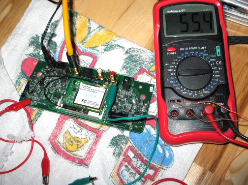

you will need BIG battery for display...55V

Stormsonic you are the man
Thank you so much
Just a questen though
The thumpnail you have attached with the 55V measurement where is that from??
Best regards
kimschips said:The thumpnail you have attached with the 55V measurement where is that from??
55V is power supply for display. There are switchers inside to rise voltage
Red clip is "+" rail, green clip is GND.
oh now I see why it uses 1A in current, who make a display for 55V never seen that before
