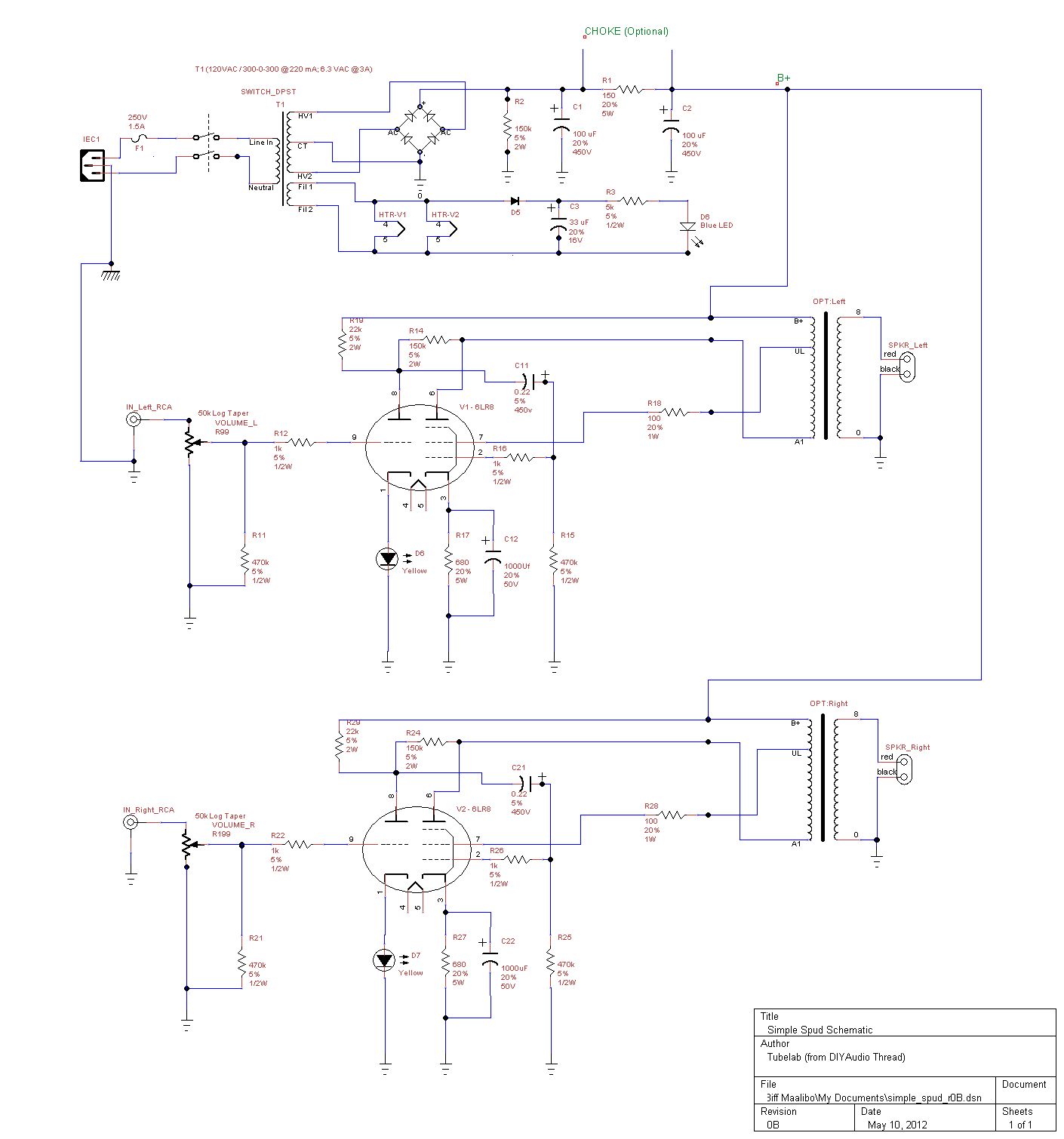

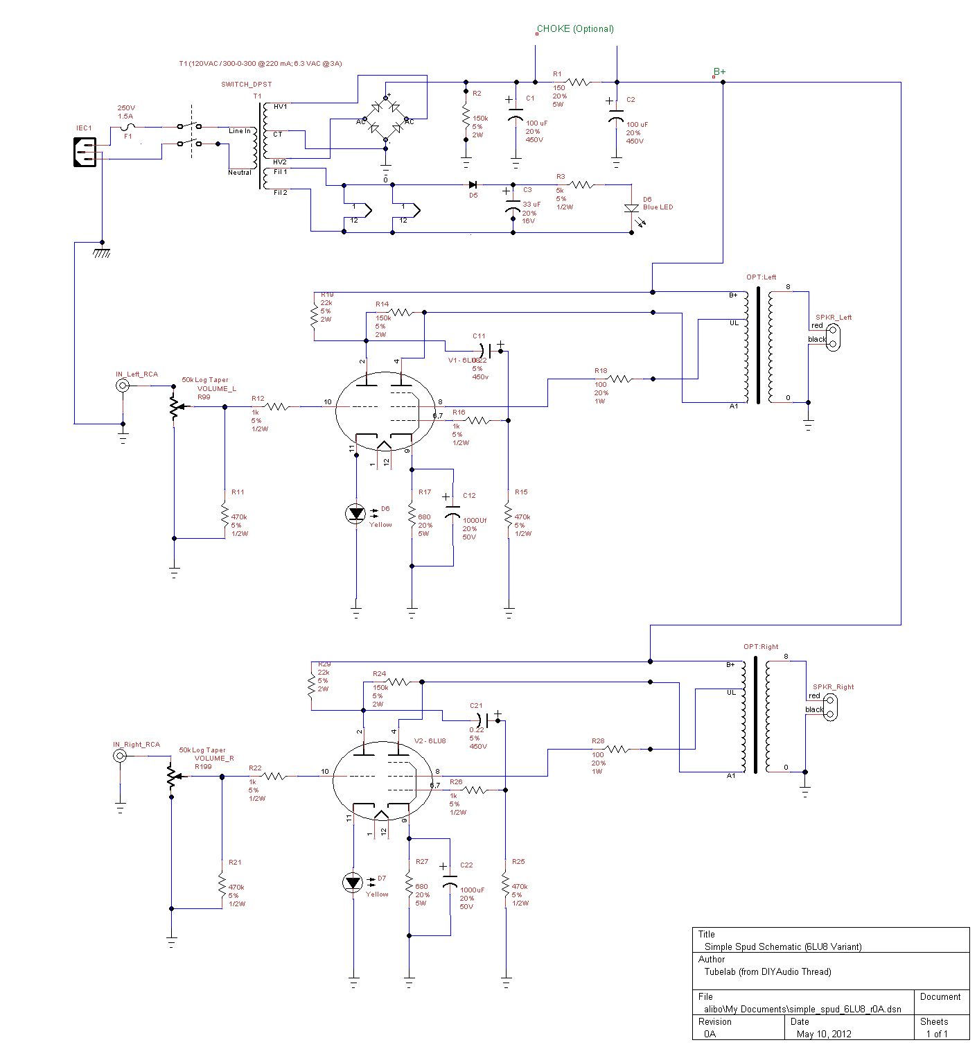

I remain very interested in the Tubelab Spud design page and details and found a couple of earlier threads where Tubelab pursued the design around 2008.
This: http://www.diyaudio.com/forums/tubes-valves/125963-spud-anyone-6.html#post1795149
Post shows a PDF schematic of a SpudSE design...kind of a proof of concept -- i.e. the "furball" and a schematic as an image file.
This: http://www.diyaudio.com/forums/tubes-valves/125963-spud-anyone-3.html#post1557132
Post (replying to one from above proposing an alternate design), gives some of the values used in a prototype SpudSE design.
I have pulled as much information as I am capable from the threads and the Tubelab website photos to produce a TinyCAD schematic (.dsn filetype) and an image export of the schematic in EMF (Windows Enhanced Metafile) in a ZIP file. I am hoping in your copious spare time you surely don't have, you might take a scan of the schematic and see if it matches with what you designed originally.
However, some of your experiments replaced the triode section cathode resistor/cap arrangement for cathode bias with an LED to provide bias and that is shown in some photos and other posts in the thread referenced above.
Values that I could not decipher from your schematic that are needed (using the numbering scheme on the attached CAD file are: C10/C20 & R10/R20; C11/C21 (0.22 uF?); C12/C22 & R17/R27 (450/5W/20%); R16/R26; C1 (4 to 47 uF?)
An Antek toroidal power TFMR (250 to 300 VAC centre tapped) with a 6.3VAC filament winding could work and Edcor OPT's with a 5k primary.
The volume POT I have placed is a dual 50k log taper device as in your SSE design.
Note, I have added a small section on the filament winding for a power pilot light using a blue LED.

I printed out a PDF of the Eagle schematic, and I am looking at my board. I can provide values for the reference designators on my schematic. You will have to cross them over to yours.
R1 150 ohm 5 watt probably not critical (borrowed from SSE) or use a choke
R2 150K 2 watt Bleeder resistor, use whatever you got
C1 100 uF 450 Volt again not critical 47 uF will work
C2 150 uF 450 Volt
D5, D6, D7, D8 1N4007 or whatever your silicon de jour is
R11, R15, R21, R25 470K 1/2 watt lower value reduces gain I used 470K because I have a bunch
R12, R16, R22, R26 1K 1/2 watt yes....because I have a bunch
R10, R20, C10, C20 dunno....I took them out and put LED's in. Tried a bunch while measuring distortion. Thye are both different, but both yellow.
R6, R5 22K 2 Watt
R14, R24 150K 2 watt.
R81, R28 100 ohm 1 watt.
R17, R27 680 ohm 5 watt.
C12, C22 Both are suspiciously missing must have stolen them for another project. I would use around 1000 uF at 50 volts or so. Some people like smaller capacitance values.

R10, R20, C10, C20 dunno....I took them out and put LED's in. Tried a bunch while measuring distortion. They are both different, but both yellow.
Is it fair to conclude then that you were trying to get about a 2.0-2.2V potential drop across the yellow diode and were finding variability in the cathode resistor/capacitor combo?
Is it possible that since the triode section of the 6LR8 is "12AT7-ish" that you used the same values as in the SSE (i.e. C10 1500 uF and R10 220 ohms)?
OK...what would drive lower values as a choice? Remembering that I am just starting my journey into learning about "The Tubes" and other such mysteries.

Updated Schematics
All,
Attached in line are updated schematics for the Spud Amp. These were prepared NOT as a design, but for others to scrutinize.
WARNING: I am very new to the world of tube stuff, so please do not use these as the basis of a point-to-point build at this point. The results could be dangerous if I've missed something fundamental that a more expert person would catch. I'd be remiss to not point this out, as Tubelab himself quite rightly warns about high voltage in these designs. If the attached files have an error in them, proceed at your own risk.
The files attached are JPEGs. The file ending in r0B is the 9-pin compactron 6LR8 version. The other is a version with the pinouts for the 12-pin compactron 6LU8, which I understand is the 12-pin twin of the 6LR8. I have TinyCAD .dsn files available if needed.
Why both 9-pin and 12-pin versions?
Reason? The 9-pin "Novar" (B9E I think) socket in a PC mount form is very hard to find. There appear to be more reliable 12-pin compactron sockets as NOS out there in tubeland.
Others please chime in...I am glad to work on TinyCAD, since I have some time in hand to bash through this. I am still interested in a spud amp with the only silicon being the P/S rectifier. The design is minimalist in both components and feedback techniques (UL mode only in use), which I prefer as a philosophy.
The push-pull movement, while compelling from a power and distortion perspective, does not interest me. I am looking for SE in a small package to drive efficient loudspeakers in a small room from a couple of nice, clean sources. The SimpleSpud certainly has my hopes it can become a PCB at some point. I will contribute, as I can, to assist.
~Squiff

C2 in both schematics should be 150 uF, rather than 100.
It probably won't matter much, but I bought a hundred 150 uF's so that's what I use for everything.
