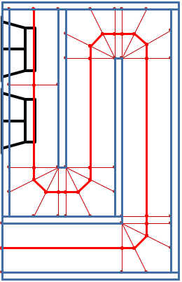

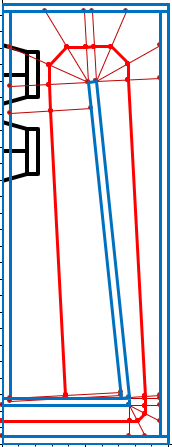

1) First I built the Martinssen TPAM10HTL
2) Then I built a pair of the 18hz tuned Snider LAB12 loaded with a variety of Alpine car audio drivers.

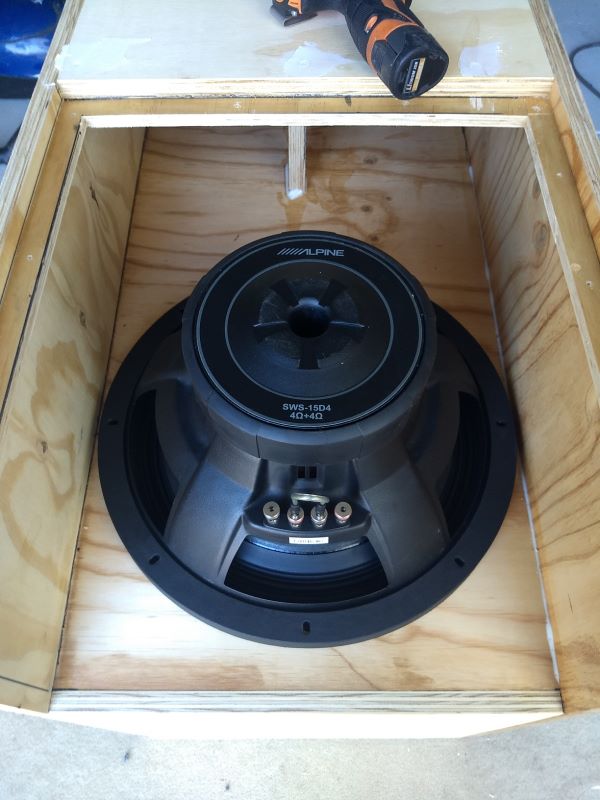

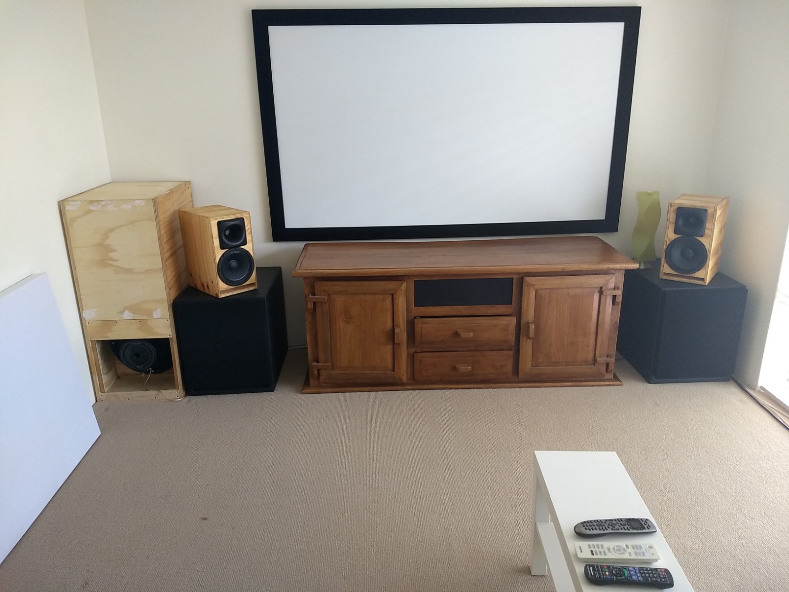

3) Finally, I recently built a 266 liter Boxplan MTH tuned to about 24hz. I call this my BP-MTH-266.
So my application is HT and music chasing max extension, not outdoor performances where you'd want max SPL in your chosen passband.

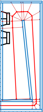

In trying to understand which of the Boxplans could get me the lowest tune for a given exterior size I tried each Boxplan fold with my target 266 liter box (110H, 45W, 65D) that I could accommodate at the back of my lounge. Effectively I was trying to find which TH fold was most efficient at packing in the longest path in pursuit of the lowest tune.
What I found is that the MTH was that fold - mind you a few more Boxplans have appeared since that time which I've not tried.

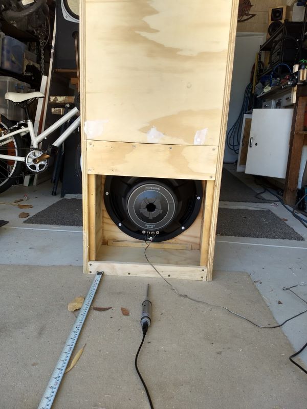

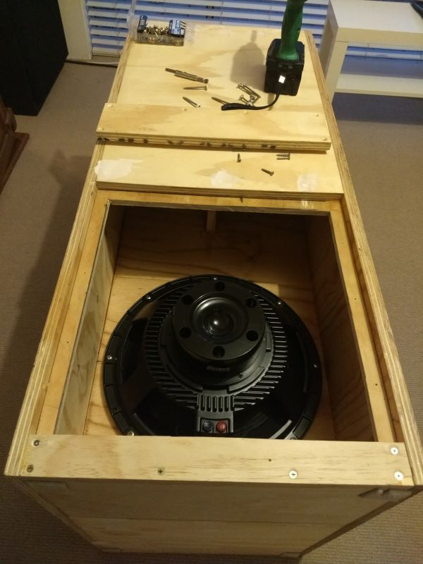

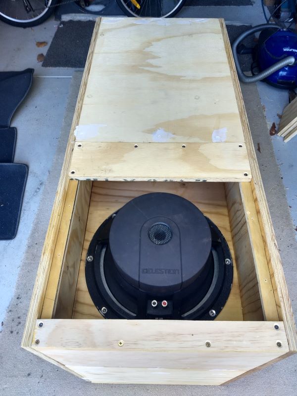

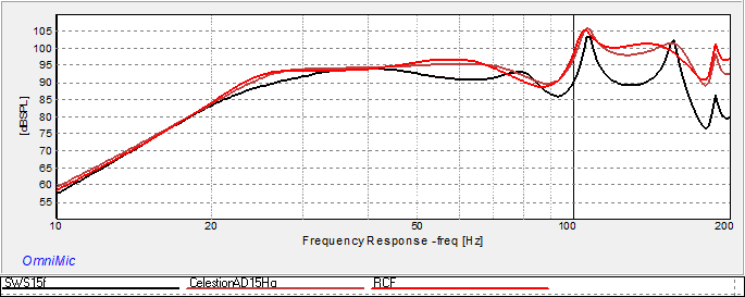

Regarding drivers, my current BP-MTH-266 (and all TH's I've built) seems incredibly sympathetic to a very wide range of drivers. To be precise I've modelled and measured three drivers:
a) Alpine SWS-15D4
b) Celestion AD15H; and
c) RCF LF15N451
Here's a chart of the three drivers in this enclosure:
attachment.php
The take away from this variety is that the box is in charge of the passband.
The drivers efficiency, Xmax and power handing will determine how loud you can go. The Alpine beats the Celestion because even tho it is considerably less efficient it has a ton of Xmax and gets a fair bit louder as a consequence. I've not had a chance to take the BP-MTH-266 with the RCF LF15N451 loaded outside so that I can belt on it to see how loud it can play before it starts making noises, but with 64mm Xlim I'm hoping it can take a heap. :whip:

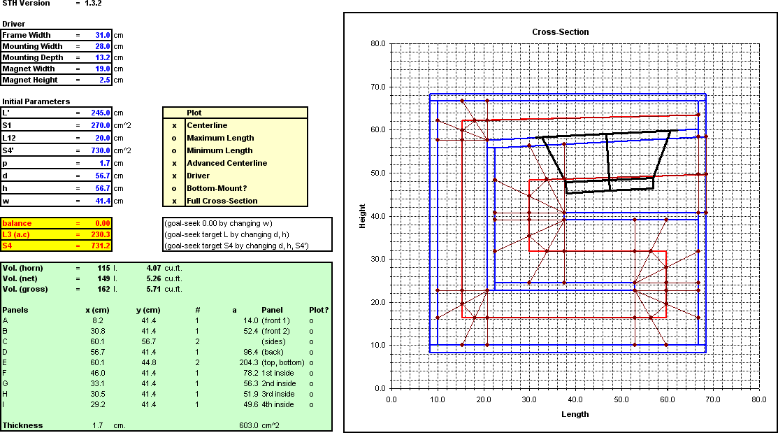

Regarding the Boxplan .xls tools - these are by far the easiest build. The tools' graphic for the enclosure gives very precise path coordinates which makes cutting and laying out the horn path a breeze, it was a revelation for me how much easier Brian's tools make the build process.
I have really enjoyed designing, building and listening to my tapped horns. I highly recommend you learn HornResp - Brian's DIYSubwoofers steps you through how to model each kind of subwoofer alignment using HornResp on his site.
Then all you need to decide is the external dimensions of your enclosure, add this to your chosen Boxplan, choose a driver and load up its specs then import to HornResp to see your passband. Smaller box for a higher tune, larger box for a lower tune. Easy as!

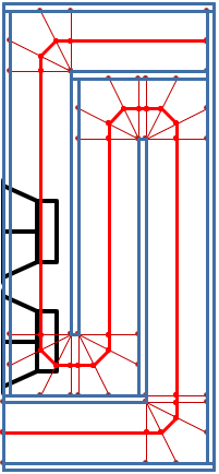

Just a few minor updates...
1. I've included the ability to model the use of either one or two drivers in some of the BOXPLAN workbooks (BOXPLAN-TL1, BOXPLAN-TL2 and BOXPLAN-MTL3). I aim to extend that ability to some of the other workbooks over the next few weeks, if the box layout suggests that more than one driver can be easily supported. Note that this isn't fully supported by Hornresp yet - the initial import of the Hornresp file does work, but if you subsequently change the number of drivers in the BOXPLAN workbook, do an export and then press F6 in Hornresp to quickly update the sim, it won't pick up the change in the number of drivers used. David says this should be addressed in the next version of Hornresp.
2. I've included a feature that I call "A good start...?" with some of the workbooks (just BOXPLAN-TL1 and BOXPLAN-TL2 for now). Selecting that option gives a "starter" design, based on the driver's t/s parameters. Note I said STARTER design. You should examine that design in Hornresp and adjust it accordingly to get the best results.
