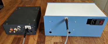

Cool, got any pictures of how you did it?
My friend, a Buffalo DAC aficionado, is the one who built it. He also chipped in the IVY and some other parts. Using 4-pin mini DIN plugs for the power cord was a really nice touch, but they are turned out to be a real pain for him to solder and assemble. Full size DIN plugs may be a better choice. In any case, it's great to have the cable be detachable, unlike the umbilical between my AI preamp's power supply and main chassis.
It's time to block some of the holes in the power supply case, and I may move the dac / line stage to a nicer case at some point. But the results have been great. I've always been a vinyl listener, but this DAC really changed my opinion of digital front ends.
