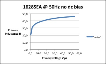

You are correct... I did a quick measurement using a sig gen and scope to directly measure current and voltage:
At small signal (350mV, 100uA, 50Hz) I get correlation with the inductance meter (approx 11.5H)
At 2.8V pk 400uA I get 25H
At 6.4V pk 700uA I get 32H
I still need to understand what is going on though...

Hammond measurements

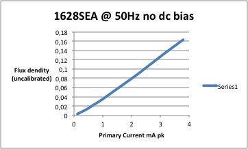

As a follow-up I measured the Hammond OPT's a bit more, and included a BH curve showing the lower amplitude slope change. (This is at very low levels only due to the air-gapped core) so is actually pretty linear.

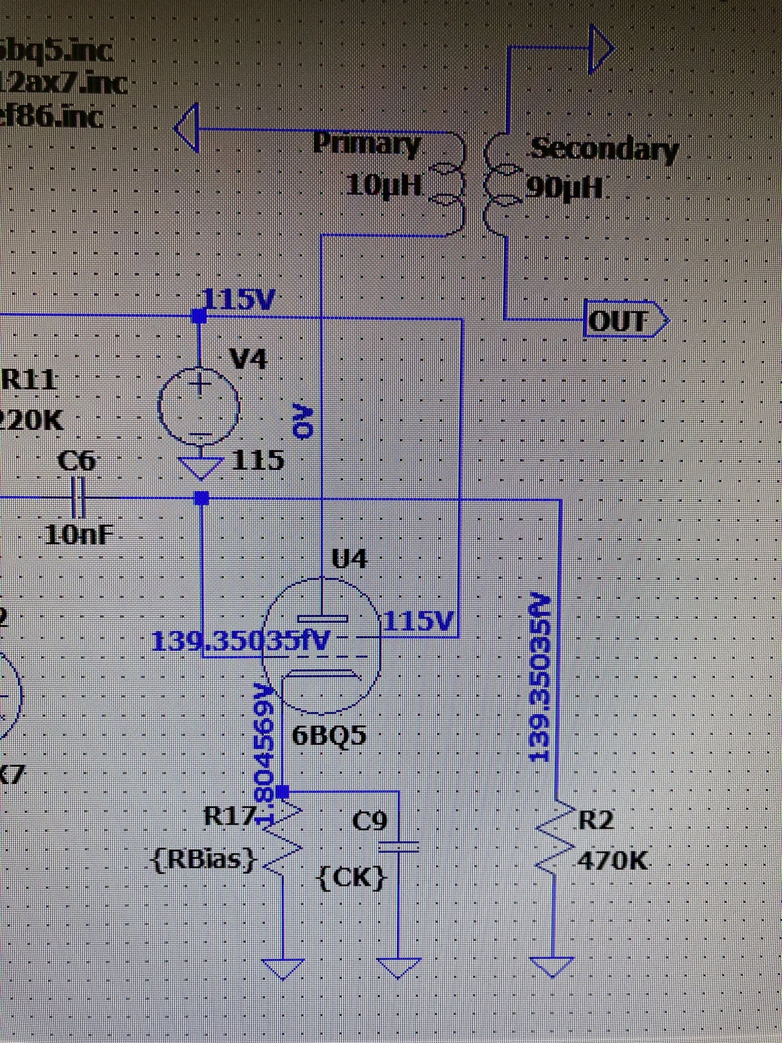

I have a schematic that uses a scavenged phonograph transformer, only know the resistances. I used the second method and getting no voltage out, is there a bug in the program? Did try different ratios and distances between, plus grounding various ways to no avail.
