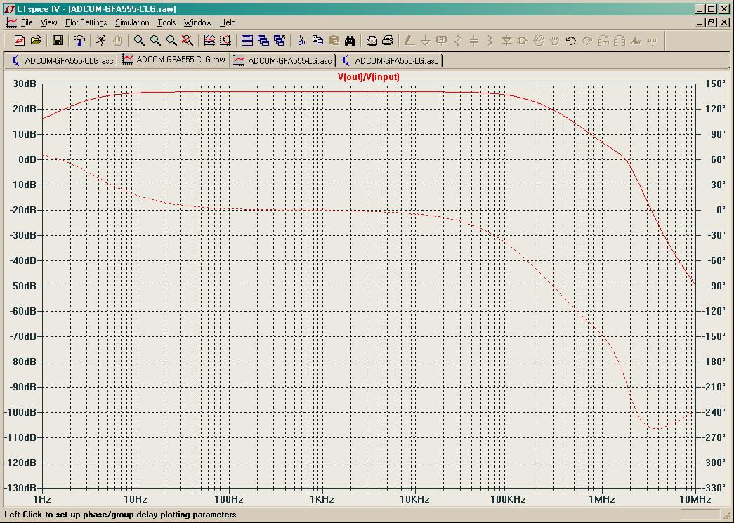

Spice Simulation of Adcom GFA-555
Modified compensation> 1 added part & 2 value changes
drivers miller caps value increased to tame HF
added a zero to extend PM
see file
You moved the zero gain crossover point up significantly, and you
need to consider that the caps on the drivers significantly load the
VAS at HF. I expect that my mods will not alter the slew rate, or
component sensitivity, but do significantly improve stability.

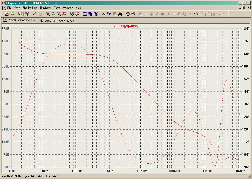

Rather than just adding some more poles and zeros. I thought it makes sense to find the cause of some rapid phase shifts giving some concern regarding PM and GM.
I started looking at stages individually to find the source of parasitic poles at 2-3 MHz. I looked at the output buffer stage transfer function and as sort of a test, prematurely increased the Cm value of caps at the driver.
This was an intermediate and not a suggested compensation fix. Another test was to change the driver transistor to a perhaps lower ft and power and seemed to fix the under damped resonance problem. that's all.

There is a scheme of Nested Miller Compensation with a an added Nulling Resistor to eliminate a zero or to move it higher. But not to perform pole zero cancellation. If it gives a +/- 50% headroom of varying the resistor's value without inflicting stability seriously then it works like NMCNR.
But now I look to your .asc and I see no nulling resistor and no take off from a step circuit's middle point to the second cap, so its just you manipulated the Nested Miller Compensation values to experimentally maybe tune better for stages and models. OK, got it. Thanks for expanding on the reasoning.
OK I tried new driver models using mje340 npn, and mje350 pnp, obviously not suitable drop-in repl. but solved the peak resonance with standard compensation ie 68 pF , and reduced lead compensation, looks promising. Conclusion>The BJT models make a significant difference in Phase Margin.

Even LTSpice works very well once the models are sorted out.
I think for example that my AC stability analysis here is probably
in the ball park.
