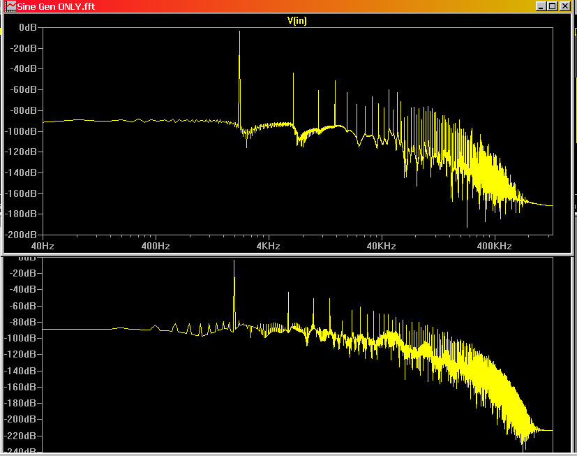

Here's a really odd FFT result from LT's spice... the source is simply the internal virtual AC generator with a 100k load! I'm baffled as to why it should show any harmonics whatsover??
One is a 2000Hz source, the other is a 2200 Hz. source, the 1kHz source looks far worse!

I have been fighting with the FFT problem as well recently. Seemed every schematic had different harmonics on it's sine wave generators and is very sensitive to stop time and maximum time step (in the edit simulation command dialog box).
Now turning off compression, using a stop time of 100ms and a time step of 0.5uS I can get a plain generator with those spikes down 140db.
Trouble is this puts up the time it takes for simulation to complete which on my old 266MHz machine can be considerable.

Fyi, the problem turned out to be the stepsize in .Tran and the compression "option."
