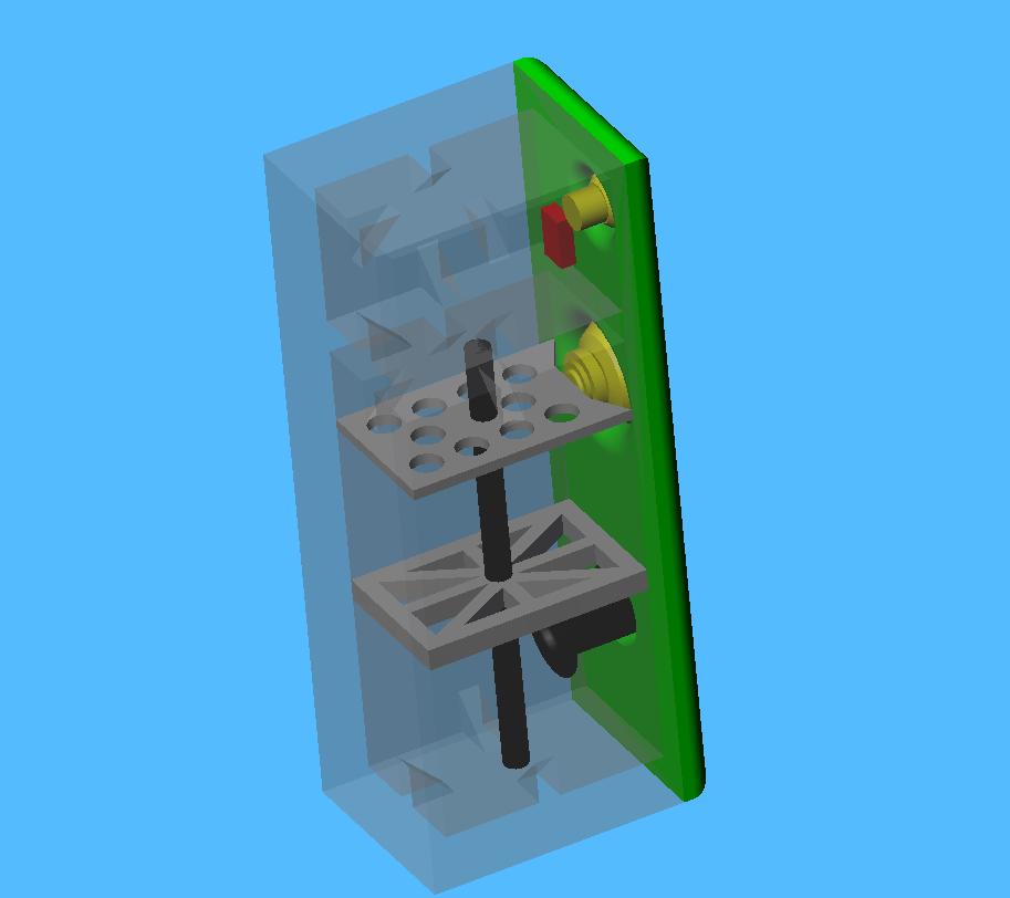

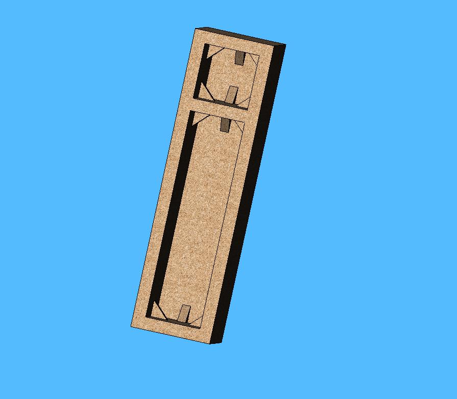

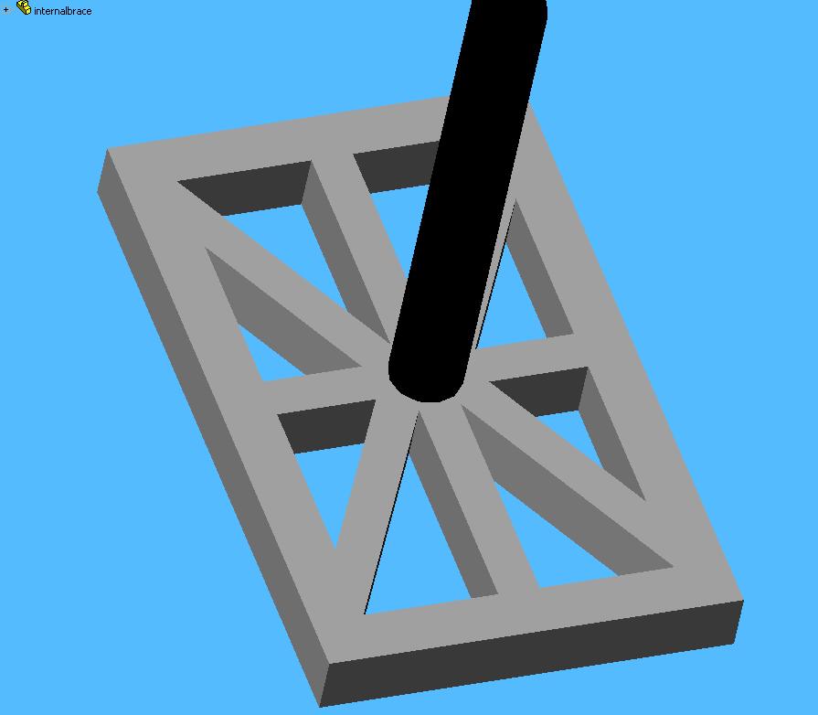

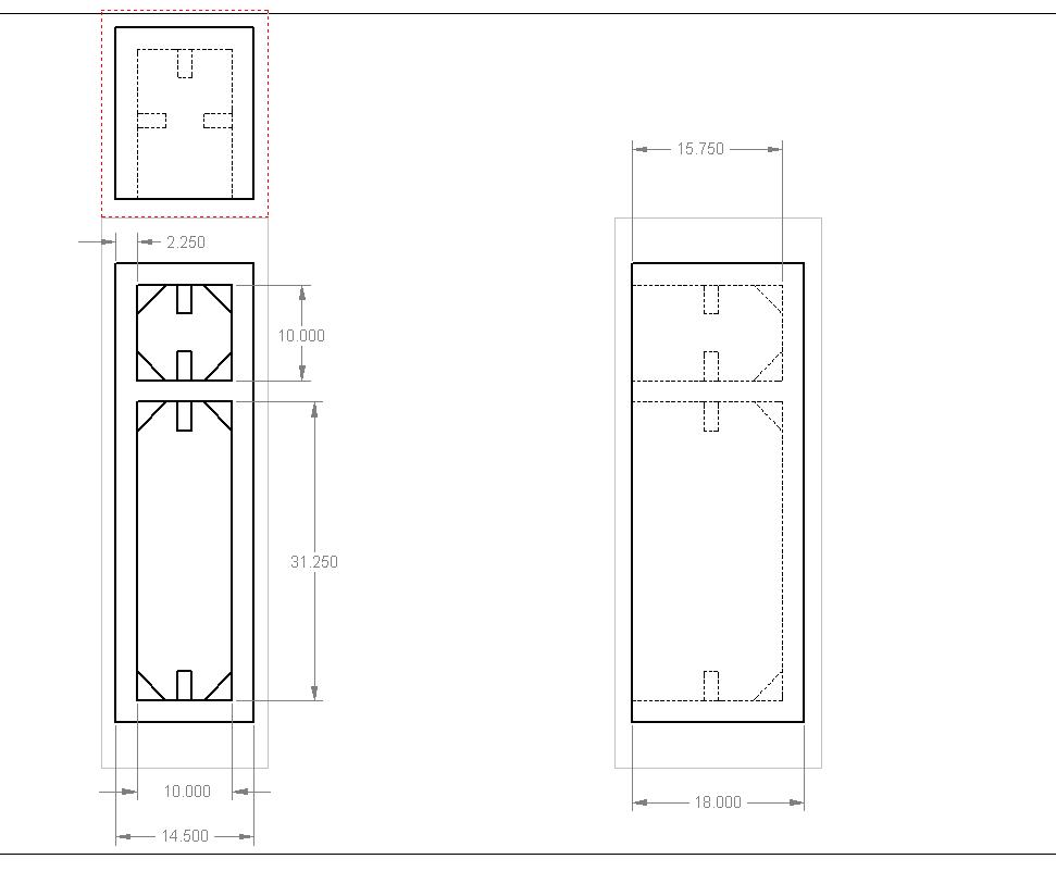

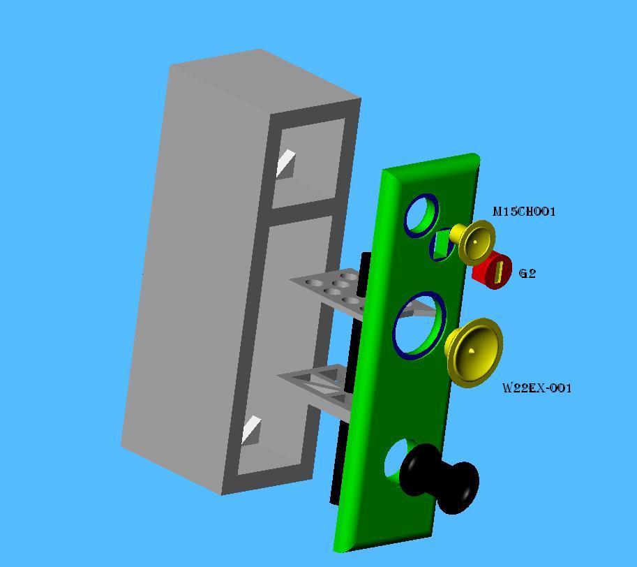

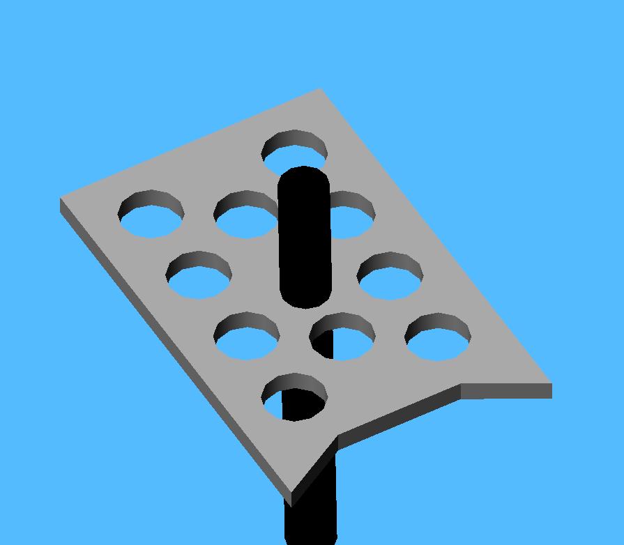

Nice drawings.
Those cabinets with drivers are going to be about 100lbs each.
Unless you enjoy that much MDF dust, you could probably use one layer of MDF and maybe an extra brace. Good plywood like baltic birch might make better braces than MDF.
The baffle would probably be fine with just two layers.
If you use a thick baffle, you'll want to chamfer or roundover the back edge of the woofer and midrange cutouts so they're not choked.
Not saying that you shouldn't build a 100lb cabinet simply for the joy of overbuilding but you are probably dealing with the law of diminishing returns.
You might check out North Creek Music Systems and how they design their cabinets. You can glean some good info from their site but they also sell a guide for $5.
How did you determine your driver locations? FRD Consortium has some good tools that might help you determine driver locations.
for driver location i just made it up to be truthful, i have ordered several books on building speakers and havnt got any yet, and ive a little impatient
as for letting the drivers breath i rounded the edges of the inside with 1.5 inch radius for the 8inch and 1 inch for the mid 5 inch.

I have added a pic of the back of the baffle with the cabinet semi-transparent to see the back and how the braces interact there.
