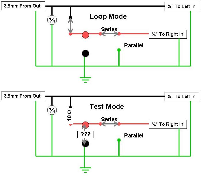

Okay, here's the raw schematic of the jig. I whipped it together pretty fast, so I apologize for any mislabeling or errors.
bLack is Left, Red is Right, and Green is Ground
Input is a stereo 3.5mm, outputs are 1/4" unbalanced T-S.

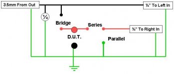

Here are two examples of modes. I haven't tried them yet, but I used Eric's and Claudio's schematics in my planning so I hope this is accurate.
I do not show anything in the way of using the voltage divider or the bypass output (1/4" T-S jack), which I guess could also be used as an input if necessary.
Edit: clarification, jacks are defined relative to the sound card. So Out actually means Sound Card Out not jig output. It should be clear from the drawing, but I don't want to confuse anyone stumbling upon this.

Okay, I've spent the better part of the evening calibrating this thing, and I'm at a loss.
I can get the amplifier pulse and channel separation calibrations done. It gives me reasonable values for soundcard impedance and capacitance. And it calibrates the jig to almost exactly the reference resistor value.
So all that being said, it can't measure components accurately at all.
It identifies resistors and inductors as capacitors, and for capacitors, it doesn't come close to getting the value right. It seems to have repeatability, though.
I've tried different sampling rates and multiple MLS cycles for a better signal to noise measurement. Still nothing.
The jig checks out, though.
My friend seems to thing the M-Audio MobilePre might have a capacitive coupling on the input stage to take off the phantom power from the mic. This capacitor might be screwing up the measurements. I've searched for Speaker Workshop and MobilePre and I seem to be the first person trying this.
A lot of people have been trying SoundEasy and the MobilePre with mixed results and this might be why.
Ugh, if I can't get a resistor to measure right, there's no way I'll believe an impedance plot for a driver that I measure.
Advice appreciated. Until then I'll keep cranking at it.

Still not working, but I think I know why. I put the 1k resistors in the wrong part of the circuit. I put them in the end of the circuit, by the line-in cables to the sound card. Since I was just trying to use one resistor per channel and not a true voltage divider, this essentially did nothing.
There was still the low impedance loop at the "front" or Line-Out side of the jig that was over-taxing the sound card and resulting in no output.
I need to move the 1k resistor there to show the SC output a much higher load, then I can get accurate readings off of the jig.
DOH! DOH! DOH!
If I'd drawn the circuit diagram first instead of just building it I would have caught the error. Instead, another 2 hours spent stripping wires and screwing things down to the terminal strip :)
