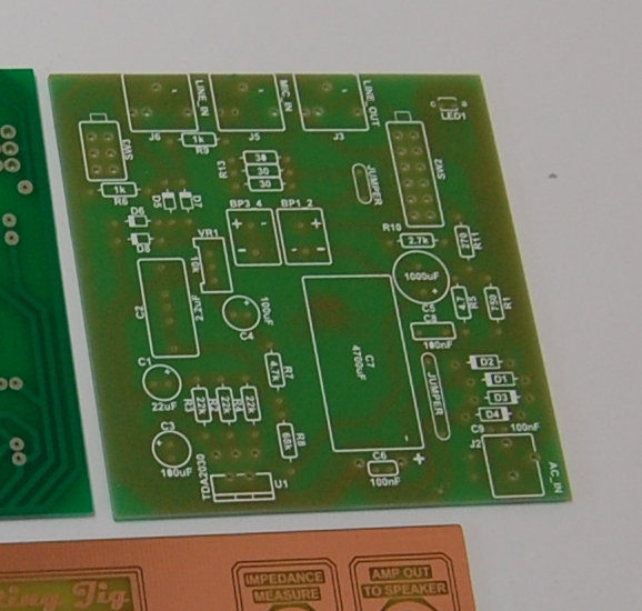

Jumpers
John,
Just finished building my Jig, great quality. You might want to include the jumpers in your instructions, get a sense that some of those who build this may be newbies and miss the need for them. I read your assembly instructions and did not find a refernce to them.
Mike
Disabled Account
Joined 2007
Hi Mike,
Yes, I thought of that after and I've been meaning to get a mod to insert a post in there covering it but I've just been too busy.
The new boards have "jumper" printed on in the silkscreen:
It's hard to think of everything - we have a "work in progress" here. :)

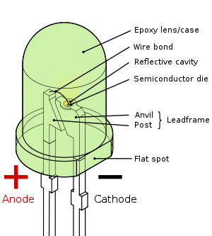

Can someone confirm the orientation of the ON LED? I think the LED flat goes to SW2 side and the longer leg faces towards the outside of the PCB.
Thanks for all your efforts.
I put the LED flat side [cathode, short lead, or negative] facing to the inner portion of the panel and the other lead [anode, long lead, positive] to the outside of the front panel. I could well be very wrong on this.
I do recall being confused because of trace route FROM LED through R1, through jumper and over to negative side of 4700uf capacitor.
The other trace route comes direct from diodes.
The confusing part is I'm more familiar with the resistor in series on the power supply side, and now it's been awhile since I assembled it so it's not that fresh on the brain.
I haven't run any power through it yet, though...
I think I based my logic for install on this diagram:
