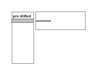

There is nothing wrong with just screwing and glewing in a project like this, if you use 25mm MDF, you can get away with virtually no internal bracing.
As for the joins, the image attached should give you an idea, be sure to pre drill the MDF, and use long flat head screws, at Bunnings you should be able to get the special MDF ones, say about 90mm long, 3 or 4 screws a side!
So get the pieces cut normally, dont forget about the extra cuts for the binding posts, port etc.

Thanks for the diagram, I would just like to know if its better to get the pieces Beveled on the edges and then glue the pieces together, because I can have it done at the cutshop at Bunnings.
So is the way in the diagram better or is it better to have the edges bevel cut?
BTW, you said that I should make the speaker cabinet deeper and not as high, what would you suggest?

Jeroth said:BTW, you said that I should make the speaker cabinet deeper and not as high, what would you suggest?
Deeper, Taller, but not as wide. Try starting with 180-200mm wide and then work out the rest of the dimensions using some non-integer ratios.
