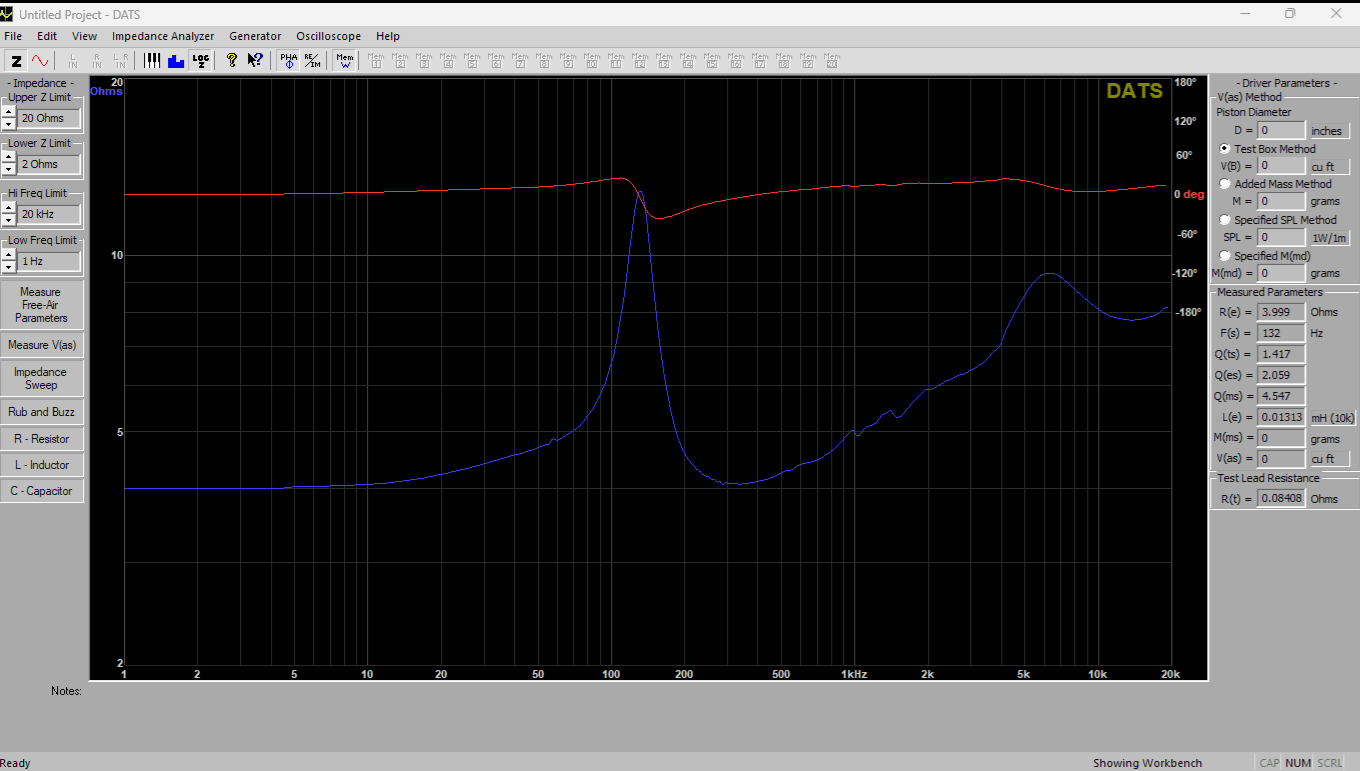

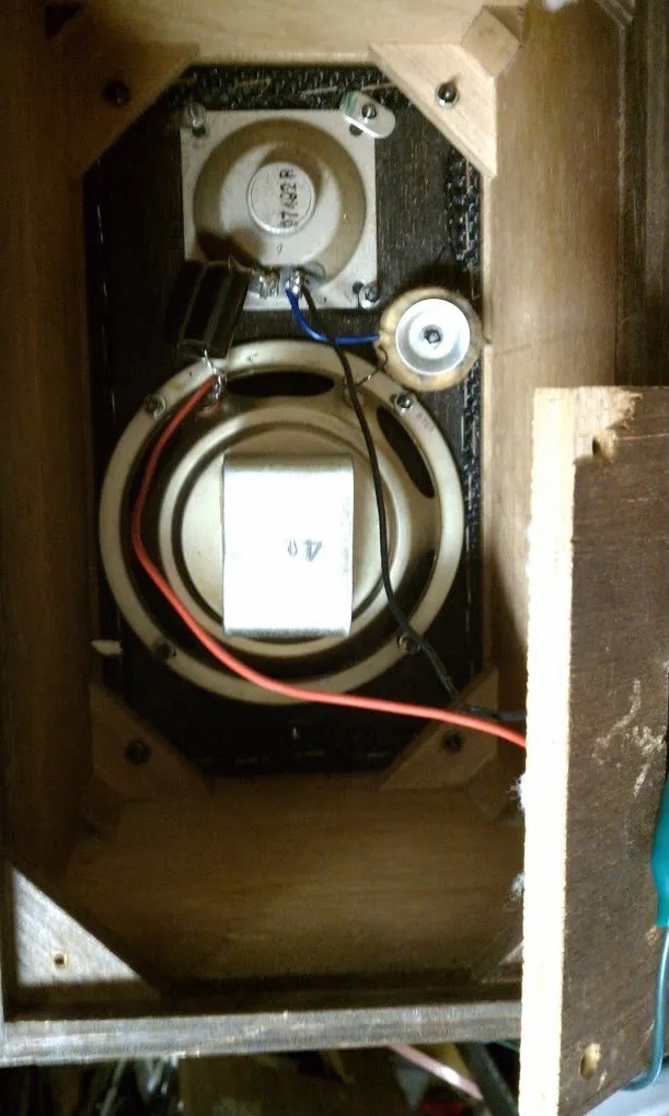

I've got a pair of Automatic Radio bookshelf speakers that I recently modded with a Foster tweeter from a pair of Zenith Allegro speakers.
The problem is the doped cloth surrounds. The dope has hardened and nothing I have tried within reason will remove it and only softens the dope up for a few months.
The box before swapping tweeters. This is a photo of the 4 ohm version, but the ones I modded were the 8 ohm version. Same cabinet same size drivers just different ohms.
If it is not possible to remove the dope without destroying the speaker I will need an 8 ohm speaker that is exactly 5" in diameter with a bolt circle diameter of 4 3/4" that can handle at least 20 watts and can be rear mounted on a baffle. So far in a casual search, most 5" speakers I've found are larger than 5" or have a bolt circle diameter of greater than 4 3/4". Response should be from about 70Hz to around 3.5kHz. I can get a more exact number tomorrow.

You can try to remove doping.
If successful (you have a reasonable chance to) you can later apply a better one, which stays flexible.
Some people (I have even seen it recommended here 🙄) use diluted carpenter's glue , contact cement, "liquid electrical tape", etc. which look good at the beginning but all harden, sooner or later.
I suggest soaking surround, but only the curved area which allows movement, not where it is glued to frame or cone, letting solvent soften it and removing whatever you can with a dry piece of cotton cloth.
Not paper or a cotton ball which will leave fibers behind.
Re-soak and repeat.
Bit by bit you will remove most of it and resonant frequency should lower to some usable value, even when dry.
Maybe you don't even need to re-dope surround, whatever remains (you'll never pull 100%) is enough to seal it but if necessary, use poor-man's dope: tile roof sealant, a water based white liquid "latex" (the paint shop guy will know what you are talking about), which dries first with a bluish hue and then transparent and never fully dries, it stays sticky forever .
Plan B: let solvent dissolve adhesive , fully remove surround and glue in place a new one.
Typically foam.
Solvents: best is acetone but you can try car paint type thinner or Toluene or ethyl ether.

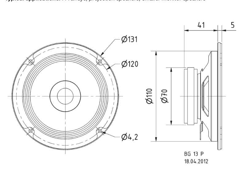

Otherwise found a high sensitivity 5" from Visaton
Which matches outer size and center to center for screw/bolt holes.
Visaton BG13P
outer is 131mm or = 5 inches
Hole mounts 120mm 0r = 4.72 inches
hole size is 4.2mm
So basically close to 3/16
so typical screw stud would go thru
