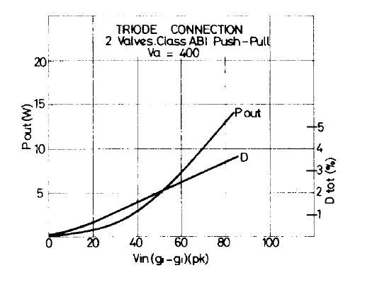

compare with a kt66 tube amp.

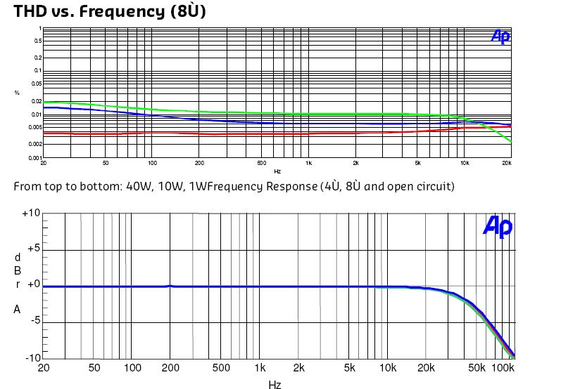

and at last a switching amp. class d
So what I want to make clear, difference we can hear sure. Caused by load depended behaivour of the amplifier.
So to be sure the amp doesn't mess with the recording I want a amp that delivers enough current without dropping in output voltage. So I need a powerfull power-supply and end-stage. Or a loudspeaker with flat impedance correct 8 ohm load.
