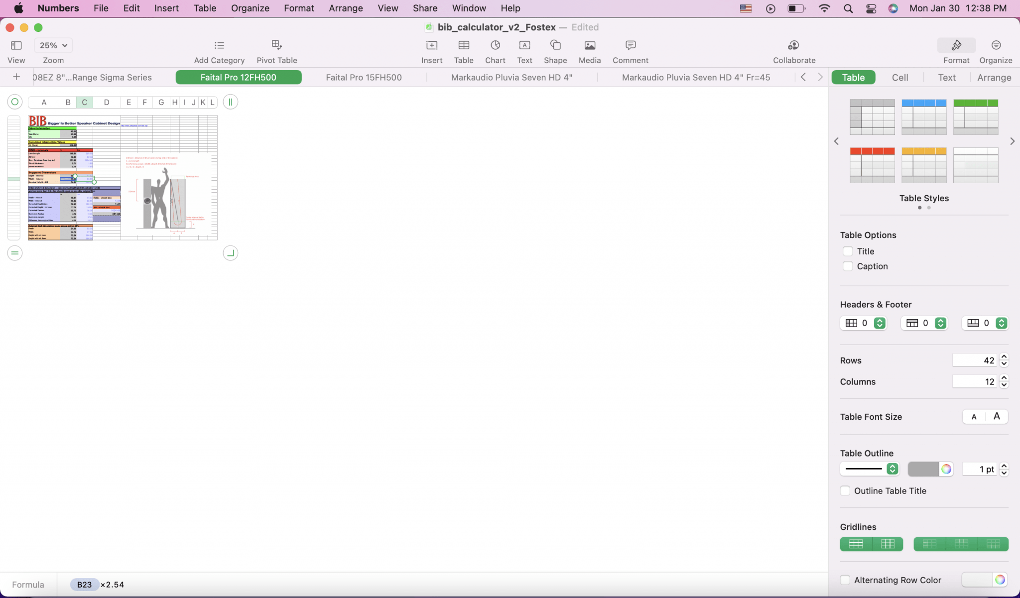

Here is what I am trying to model:
BIB inclosure
Fr=Fs=45Hz
Vas=87,30
Qts=0,25
Qts'≥0,338
Vb=308,65L
Internal dimensions - 18,87"(D)x13,34"(W)x74,80"(H)
Faital Pro 12FH500
https://faitalpro.com/en/products/LF_Loudspeakers/product_details/index.php?id=151050100
Markaudio CHP-90/Markaudio CHR-90
https://www.markaudio.com/online_shop/ch/chp-90/
Thanks in advance.

With his thanks to Scottmoose, GM, LoveChild, Planet10 and Gainfile it seems to have good pedigree ! BIB added to list. ThanksHave you tried BIB Calculator
Hearingspace, I was incorrect in my remembrance of deviating from Fs=Fr:
You can go a bit lower and it will deviate a little bit from the performance you get from a standard recipe BIB. I expect maximum soundlevel will be lower. But about 0.7 times resonance frequency is acceptable. So 0.7*70=49 Hz. That's prett close to 45Hz and will probably not make a huge difference.
