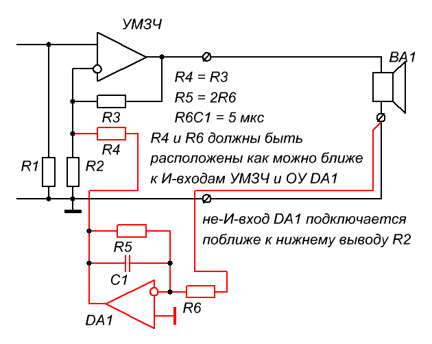

So you can easily try attached.
Make the lengths of your speaker's cables as little as possible, diameter of their conductors as large as possible, and
Clearly.
And if you can't - use any of the wire compensation methods.
http://www.diyaudio.com/forums/atta...nce-harmonic-distortion-wire-compensation-gif
Thank you. We would appreciate a translation of the embedded text and a reference to the source for further discussion.

It's just a three wire compensation setup. RTD's use the technique a lot. The gain of the circuit is adjusted to comp the drop of the two wires feeding the load.http://www.diyaudio.com/forums/atta...nce-harmonic-distortion-wire-compensation-gif
George
They drew the third wire close to the load wire, so I suspect they meant close proximity to reduce m field errors and loop pickup.
I prefer a 4 wire kelvin.
Jn
Hi, George, it’s obvious and doesn’t need much comments.
Text is easy and sets gain of 2x with corner freq above audioband.

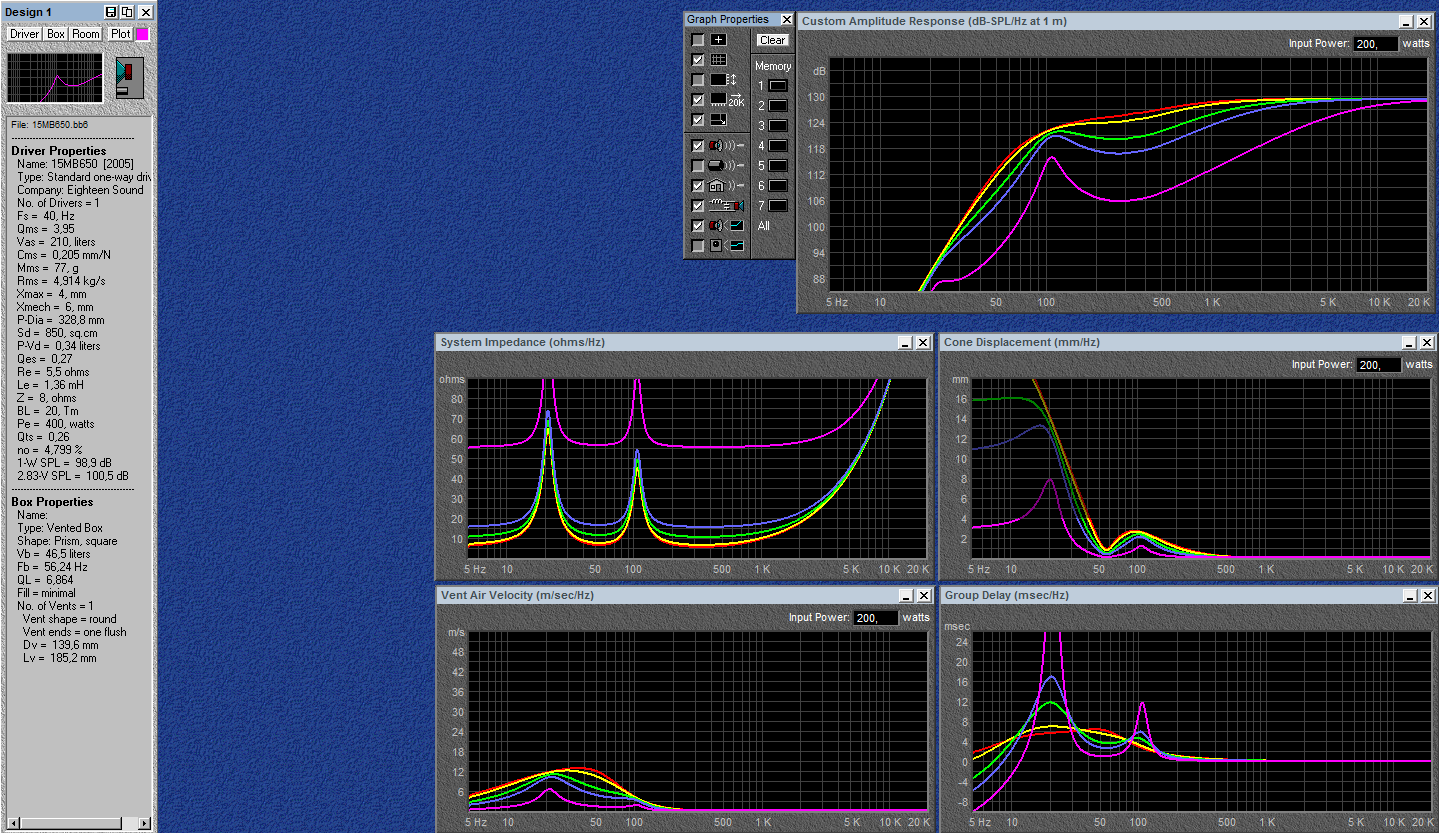

Some simulation attached.
18 Sound 15MB650 with 0.1, 1, 5 and 50 Ohms in series.
