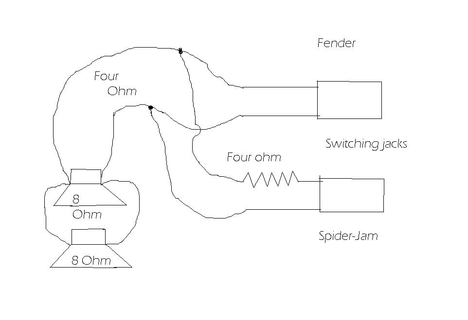

The amps don't have external jacks, that is something I am adding by mounting a jack on the back of each and routing the speaker wire to the jack and then on to the speaker(s) respectively.
The issue with the external jack has been remedied, I found a very small spot of solder that had dripped down and shorted between two of the connecters. Not sure how I did that but I have corrected it and the internal speaker is canceled when I plug in the external speaker.
In the drawing you loaded it shows a 4 ohm resister on the SpiderJam, which I understand would bring the 4 ohm load of two parallel speakers up to 8 ohms. My question is: How do I determine the type of resister to use. I assume it needs to be 4 ohms but the resisters I normally see are 1/4 watt. Do I find 100 watt 4 ohm resisters? And where do I find something like that?
There is a small difference in the tone of the Fender going from a 4 ohm load to a 12.
I understand that the higher ohm load lowers the power output. The amp is actually rated at 90 watts at 4 ohms. So I think that makes the amp about 80 or so watts at 12 ohms, but I am not sure.

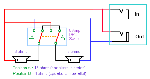

you need to put a switch in the cab so it changes from series wired to parallel, which will give you a nominal impedance of 16 ohm (your 12.6) and 4ohms in parallel.
Adding a resistor just wastes power output so no better than 16 ohm all the time.
your 4 ohm amp will handle 16 ohms, just fine wont go as loud is all, but 4 ohms on the 8 ohm amp will overload it, may even let the smoke out.
ArcticBreeze has the best & most practical approach here.....as one probably isn't concerned about absolute power output, an 8 Ohm output to a 16 Ohm load is "gentle" on an amplifier....this approach is the most logical.
On the illustrated wiring of the switch, ignore the "output jack" and the wiring part of it (Unless you want to add more drivers??). Like a big HF horn? (both set for 16 ohms...to get 8 Ohms)

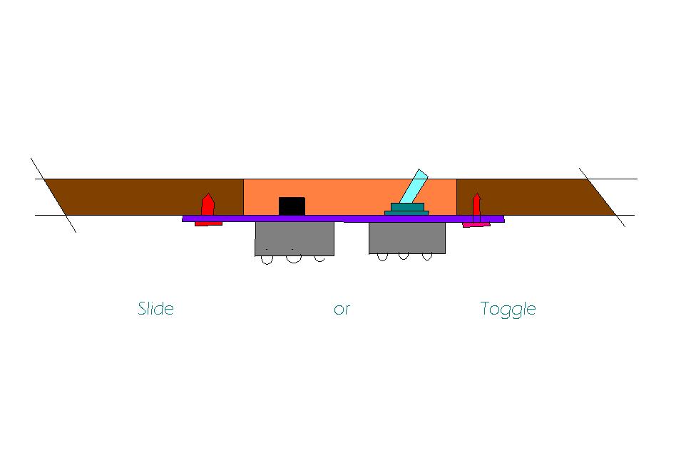

Dual pole dual throw (DPDT) switches are everywhere...Radio Shack AKA ("rat Shack) They still have them!!...Individuals do recess mounting of switches often times...to prevent accidental activations.
