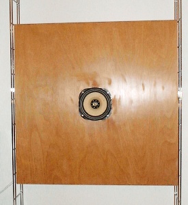

I'm looking for advise on a single full range driver for a speaker going up against the wall. I currently have Tang-Bang W3-871s which has acceptable bass to 80db and rolls off down to about 50. Cabinet is 5 1/2" x 7" x 7".
I'd like a driver to go flat to 50Hz without some mid-bass hump at 100hz.
A 4'" driver with Xmax of 3mm (vs .5mm for the 871) seems a good choice. Problem is, most 4" roll off above 13K.
The Jordan JX92S has too much bass and treble looks a little rough. The smaller JX53 is smoother in the HF but is a 3" driver like I already have, albeit with a 3mm Xmax. Besides I am worried about harshness of a metal driver with a digital amp.
Fostex is an option but most have very low Xmax and the FE 108EZ or FX 120 have Q's of 8! Wow that's high.
Tang-Band has a W4-1320 bamboo driver but still not available.
I don't want any x-over or baffle step correction to muck up the signal path. Cabinet size would be 6" x 8 1/2' x 7".
Any suggestions for a driver and vented or sealed cabinet design would be grealty appreciated.

I think the Adire FR125S sounds like what you're looking for, but I'm not sure if it's available yet. Also, I'm not sure if you can find and specs or response graphs on it yet either. Timn8ter amongst others, knows a lot more about it than I do. This is just what I vaguely recall. If I remember correctly, I think it's supposed to compete with the Jordan for about half the price, so maybe that'll give you some idea of it's capabilities. Might want to google it though.
I've been given a pair for testing. The FR125 looks to be very competitive with the Jordan. Bass response is similar to the WR125S which means you can put it very close to a wall and get nice sound. The big difference is an improved voice coil and a slightly different cone treatment. Additionally the surround material extends just a hair more onto the cone which gives it smoother reponse and helps cone control in the upper range. The FR125 should be available for purchase in about 3 weeks. I've heard the WR125S in a 9 liter cabinet with a 1.5D port which provides nice bass response without a bump in the upper bass region. I expect the FR125 would do the same. I'll post more info as testing proceeds. Keep an eye out for Planet10. He's got some good stuff coming for this driver.
Thanks for the info. I emailed Adire and they thought the FR-125 would be a good choice. I got the frequency response at www.creativesound.ca. There is a 5dB boost in the bass between 100-200 Hz which I am a little concerned about.
Parts Express will be selling the Tang-Band W4-1320 SB. This 4" bamboo driver looks flatter through the bass and a moving mass of about 1/2 the Adire unit. No is .501% vs. .2??%. Qms is 1.3. Xmax 3mm. The response curve is maybe a little better up to 13kHz then a dip and 8 dB peak (resonance?) from 15-20Khz. Price is $34 each.
The driver is made from bamboo and I am a little concerned about bamboo coloring the sound as I like paper cones so far. Although I've heard Audio Note uses wood drivers and they are quite popular.
Stilll considering the JX-53 as the 3mm vs. .5 mm Xmax may give the bass I need. This is the *smoothest* 3" driver I have ever seen from 10-20K. And the waterfall plot shows total damping in 1.5 ms. Should be very clean with excellent prat within it's SPL rating I'm guessing.

Take note that the response testing of the FR125 was performed in a 7 liter box. That will cause a bump. Dan's going to test it in a IES baffle so the results should be a little clearer. Also, if you're going to place the enclosure near a wall you will not want the bass response to be equal to the mids in open space.

The JX53 is a 2" driver (53 mm).
Resonance is only 110 Hz. I don't see how it will be flat to 50Hz, even in a ported cabinet. The graph on Jordan's website shows minus 10 dB @ 100 Hz in a sealed cab.

A driver has to mate with a box (considering we are talking about small box fullragen drivers here).
if the box is small and you got a hump an aperiodic port can help. what i really does i make the box more lossy.
small drivers like th JX53, ff85K etc. prefer to be XO at 300hz+ (and really shine when XOed at 500Hz+).
5" drivers would offer more bass albeit at the expense of more beaming and rolled of hf that is why some have mated the JX92 with super tweeters above 6k (the GS2 and EB Cantare).
so it may seem that a good 3-4" driver would be the most balanced. Fostex drivers tend to perfrom better than the specs would have you believe and since many of them are designed for horn loading they might be sutiable for near wall placement. However their tonal quality is an acquired taste and for general purpose audio/Ht/av use i have been recommended the JX92 and (very recently) the FR125 over the FX120.
unfortunately Adire or Jordan dont make a 4" (like the FOstex 108 or 103) I suspect if they do it might be the fullrange speaker for most of our needs esp. for those who are thinking of a 1.5 way (like the ELF 1.5).
