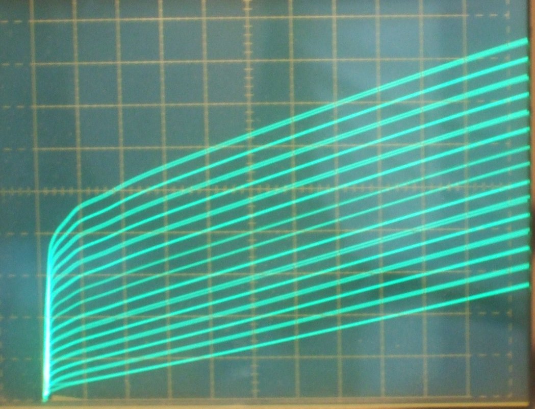

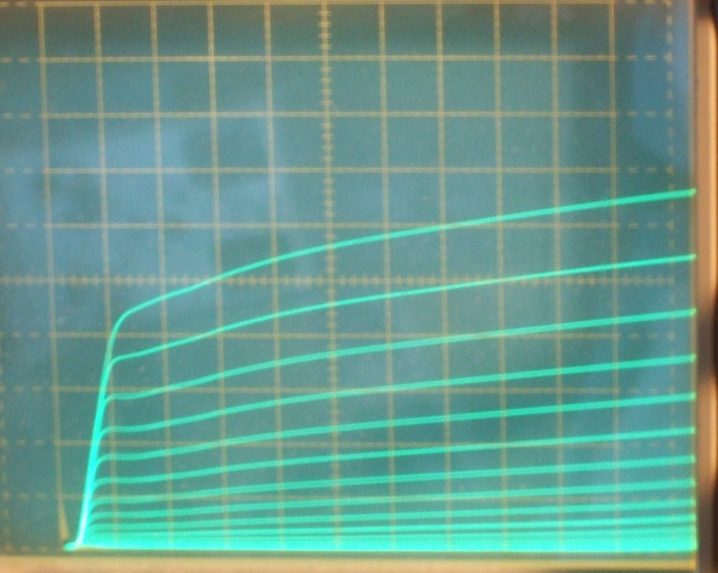

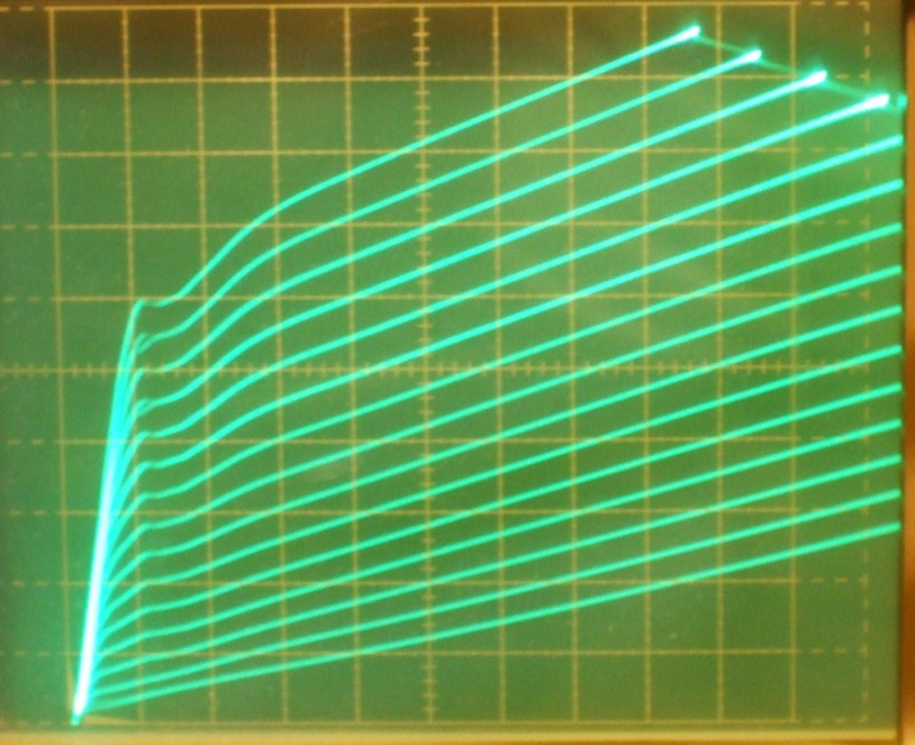

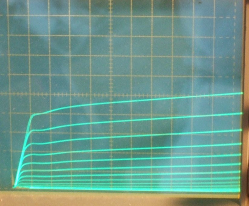

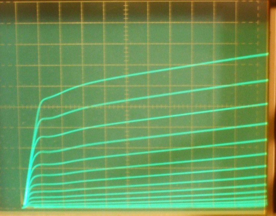

Here are some LV curves for the 21LG6A and 6HJ5:
(Vg2 at 25V, grid 1 steps -0.6 V down from 0V, 10 mA/div Vert., 10V/div Horiz.)
1) 21LG6A
2) 6HJ5
I had to select thru some of those to find the good ones posted. Half of them were more like 40 to 50% higher knee voltage. Apparently that's not a very controlled parameter. It would be easy to test some tubes though, using just a 25V supply for screen, a variable 25V supply for plate, and a plate current meter (Vg1 connected to cathode).

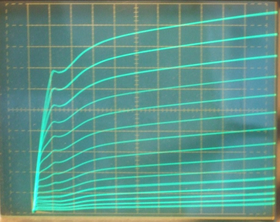

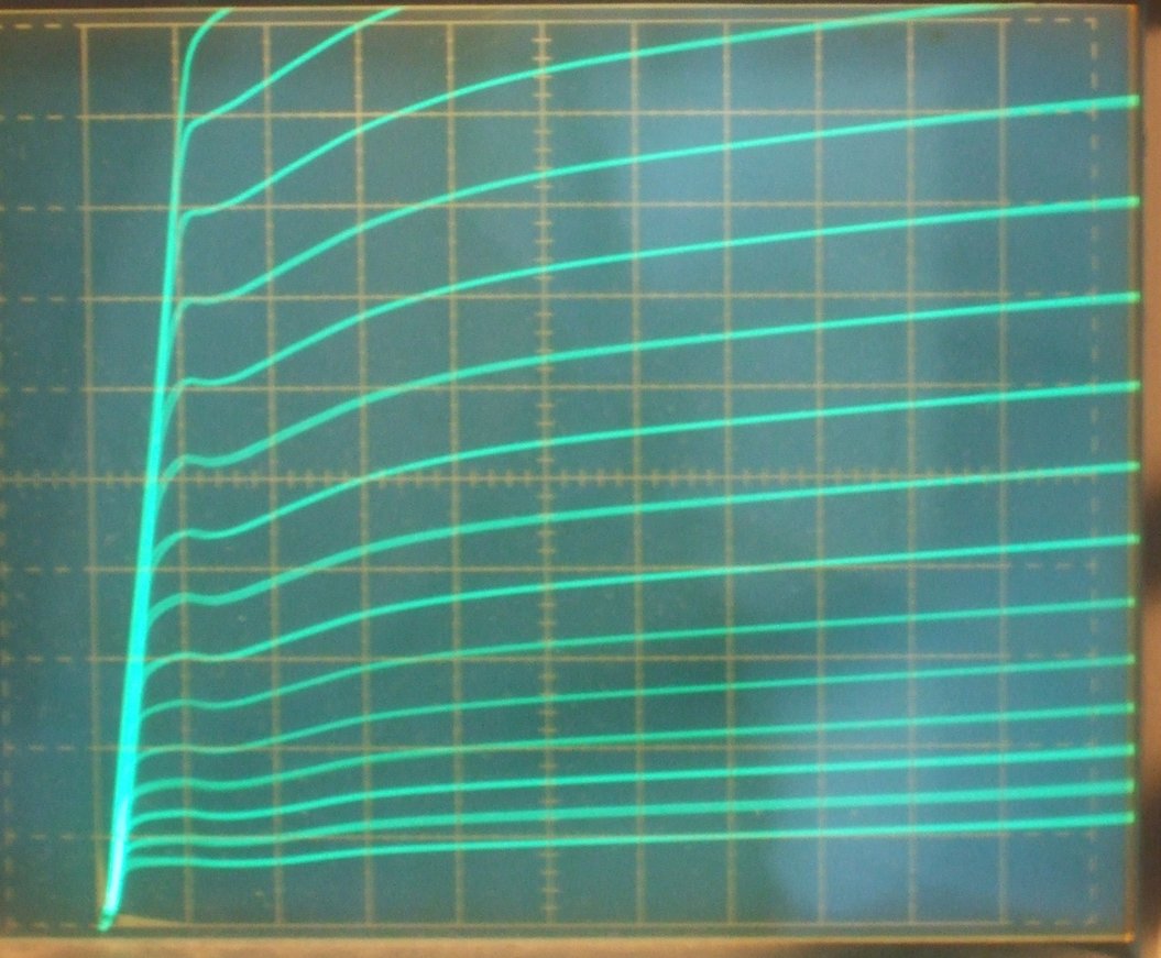

I also traced 12AU7 and 12B4A triodes for LV operation. You want a low Rp triode for LV operation!
3) 12AU7 Raytheon black plate: -0.6 Vg1 steps, 0.5 mA/div Vert., 10V/div Horiz. (changed to 11 divisions across)
4) 12B4A GE: -1.5Vg1 steps, 2 mA/div Vert., 10V/div Horiz. (11 divisions across)

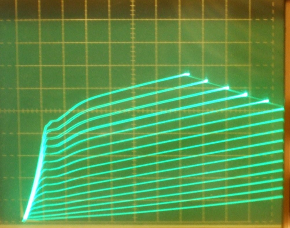

5) 26DQ5 at 25Vg2 again for ref. (same grid 1 steps -0.6 V down from 0V, 10 mA/div Vert., 10V/div Horiz. )

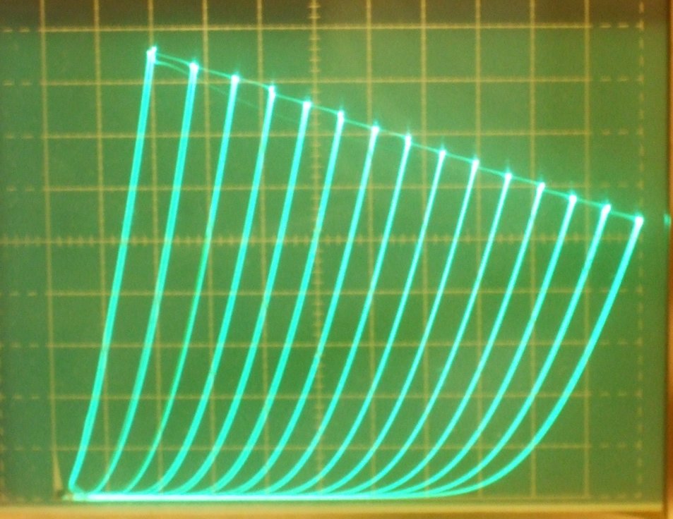

6) 21HB5A at 25 Vg2 again for ref.

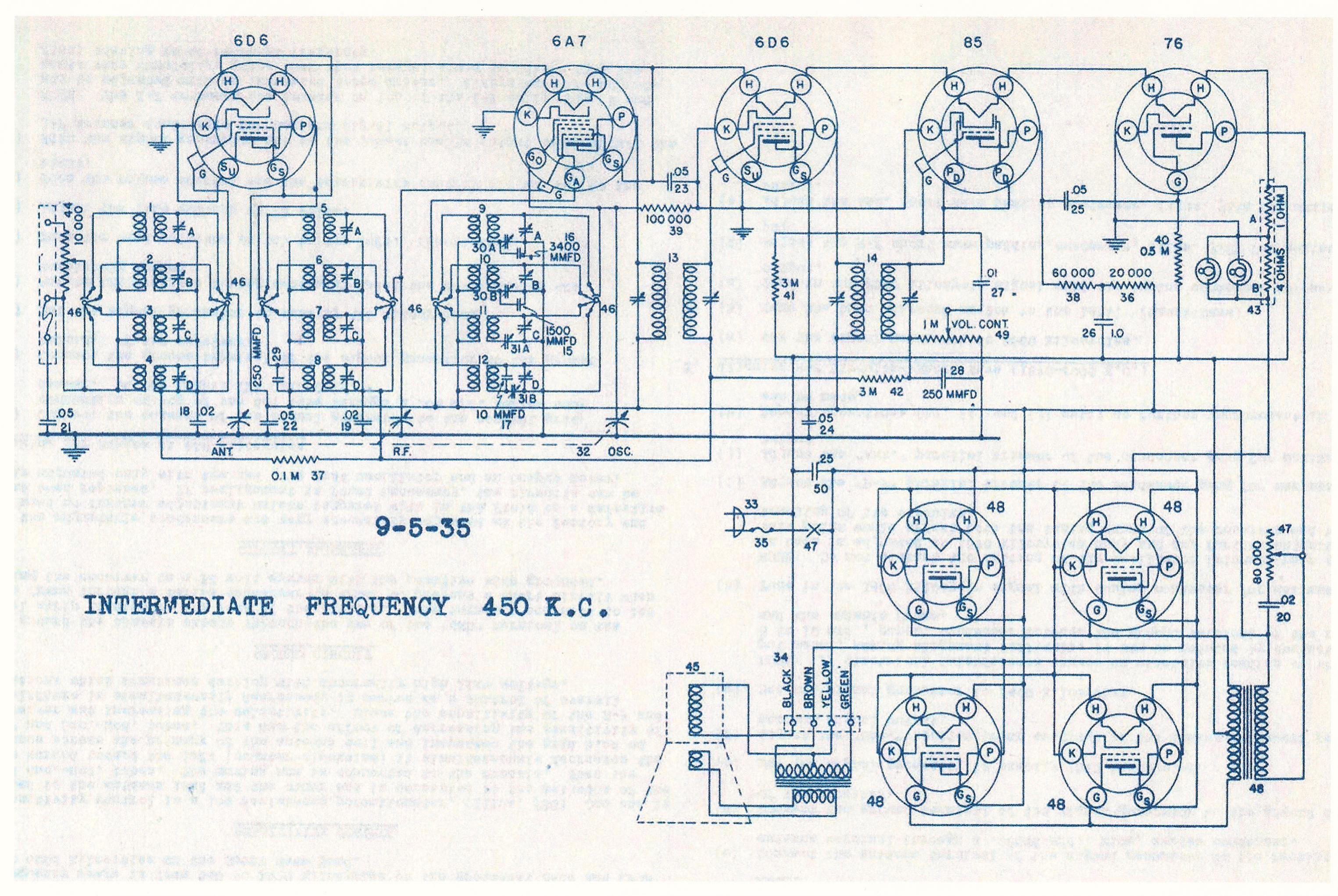

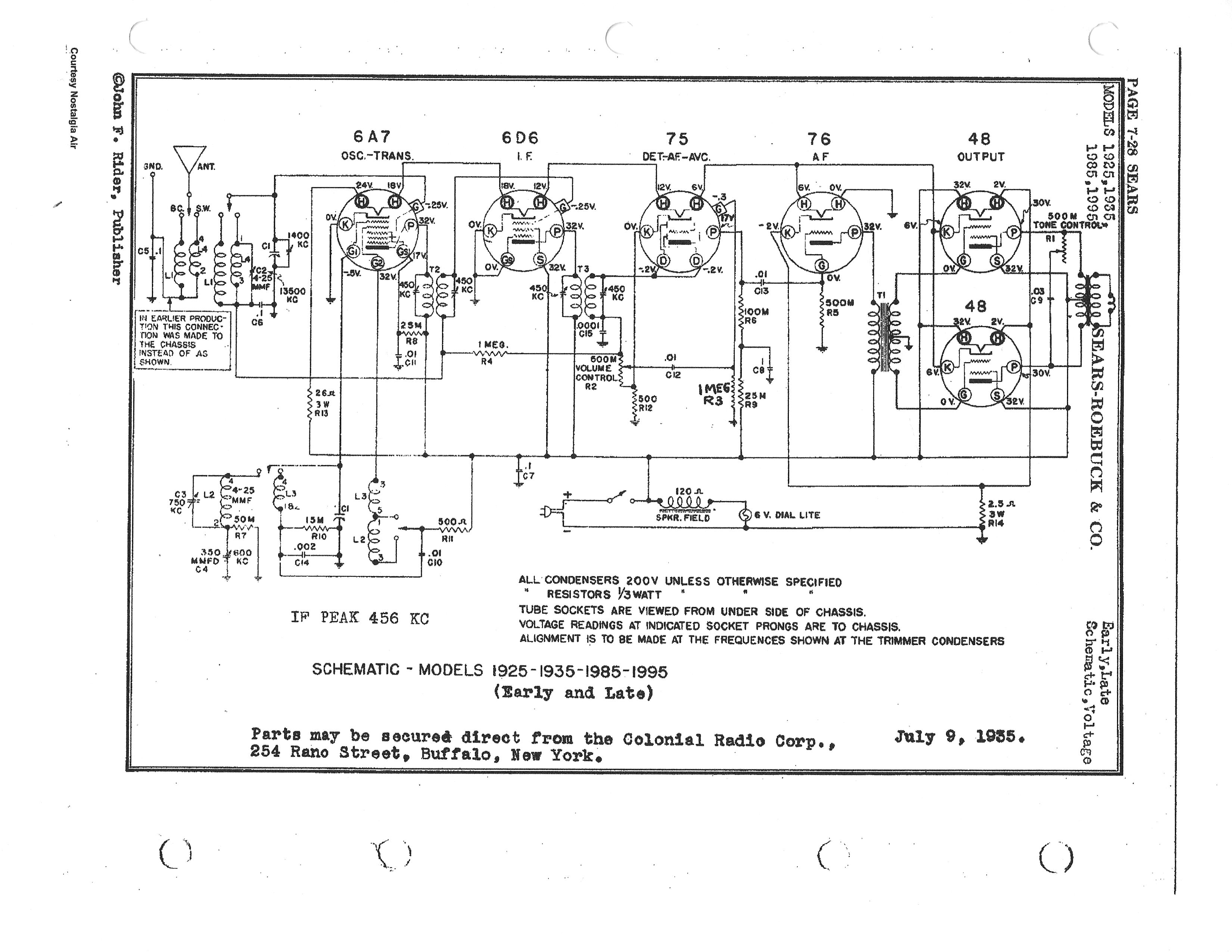

Farm Radios

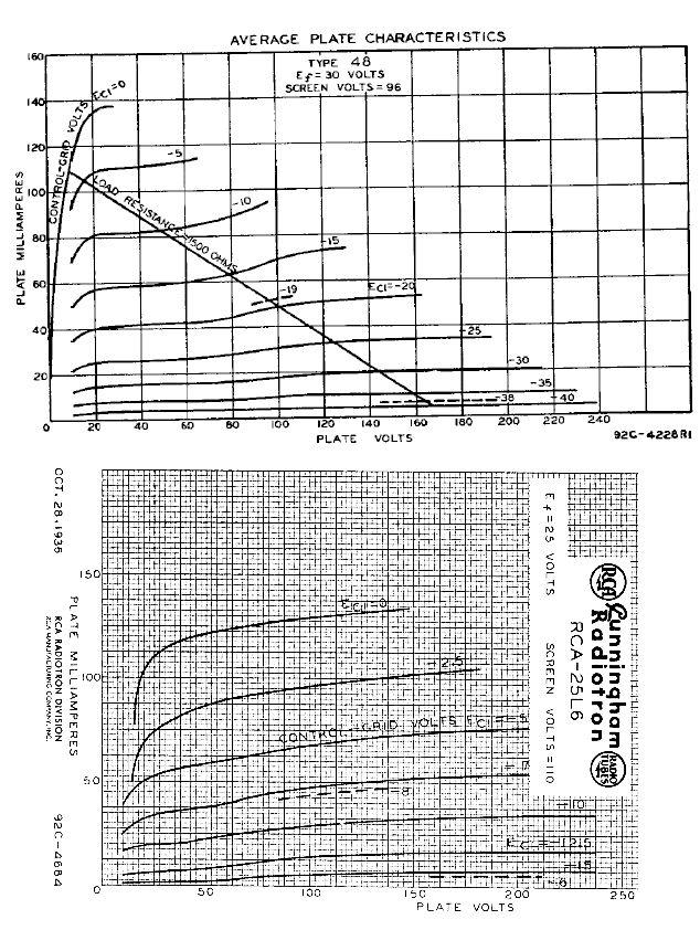

Besides the 6 & 12 volt DC vacuum tube auto radios there was a line of radios built for 32 volts DC. This was a common voltage on farms in the 1930s before the rural areas were electrified. Unfortunately these systems used the same plugs, receptacles & so on as the 110 volt AC systems. So when the farming areas were finally hooked up to the grid many of the farm radios were simply plugged in by the unsuspecting user. Lots of smoke, so not many left for today’s collectors.
Notice in both schematics no HV supply at all. All the tubes ran on 32V DC & it looks like they did OK. All the output tubes are 48s. These had been developed specifically for the downtown areas of quite a few large cities still running on the Edison 110V DC system. New York City had a lot of that. I’ve read somewhere that part of downtown NYC still has part of the old DC system running in honor of Edison. Otherwise in those days some kind of inverter would have been required to get AC to run a transformer. That is an expensive solution to run a single radio.
I've often thought 25L6s could be successfully sub'd into these circuits in place of the 48s.
...I've often thought 25L6s could be successfully sub'd into these circuits in place of the 48s.
Note that a pair of '48 is good for 5 Watts with 125V DC on hand, but nearer 0.156 Watts worked at 32V. That four-'48 radio was a whopping 0.3 Watts.
(This assume no grid current. Both those radios use grid transformers. They could be socking the grids "way positive" and at these conditions no harm and not much foul.)
The 0.15W would be a heck of a headphone amp.
'48 is actually marginally better conducting than the 25L6 and kin; considering the availability today, the 25L6 is for sure a go-to. There may be a $1 to equal it, but the hunt delays the build.

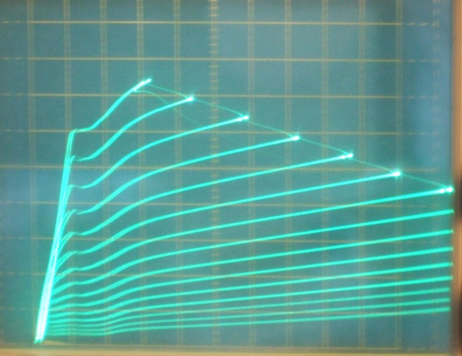

I curve traced a 12L6, 12W6 and 12DB5 at 25Vg2. These all seem to have the same specs in the GE handbook, but the 12L6 had the best knee curve shape.
All at 2 mA/div Vert., 10 V/div Horiz., -0.28V steps on grid 1 down from 0V.
1) Haltron 12L6
2) Sylvania 12W6
3) GE 12DB5
12/6DB5 is available on the ESRC $1 list. 12L6 looks better though.

1) Haltron 12L6
2) Sylvania 12W6
3) GE 12DB5

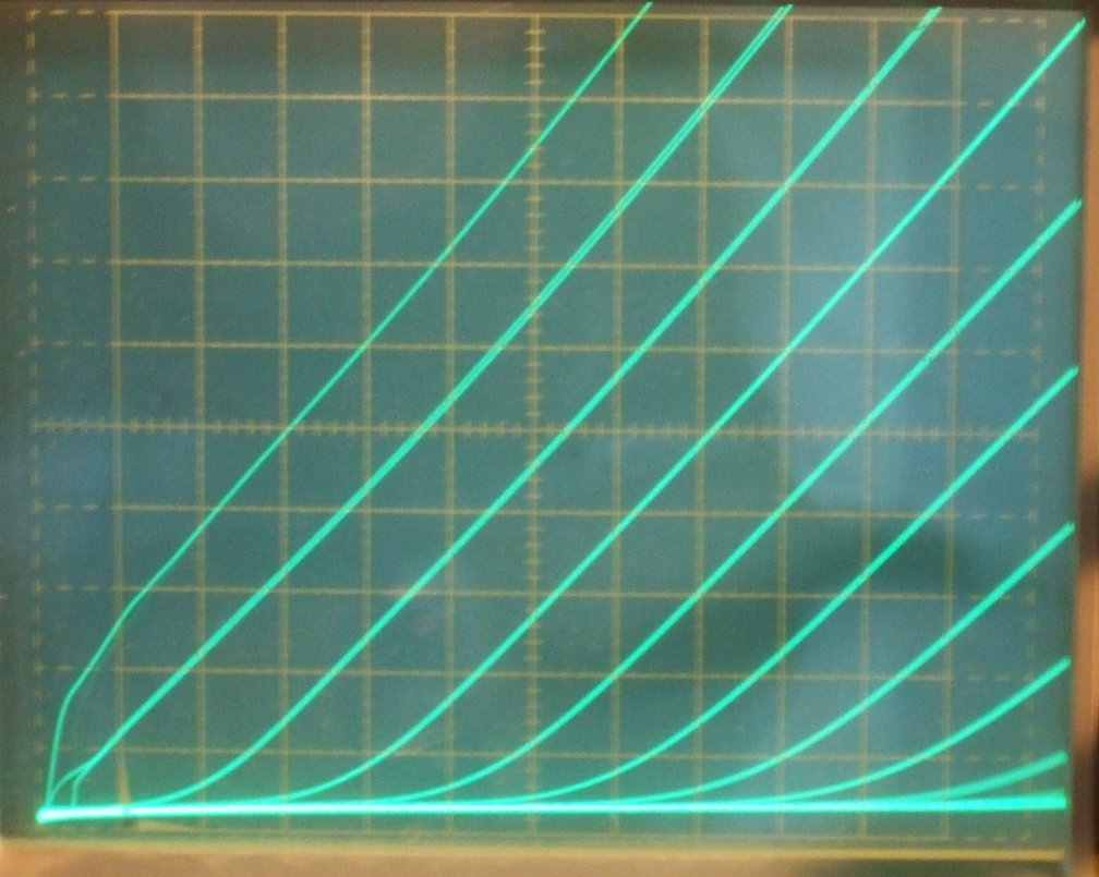

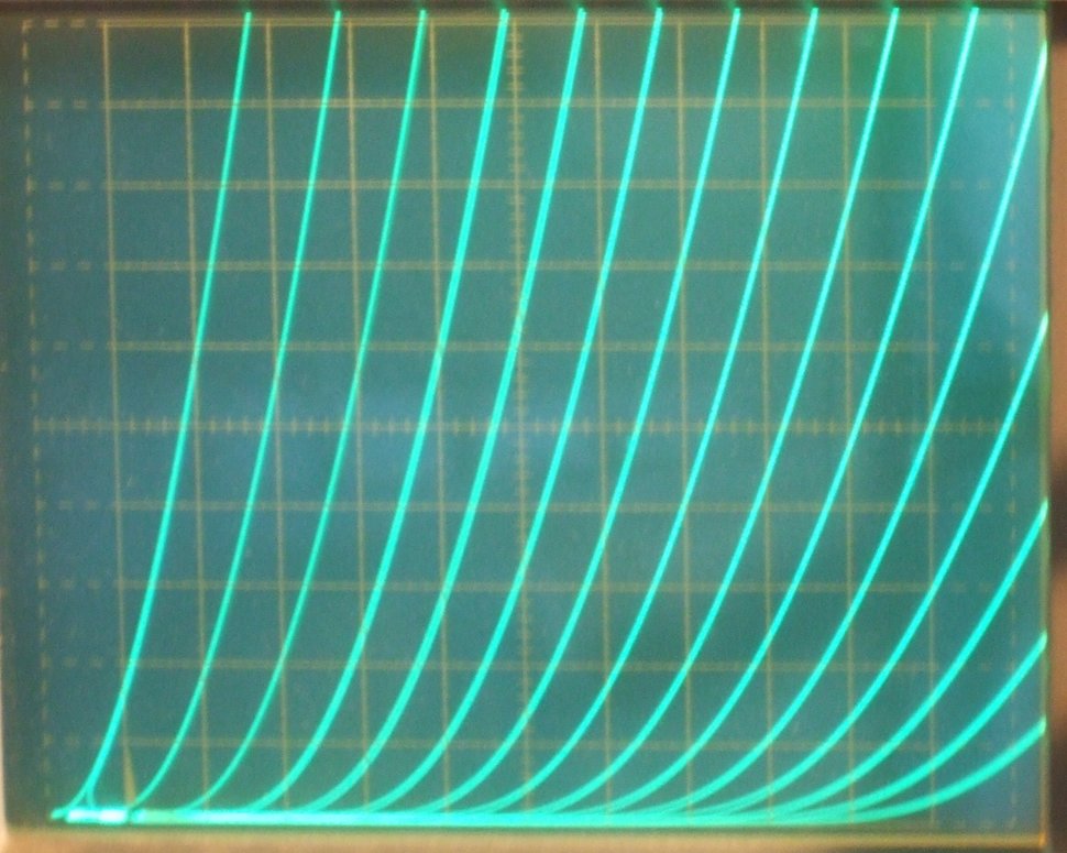

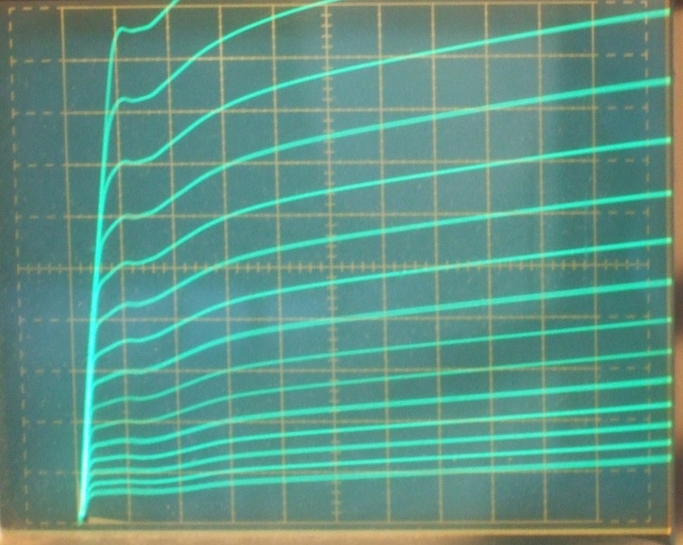

I got some new RCA 26A7 tubes in. So here are some curve tracings.
http://tubedata.milbert.com/sheets/049/2/26A7GT.pdf
All curves are 10 mA/div Vert. and 10V/div Horiz.
1) single pentode, +25Vg2, -0.6Vsteps on grid1
2) parallel pentodes, g2 drive, +1V steps on g2
3) Crazy drive parallel pentodes, +0.5V steps on g2
4) triode mode parallel, -2.5V steps on grid 1
The knee kinks are awful. Crazy drive doesn't help enough. But the triode mode looks quite nice, Mu around 2.9, Can get 30 mA at 10V min. in triode.

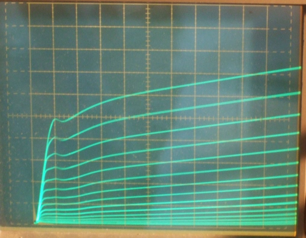

for comparison, the 21HB5, 21LG6, 6HJ5 and 12L6 again:
10V/div Horiz., +25Vg2, -g1 drive
5) 21HB5 10 mA/div Vert.
6) 21LG6 10 mA/div Vert.
7) 6HJ5 10 mA/div Vert.
8) 12L6 2 mA/div Vert.
I think I'll run off 21HB5 and 12L6 triode mode LV plots next.

Some triodes:
The 21HB5 in triode mode gets 12 mA at 10V minimum. (Vg1 = 0V for all) Mu 4.8
The 26LX6 in triode mode gets 20 mA at 10V minimum Mu 4
The 21LG6A in triode mode gets 11 mA at 10V minimum Mu 3.6
The 12L6 in triode gets 6 mA at 10V minimum. Mu 6
(the 26A7 in triode got 30 mA at 10V minimum, Mu 2.9)

I played with the 26A7 to see if anything else useful could be found, and I found it will work well as a space charge triode.
Pic below is with both 26A7 sections in parallel. A positive 0.33V to 0.43V works well on grid1. Then grid 2 is used as the normal neg. going grid. (OOPs! note: I didn't quite get the base lined up on the bottom graticule line for the pic)
Scale is 2 mA/div Vert., 10V/div Horiz., -1V steps on grid2, +0.33 on grid1 (drawing total 1.4 mA thru grids 1 for both sections in parallel, so 0.23 mW diss for each grid 1)
Gives a Mu 17.5 triode with about 4.5 mA at 10V plate. So this is a 6GM8 (section) substitute!
(26A7 cost me about $3.50 with shipping from one Ebay listing, the other listings were -way- too expensive)
A potent (4.5 mA at 10V plate) and linear space charge tube, 26A7, Mu 17.5.

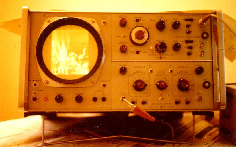

7788
Was used in the HP 1402A, dual channel vertical amp plug-in for the HP140 Series Scopes. My recollection just two of them in the entire scope other than the CRT. 20 MHz BW.
Data sheet shows the 7788 cranks on very quick.
Nice scope, easy to drive. With storage in the 141T vers & SA plug-ins it was a great success. Sold like crazy.
Video on P31 phosphor not great. Somewhere in the pile here is a better shot.

Well, the TV Sweeps are not working well for space charge tubes. Having to draw 20 mA on grid 1 to get 1/2 ma plate current at Vp = 10V. The Mu's were up around 30. Tried several different sweep tubes. NG
Looks like maybe a low gm1 and very low Rp (Ri) is needed for space charge operation. So leaving out the sweep tubes.

PP 25L6 Receiver on 32 Volts
Looks like someone did it. In this persons vers he has used another 25L6 as a driver, more drive available than the other versions. Might even do some Class AB2.
6W6s are same as 25L6 so could be used in a trial. Something to do when it rains. A few hundreds of mWatts? Maybe!
And no hassle with a vibrator PS. Looks like about 30W all up on that farm supply. Anybody got a WinCharger?

But out of curiosity, I've looked at the 13FM7 tube's "other" Mu 66 triode #1 for the gain stage. (this is an el cheapo tube by the way)
In conventional triode we only get like 50 uA peak at 10V plate minimum.
But in positive grid1 territory it provides 4.7 mA (or more!) plate peak easily at 10 V min. (see pic below)
Measuring the grid current: at 1/2 way 2.35 mA plate it draws 0.5 mA thru the grid1 (at +1.9V on grid),
at 4.7 mA it draws 1.6 mA (at +3.8V on grid)
So if two of these tubes were in a P-P gain stage, driven by a CT'd 1:1 xfmr, the CT could provide the avg. DC current (0.5 + 0.5 mA) from a resistor pull up. So the AC -delta- current for max drive is: +1.1 mA - 0.5 mA = 0.6 mA for 1.9V+1.9V delta change.
So I guess that would be Rin = V/I = 3.8V/0.6mA = 6333 Ohms. ???? correct ???? (I'm not real sure about that math....)
We probably don't need all of 4.7 mA peak currents for an input gain stage, so this input impedance could easily be double or tripled. (and the min. plate voltage could go even lower than 10V) So I think this gain stage is do-able.
So if 6333 Ohms (or 2X or 3X that) can be driven by the source, we get 66 gain from the triode 1 side of the 13FM7. Then the triode 2 side (the big one) provides 12 mA peak currents to work with in a P-P output stage.

Picture below:
13FM7 triode side #1 (Mu 66), +0.25Vg1 steps, 1 mA/div Vert., 10V/div Horiz. (the neg. g1 curves look the same, just continue below the bottom curve)
