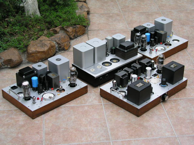

I test them all already.
In my favourite i like Tango NP-216.
thanks
Thomas
