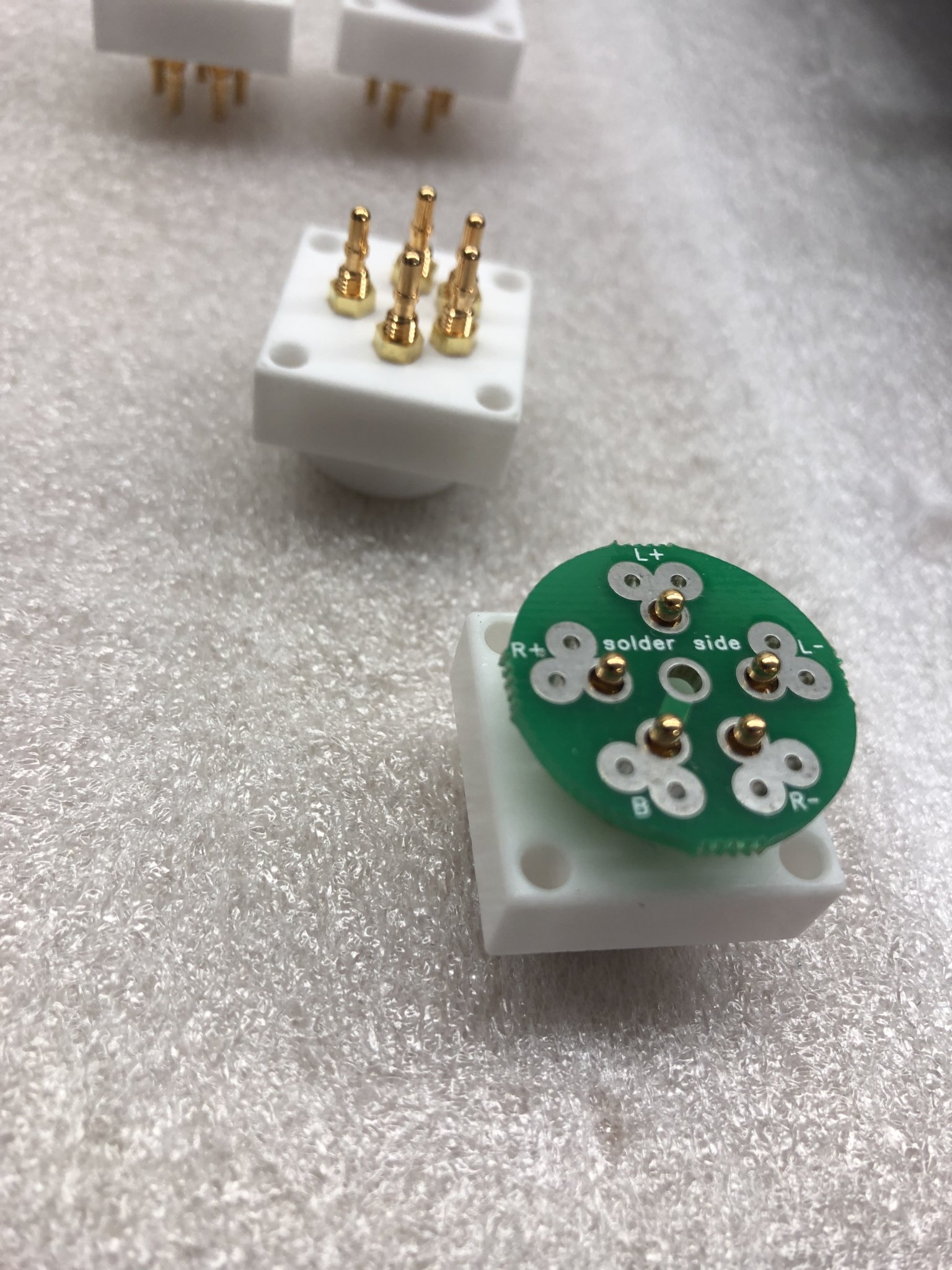

You can also print out the socket body and buy the sockets from Ebay. Here is a link to the Stax female socket for 3d printing that I've designed and made public years ago:https://www.tinkercad.com/things/7pGkeN939L6
The socket pins are something like these: TUBE SOCKET PIN FEET for KT88 EL34 6550 GZ34 274B Tube Socket Valve Base DIY x10 | eBay
... Here is a link to the Stax female socket for 3d printing that I've designed and made public years ago:https://www.tinkercad.com/things/7pGkeN939L6

If you are happy with print vs CNC and plastic vs teflon, then go with that connector. For me there is simply no comparison between both, this is of course if you strive for the best.Wachara, you're DA Man!
ขอบคุณครับ
Please elaborate: are you talking about sound quality? mechanical strength? durability? all of the above?If you are happy with print vs CNC and plastic vs teflon, then go with that connector. For me there is simply no comparison between both, this is of course if you strive for the best.
I think I was clear? Plastic vs teflon, 3D print vs CNC.Please elaborate: are you talking about sound quality? mechanical strength? durability? all of the above?
Two last pieces available.I have some rectangular (smallest possible) teflon sockets with the nice tube socket pins and a separate back mounted PCB not blocking mounting screws and allowing for easy parallel connection. PM if interested.
I bought a couple of these and they are fabulous. I don't have 3D printed ones to compare, of course, but these are very very solid . The nice gold-plated sockets hold the headphone plug very tightly - just the thing if you intend to keep the cable plugged in (which is my use case).Two last pieces available.

Given you (I) can 3d print in Polypropylene, PEEK or PEKK, or polycarbonate (very likely delrin too) these days and the shape is rather simple; I would not sweat the differences anymore. even glass loaded or kevlar is doable.

Sure, depending on your requirements you may like it or not, useful for sure (as a direct cable connection would be as well) but never as good as CNC out of massive piece of teflon. Different requirements, different solutions.Given you (I) can 3d print in Polypropylene, PEEK or PEKK, or polycarbonate (very likely delrin too) these days and the shape is rather simple; I would not sweat the differences anymore. even glass loaded or kevlar is doable.
Same as there are cases machined out of a solid piece of aluminium, others are made out of just sprayed metal sheets.
Oh I agree, CNC solid PTFE is sexy and i'm not taking away from that. If I had CNC and a lump of PTFE, thats what I would do. It would certainly take less time!! 3D printing is painfully slow, if you want a good end result and its simply not possible to go too fast with these materials. Your rendition is a very good one that isnt available from any other source. However If someone—such as myself, anyone else with a printer, or access to a print farm—while it would not quite match the surface quality (without some sort of post processing), I would certainly not sweat any possible difference electrically; as it would simply not exist.
