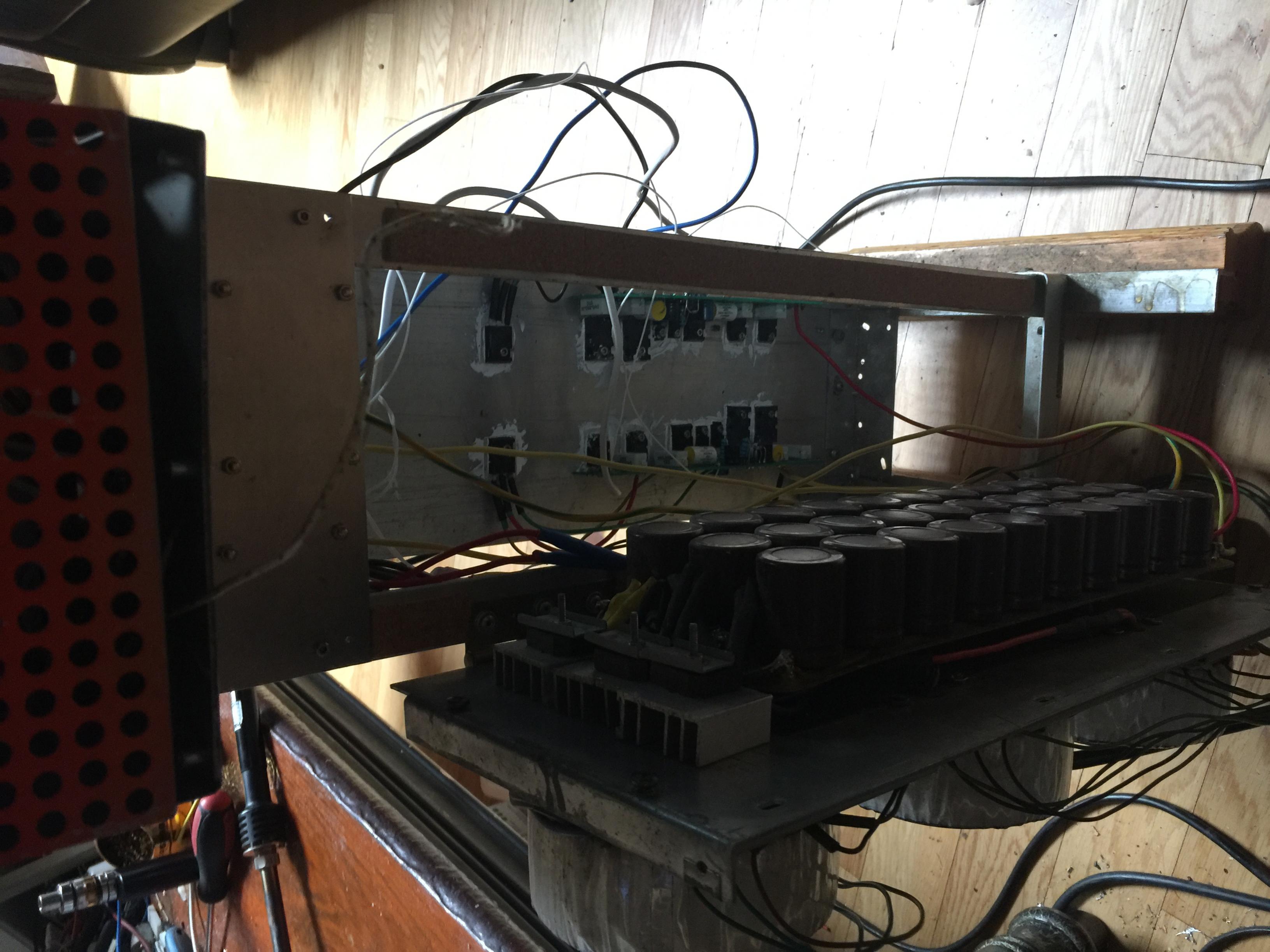

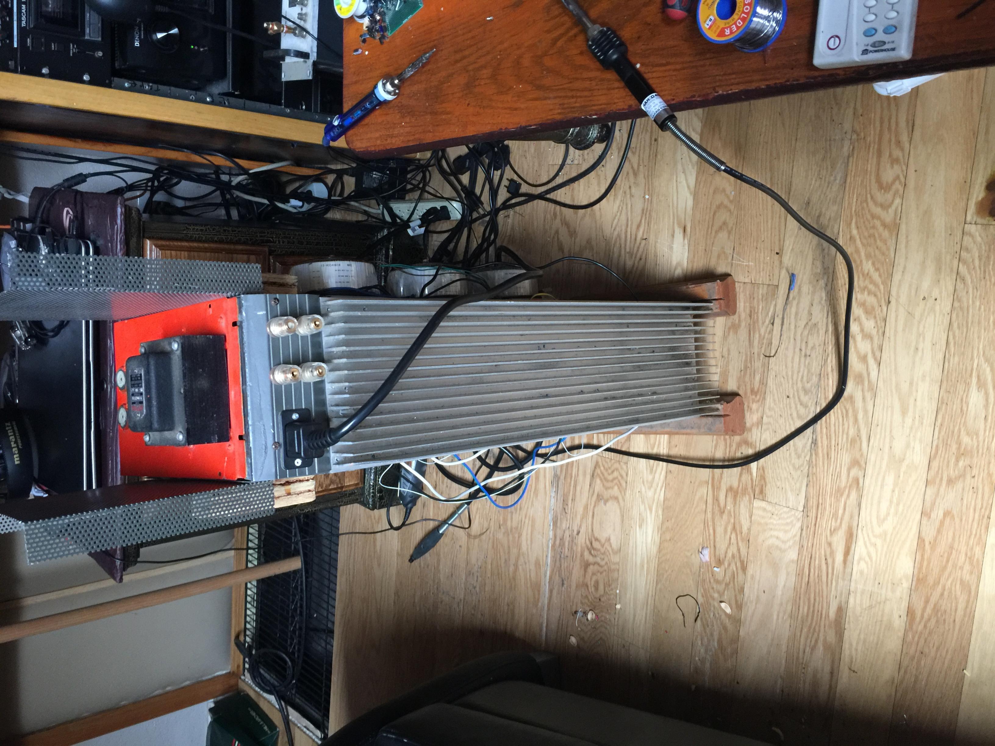

I'm building a WCF stage using 6c33c tubes for a friend but I can't help but think it is a waste of time and money. Does anyone have experience comparing SS vs tube followers?

Are you saying tube followers have a noticeable "sound"? I'm building this stage for a friend that wants a "superior" version of his 6080 WCF power buffer. He insists that tube output stages have a "bigger sound stage" and might be more euphonic than SS output stages. I'm not so sure about this.
