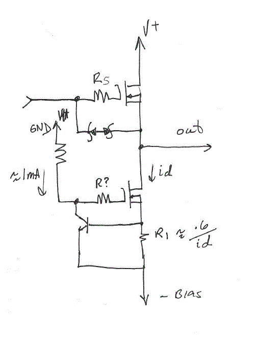

The DN2540 and its variants are wasted as direct emitter followers on their own (limited availability, high capacitance). they are eminently suitable as constant current source loads for an advanced source follower driver with lower distortion (current source source load) than the simpler implementation with a resistive source load.
The Supertex (and similar devices from Ixys) are best suited for a current source load for a small, low capacitance enhancement mode mosfet (the smallest you can find in a suitable package and voltage rating).
Whatever you chose for the top device in this scheme, it needs to be protected with a pair of back-to-back zeners from gate to source. You essentially need the smallest mosfet you can find with a 500+ Vd rating for the topside fet. Small device = low capacitance. Of course, you could short-circuit some of these considerations by using the same fet as a top-side driver with a bottom-side current source using a ring-of two source using the same mosfet and an NPN bipolar transistor.

As I mentioned in my previous post, you don't really need depletion mode fets if you're trying to make a current source loaded source follower. The attached schematic shows a possible circuit utilizing a ring-of two current source to load a source follower for low distortion. The mosfet in the ring-of two could be also replaced with a bipolar transistor - there are many candidates, but the MPSW42 comes to mind, and there are several TO-126 devices that are even better.
A stopper resistor is definitely needed fro the top mosfet. I usually start with 100 ohms. 1k works fine, but that might be overkill. I'm not certain if the stopper is needed for the mosfet in the ring of two. I'd try it without one first.
If you use a bipolar ring of two instead, a stopper can actually make matters worse.
