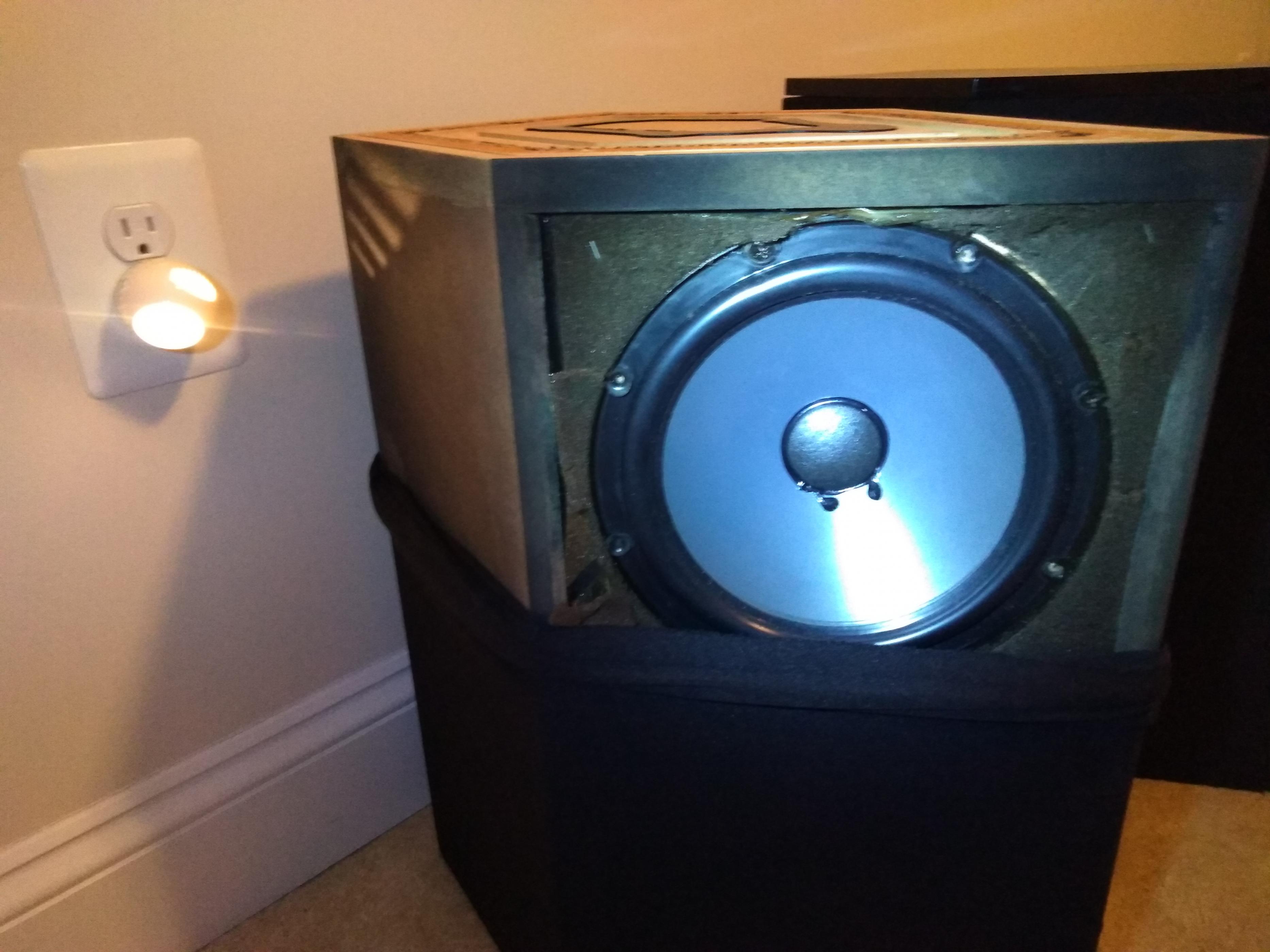

Soundwave Silhouette Series II Info.
Ill get some better pics soon.

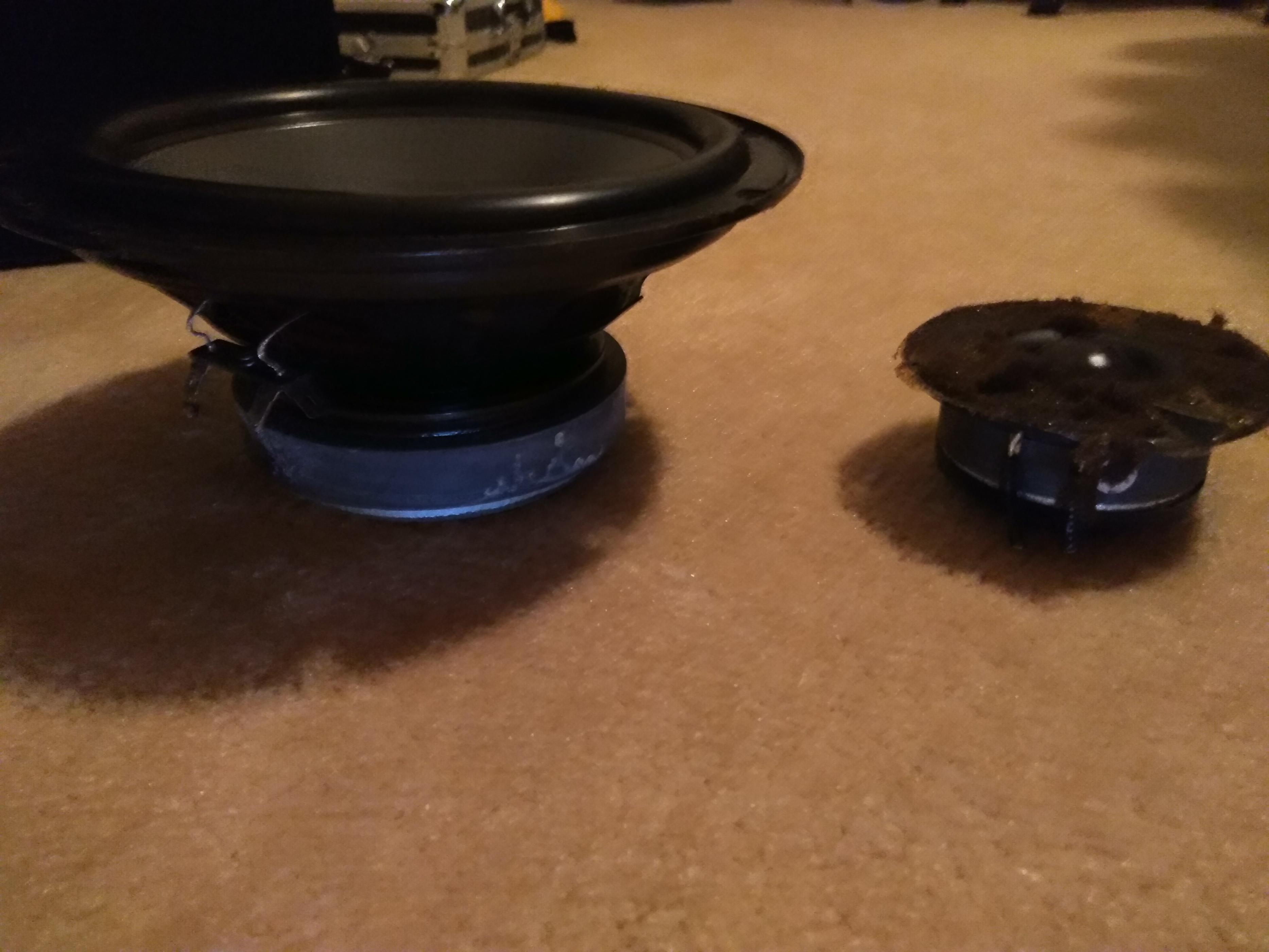

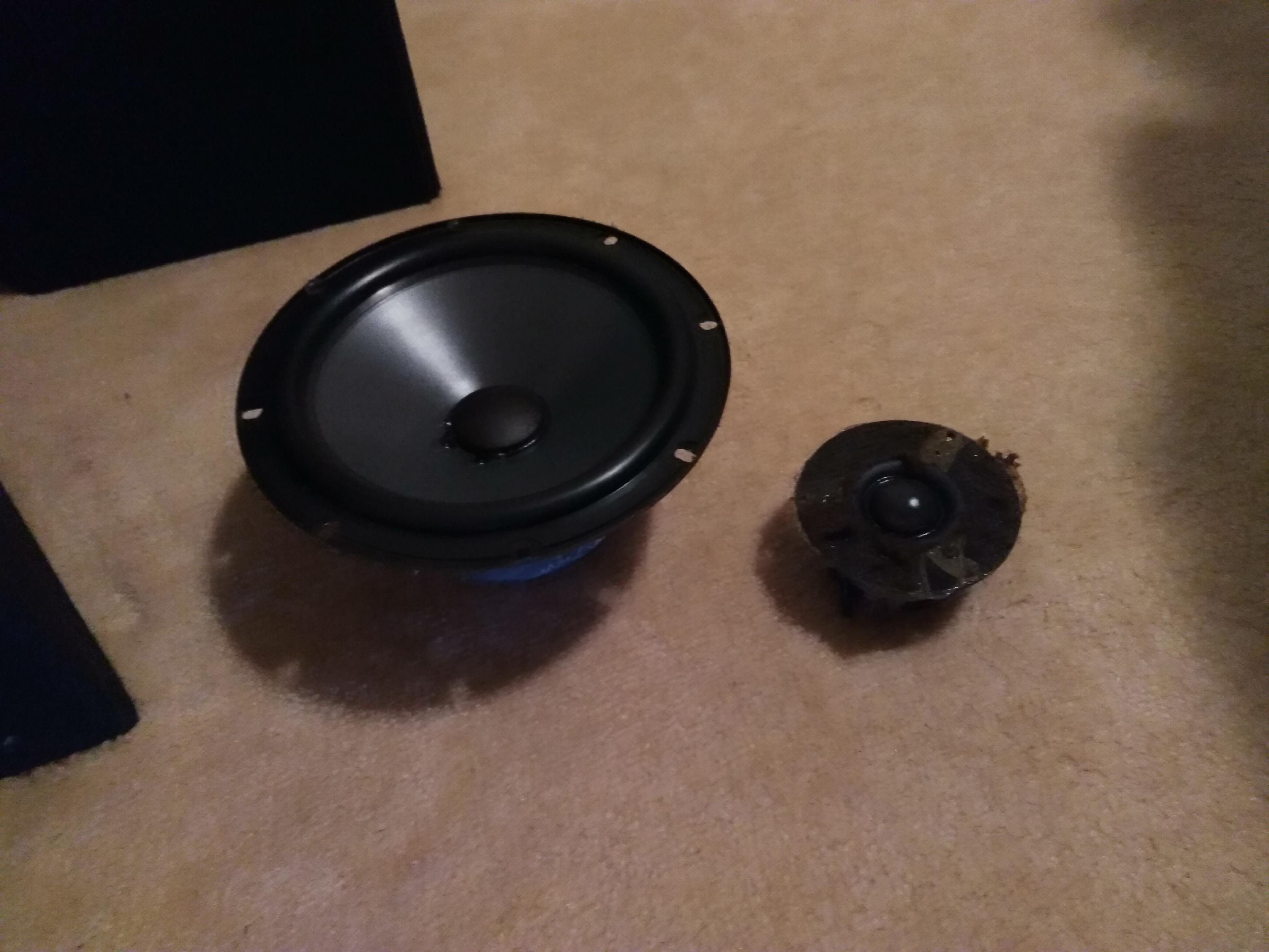

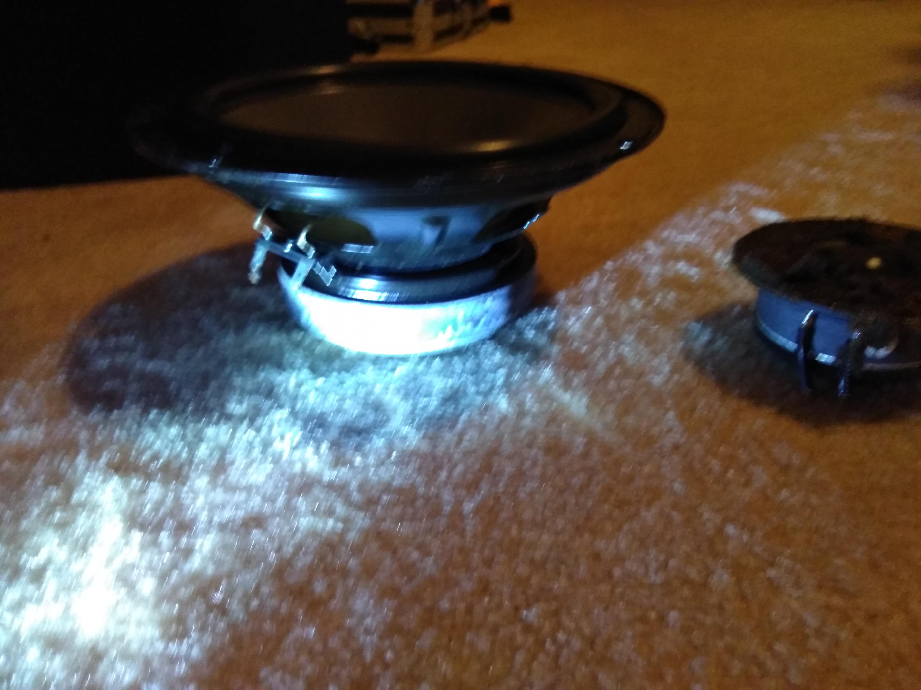

8" Woofer
Piston Diameter = 165.1 mm
f(s)= 45.76 Hz
R(e)= 7.981 Ohms
Z(max)= 28.77 Ohms
Q(ms)= 1.577
Q(es)= 0.6056
Q(ts)= 0.4375
V(as)= 37.02 liters (1.307 cubic feet)
L(e)= 1.738 mH
n(0)= 0.5584 %
SPL= 89.57 1W/1m
M(ms)= 21.04 grams
C(ms)= 0.575 mm/N
BL= 8.928
K(r)= 0.2177
X(r)= 0.4382
K(i)= 0.02695
X(i)= 0.6418
Tweeter
f(s)= 1023 Hz
R(e)= 5.212 Ohms
Hi Bob.
Know this is an older thread, but thought I'd ask. Are you sure these are Silhouettes, not Sonnets. It's confusing. The Silhouette original models are listed as having (2) 8' woofs and (2) 8 " tweets and I've seen some info on the Series II only having one tweet. What was the configuration on the posted speakers, and did they have the identifying tags on the back. Thanks
