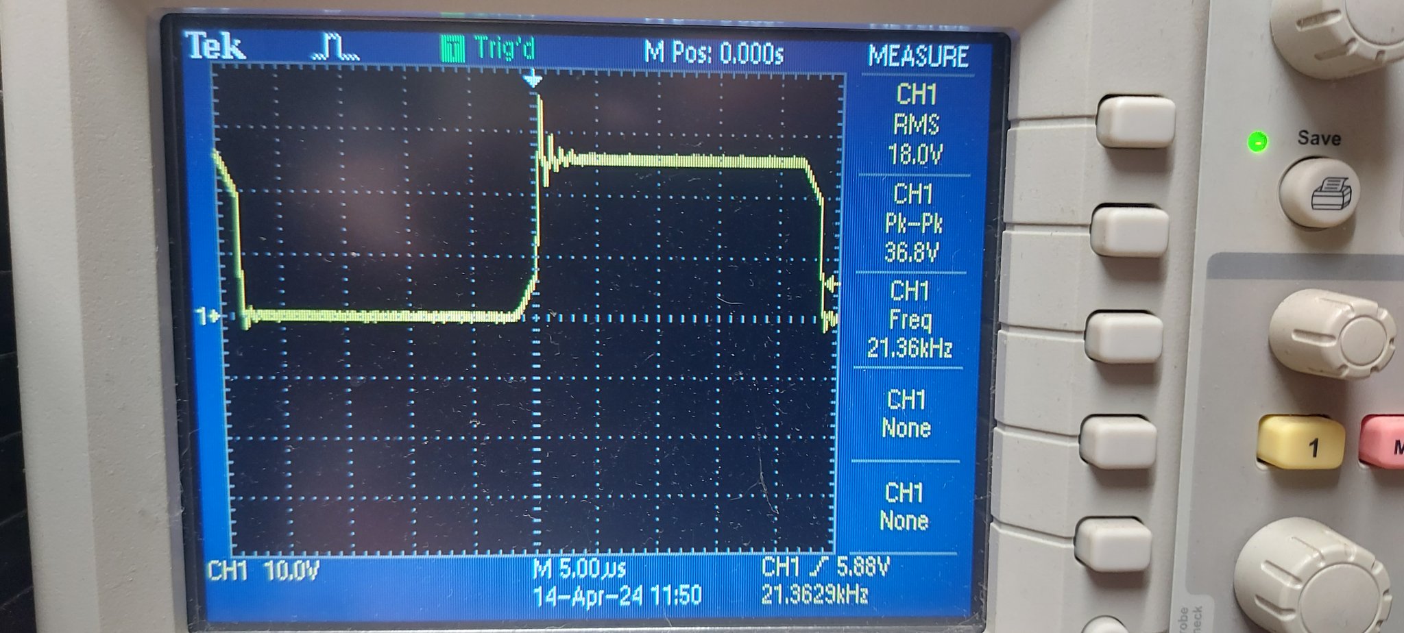

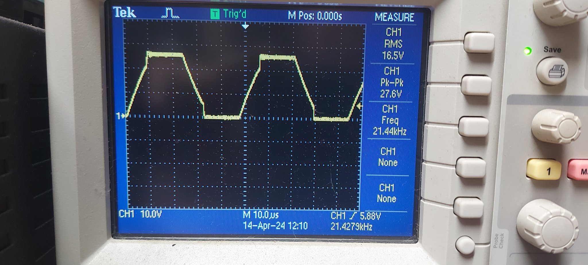

Good morning. Well, there are def some issues here. Thought maybe it was something in output section, so removed the outputs and rectifiers... cause on startup I could hear a loud "pop or click" sound from somewhere in the output section. The relays are at the end of the power supply. So not sure where it was coming from. Square wave doesn't fully form, transformer(s) squeal. Repeated over and over every time I tried to power up.
With outputs and rectifiers removed, the square wave forms... super slowly. Current starts out ok, then wave gets all this ringing at the front and current goes up fast. Like almost 10 amps in a couple seconds after wave fully forms. Probe is on the drain leg.

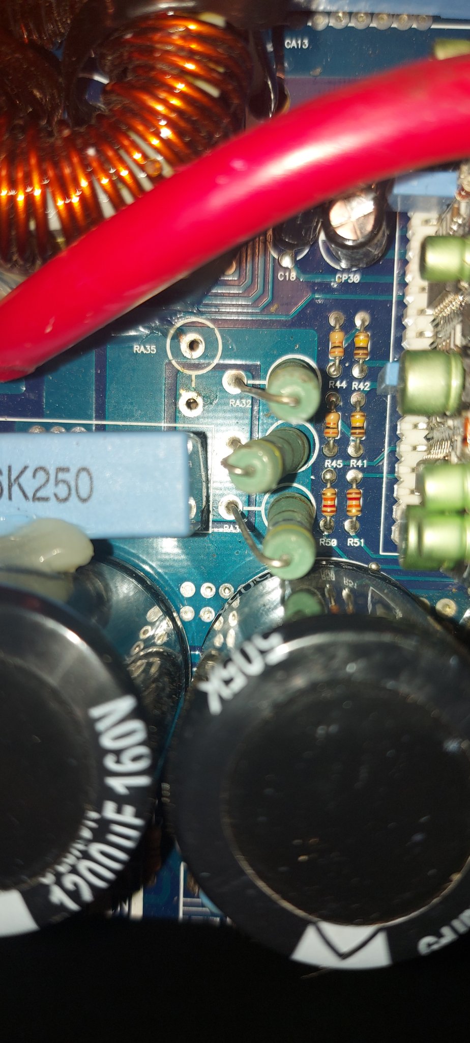

I did notice that RA35 seems to be missing. Not sure it's purpose. It seems to be in parallel with RA30, 31, 32.

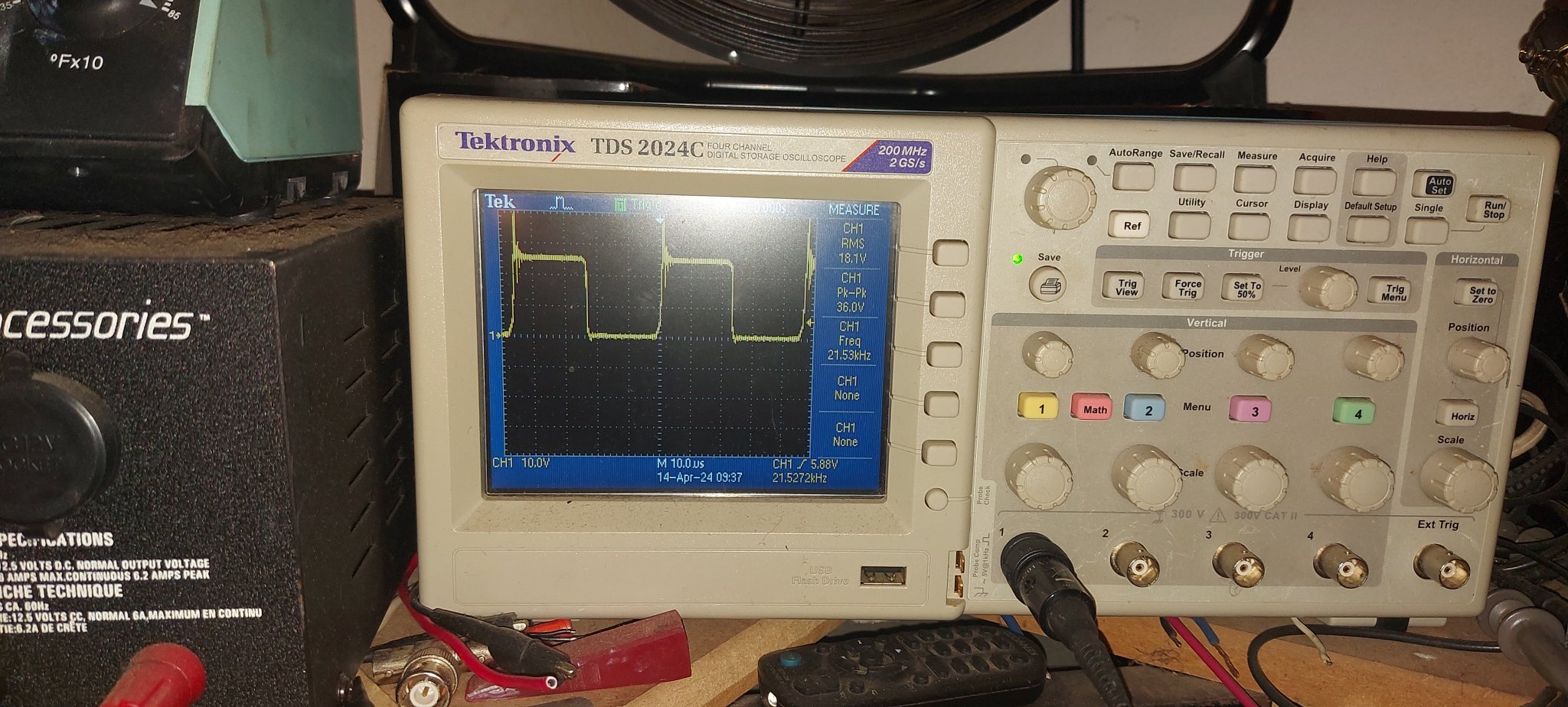

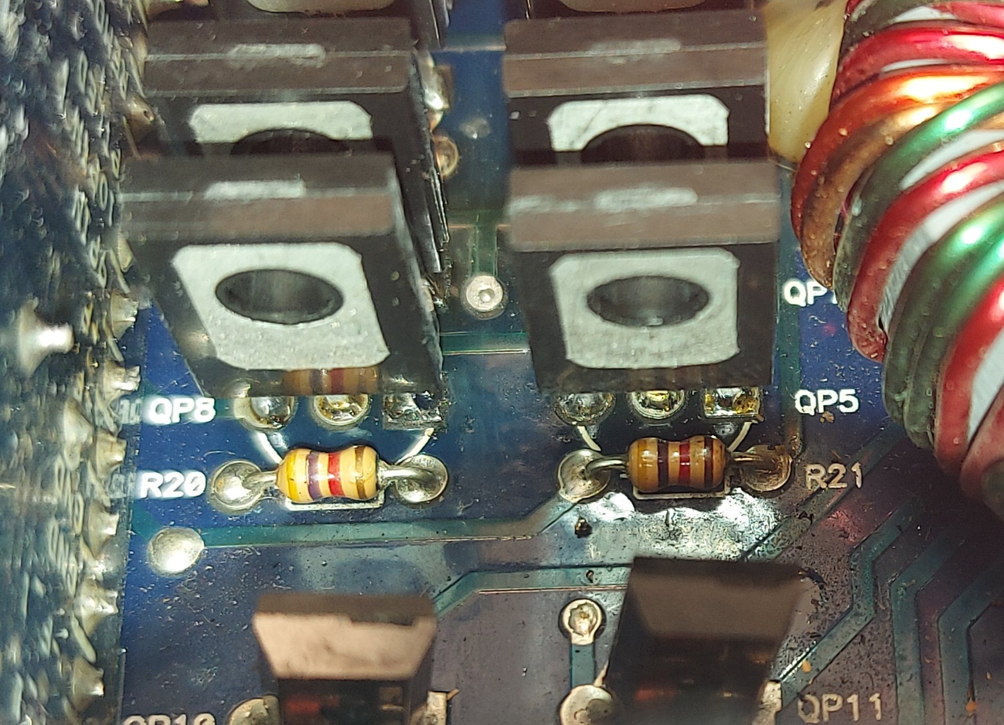

Swapped R20/21 to 1k resistors. Idle current is much better at about 2.5 amps after full duty cycle. 13v supply. It iisss slowly climbing though. About .008-0.024 amps per screen refresh.
Shall I swap the other side as well?
It still moves to full duty cycle pretty slowly. The output relays click before it's even at 80%

Without the rectifiers, the duty cycle is going to go higher than it normally would... at idle. You can swap the other two. The 494 can easily drive 500 ohms per output.
The soft-start is determined by CS9 and RS23 on the driver board. Check those if you're concerned about the time to ramp up (although it is likely OK).
