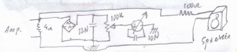

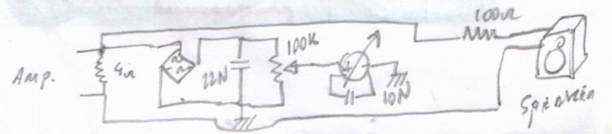

Good to find you...ATTENTION!.... i made measurements of power.
I was damned, because was distorting with 20 to 30 watts peak power.
So, i decided to make some changes, the peak power meter, having its own load resistor, and some series resistor to the Philips speaker...this way.... power was developed over the smoking resistor...and one small part of audio was going to speaker...this way, speaker distortion was not more possible....if i could hear distortion, this time, only the amplifier could be the guilty.
Was happy!.... 100 watts peak without distortion...and no more volume to be increased!......this is around 60 watts RMS each channel, both were driving....and the power consumption that was written in the amplifier back panel was not so wrong.... 125 watts consumption!
hehe.... Philips used cheap speaker.... it cannot hold the bass....but amplifier did not distorted.
So, i used my 100 watts, 15 inches woofer...and a very small distortion with full volume
This small System is full of power and good sound too.
Carlos

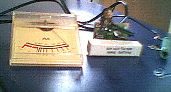

Meter was adjusted to 15.5 volts AC RMS to indicate 100 watts Peak
That voltage was indicated alike Zero VU metering... a little above the mid scale, where those meters are more precise.
And the voltage was 60 hertz.... over 4 ohms resistor....
The test frequency used was 60 hertz too, and after confirmed with music signal.
100 Watts peak!, no doubts, both channels driving...and 125 watts consumption specified.
regards,
Carlos
Well Mike, let me dream a little bit, and you came with that terrible reality.
Yes.... speaker is a very complex load, and resistor is an easy load....but we can forget...for a while...hehe.... to be happy!
I worked very well with the big speaker..... distorted much less...so....the biggest guilty is the speaker...always that "piston"....aaaaaagh!...i hate speakers!
