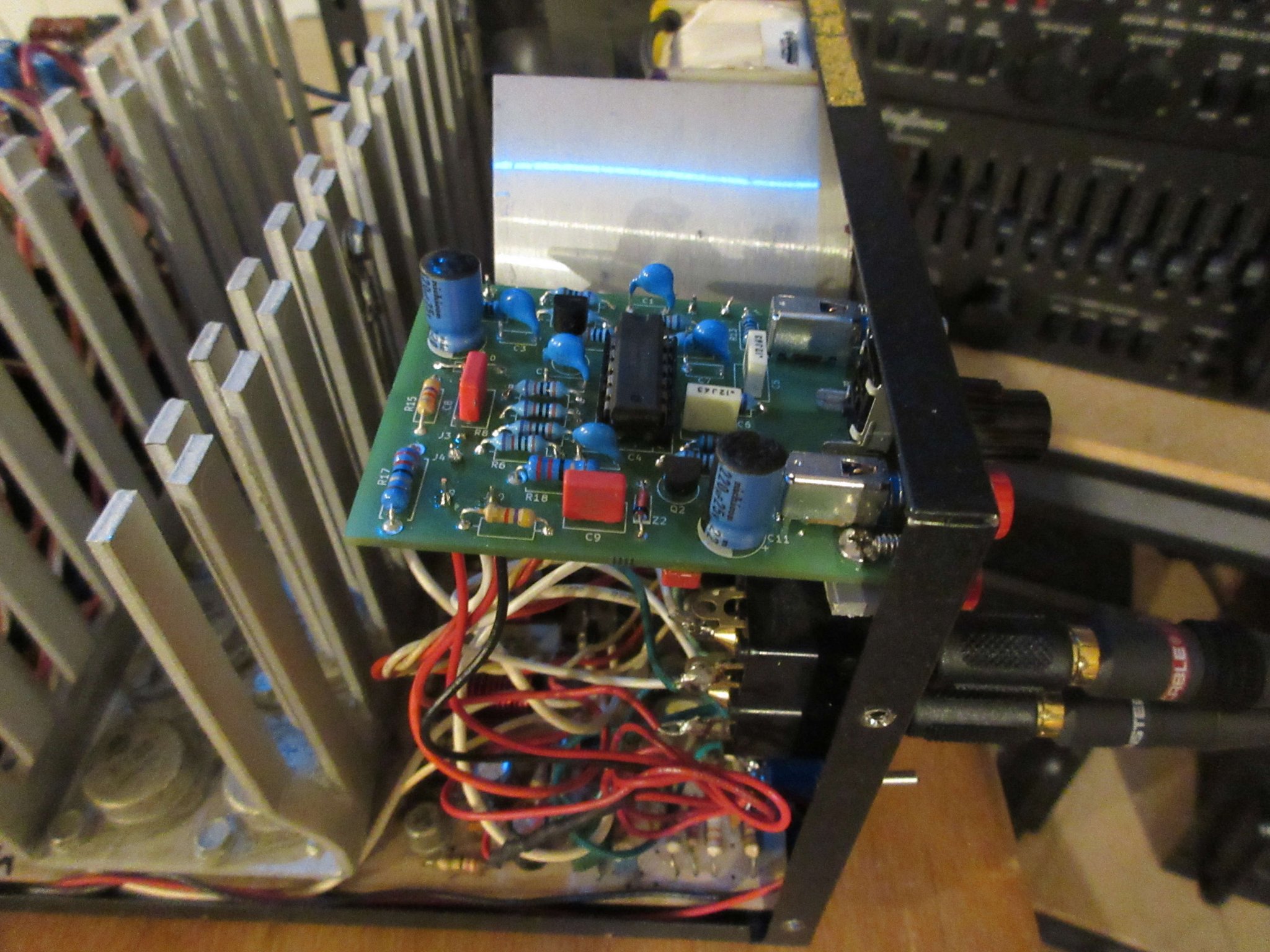

I have restored dozens of these amps. I probably have about 150 good used power caps in boxes. I recently modified these amps by designing an input board with switchable bridging and low pass filter with bass boost. The latest version has a muting delay circuit. Works good on bench testing, will install in an amp and try it out soon.
