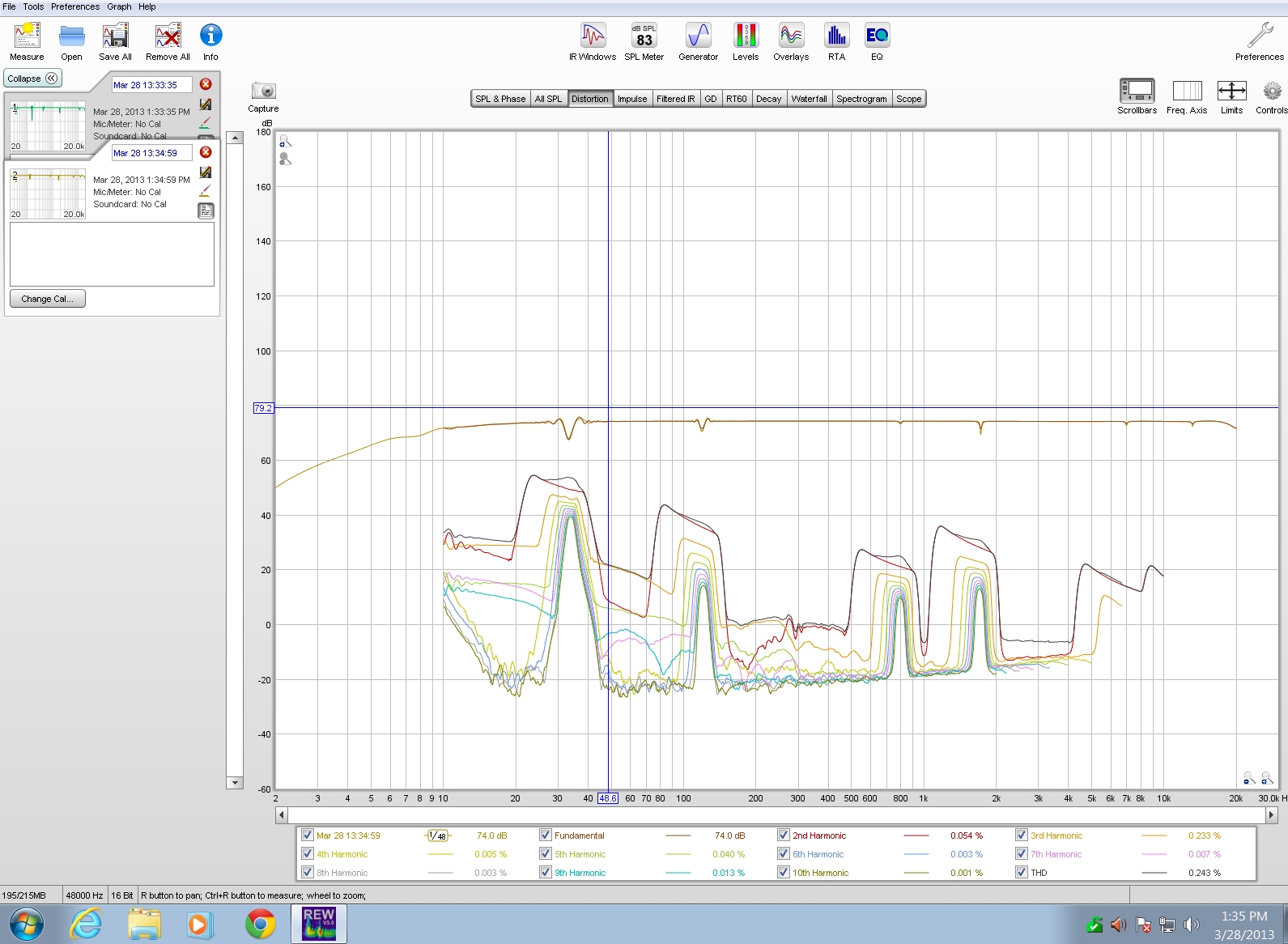

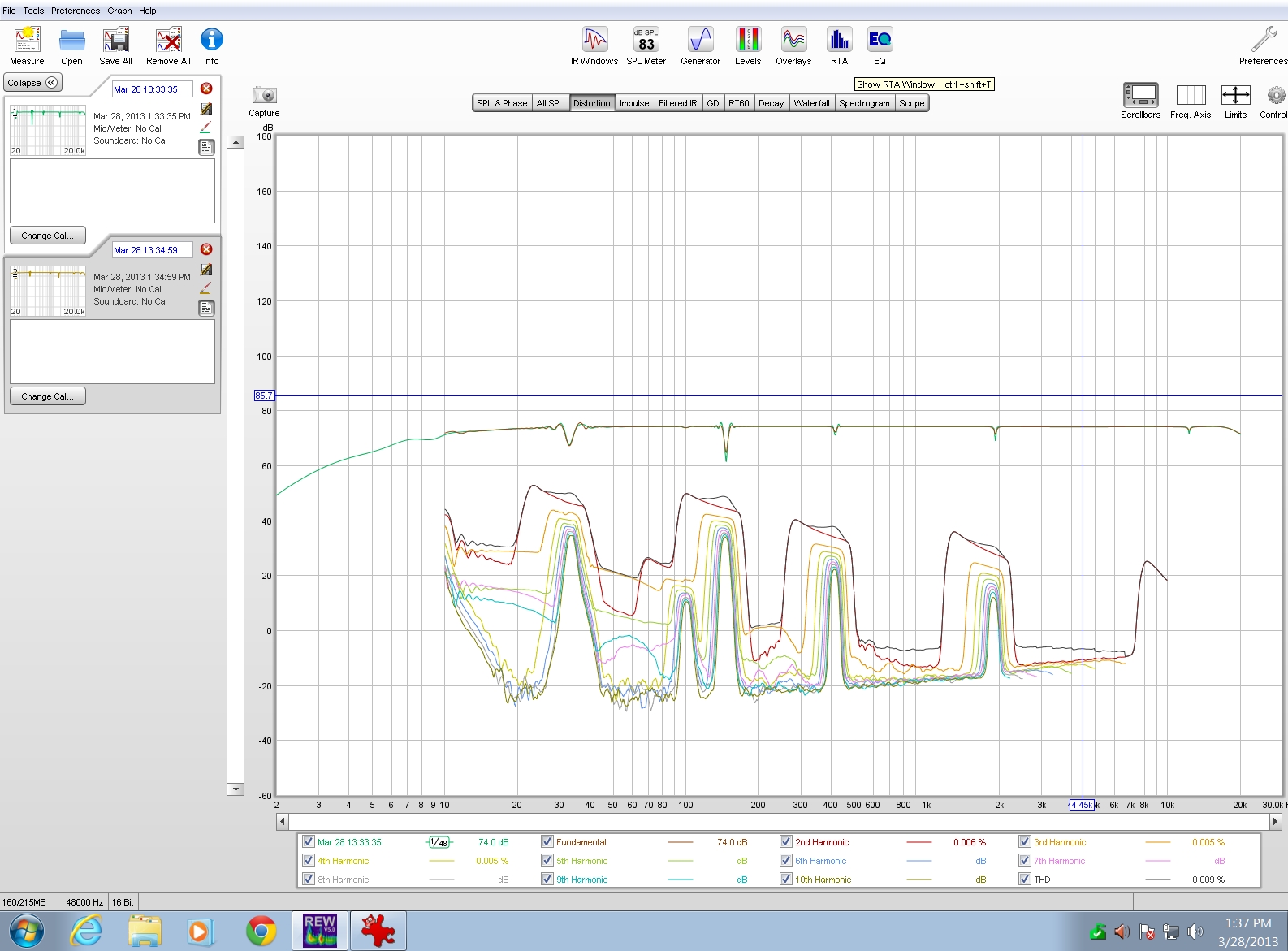

Then I did another loopback test and it was fine, But my Flakey ALC892's outputs keep glitching and I can see this on the scope.
Sometimes it works perfectly and sometimes it is just Flakey.
Posted is two tests that were back to back and the glitches are very random.
I am not yet sure yet if this Win7 driver issue or if the chip is just plain Flakey.
