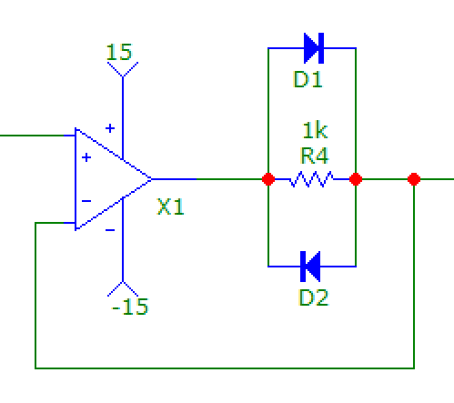

Not an answer to the question, a quick sketch of the test bed in post #19068 might help.
It's a low current model of a famous current dumping output stage. There is a huge increase in distortion at the point when the dumping transistors (or in this case, diodes) turn on.
The "THD vs level" looks innocuous, even the IMD looks "not so bad". But the circuit sucks. I've used this as an example of defect that does not show up "blatantly" on THD/IMD. It does show up, but it really doesn't look as bad as it should look. I mean, the output impedance varies in a non-linear way by a factor of 10 when output current moves a bit. It's terrible. Red lights should be flashing.
Anyway. I don't want to blow too much hot air, so when I build the setup and do actual measurements, I'll make a topic with detailed explanations of everything. For now, a quick summary:
This is a grown-up version of a setup I've already used and that worked very well, with the expected limitation of being a hacked together bunch of crap and clip leads.
The setup is designed to test an output stage in open loop (I'll call it the DUT), but it could also work on a full amp.

So I don't know of anyone using current dumping these days and that circuit as an output stage used open loop would of course behave poorly. They make fuzz pedals with similar configurations.
BTW the diodes are the current dumping transistors in the WW 1975 article, using the same amplifier for the low and high current totally defeats the purpose and just makes a very bad amplifier as well as no sense.
This is not the QUAD current dumping stage. It misses the balanced bridge feedback which was the whole point and makes all the difference!
