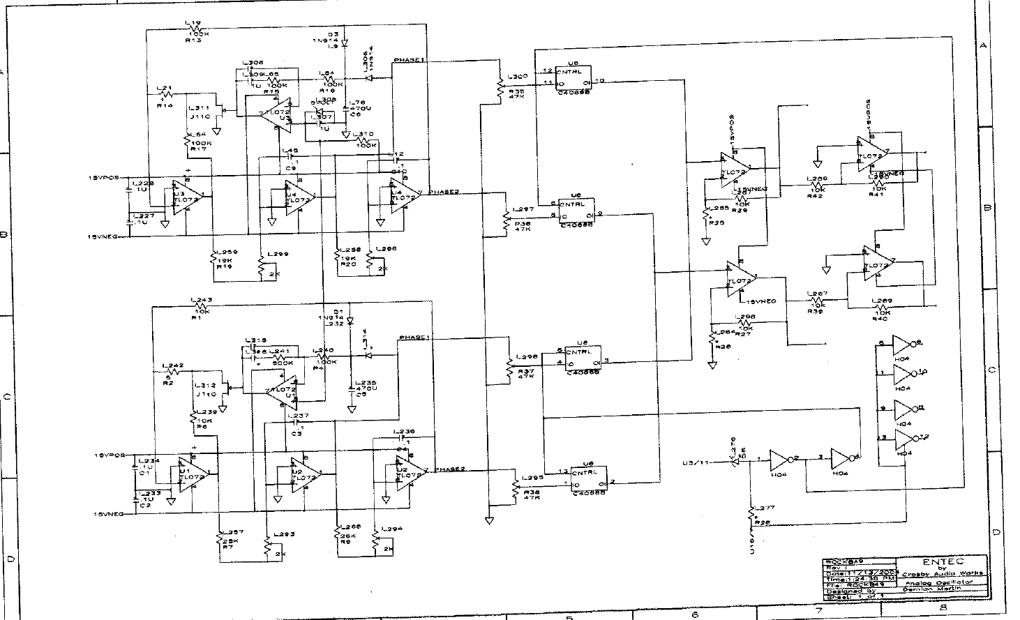

I never knew the Valhalla drive was single phase. Kinda cheap and nasty under the circumstances. I designed the first gen drive for the Rockport as a two phase drive which is really not hard to do. Just use a state variable oscillator. I also set it up to reduce the drive after about 10 seconds to the minimum necessary and made the two phases separately adjustable to minimize vibration. Ultimately you are limited by the balance etc. of the motor.
I have the drawings for the circuit somewhere and can share them if anyone is interested.

Here is a poor scan of the oscillator circuit.
There are two oscillators, one for 33 and one for 45. The trimmers in the oscillators are for frequency. There are also level trimmers for both phases and I used CMOS to select the speed. Its doesn't show the LME 3886's used to drive the output transformers.
I have another more elaborate variation that allows continuous adjustment from below 30 to 90 RPM and used with a 2 speed motor allows for 1/2 speed transfers. This was used in a system for Columbia/Sony to transfer old lacquers and disks from the vault to digital. That used a constant current drive to the motor so the internal flux was pretty constant as the speed changed. It worked quite well. It may have produced less torque ripple etc. as well but that's only speculation.
Needless to say these were not $500 add ons to build, but in volume they do not need to be expensive.

Many thanks sir! Nicely done circuit. I can get the jest through the unclear copy. That was enough though, don't worry about getting anything more clear.
Handling the oscillator change was inspired thinking. Why not? It clearly works in addition to "looking right". Too bad Linn didn't simply use your designs. It would have saved a lot of people a great deal of money and grief. Give something a cute name and call it an upgrade is a warranty dance they pulled off.

Turns out its cheaper than switches for caps. (TL074 is less that $1 in small quantity.) And you can optimize each oscillator. They are always on so a 10 second stabilization is not an issue.
