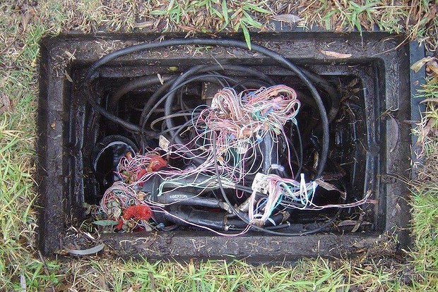

Do some research on Aus Telstra cable pits....Our cable is 1966 and is 4 wires of which only 2 are used. It was dug up when building out from the house. Housed in a hose pipe. It looks so bad as to be surprising it works. tI runs 5 computers all at reasonable speed. Seeing as bandwidth was said to be 2 kHz in the time installed it is doing OK. I watch films throught it.

Dan. That even looks like my grass, certainly the wires. If you put OX20 1NS into Google Earth you can see my shed backing on to the football pitch and the stepping stones to the shed. I am 3 rd house looking down the close. That's a bit of fun if anyone can be bothered. All the madnes in the well behaved world comes out of that shed. I think Google have my bottle green Golf Estate. 13 years old now.
