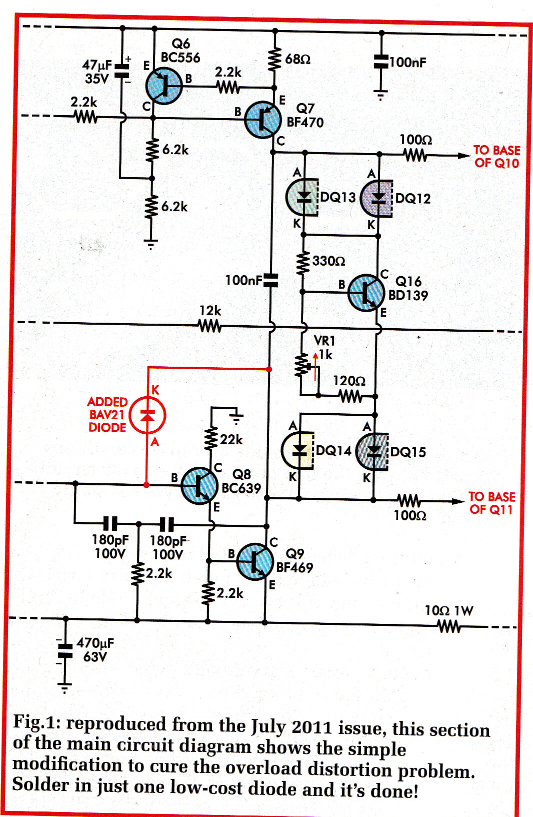

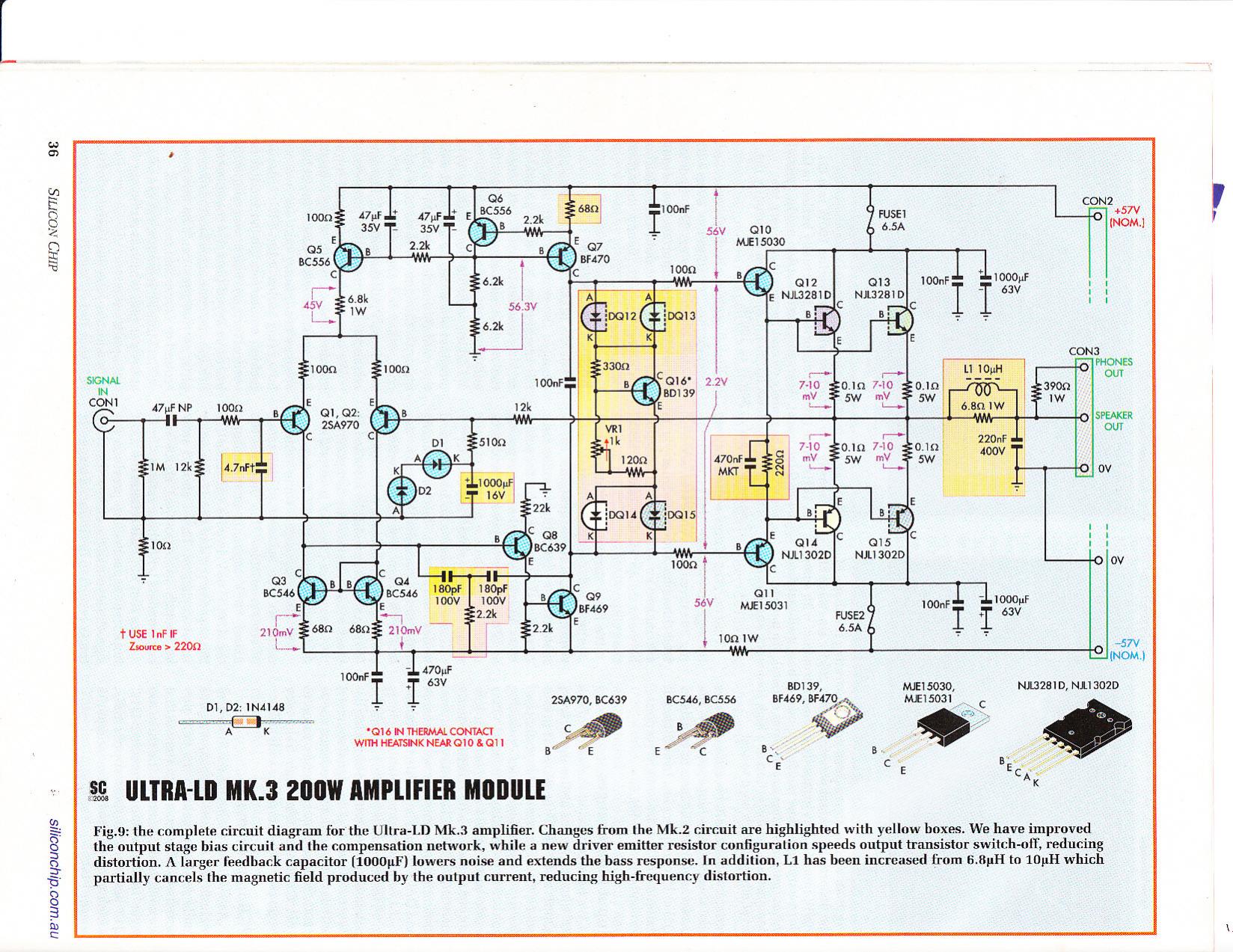

I understand that this was a general example only, but I would like to add that this can be much improved on. For example, what is shown as a CCS and left undefined, using appropriate BJTs would allow for considerably better PSU rejection. Adding a buffer transistor before the VAS trannie would very significantly reduce distorion and improve dynamic stability.
If I did it, I'd use a buffer transistor followed by a cascode for the VAS, to give it as much linearity as possible.
The real circuit plus a later modification to the VAS to prevent sticking under gross overload on signal input at 10 kHz. The added BAV21 diode forms a Baker clamp. Without this it takes 5-6 microseconds for the amplifier to recover to normal.
I have not build this project, however it may be of some general interest.

Yes, that's about how I'd do it, the only difference being that instead of a Darlington VAS I'd use a cascode, a bit more complicated to implement, but in my view, with several improvements above this. But no matter, this should work just fine.
