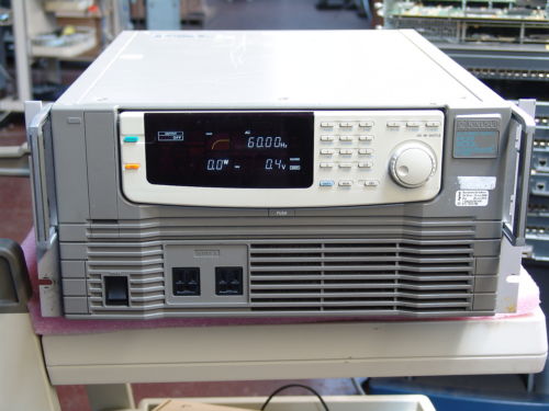

I have one of these....
Another more accessible method would be to use a sig generator, a soundcard or an MP3 type player to drive a decent power amp driving a step up output transformer.
Altering AC supply frequency, adding flat tops, distortion and noise reveals interesting stuff.
Dan.
A very useful (and seriously complex) machine, also power hungry !.Kikusui PCR500L General Information
Product Description:
Single-Phase AC Power Supply, 0.5kVA
Kikusui PCR500L Performance Characteristics
Form Factor Benchtop
No. of Outputs 1 o/p
Number of Phases 1 ph
Minimum Frequency 1 Hz
Maximum Frequency 1 kHz
Output 1 Max. power 500 Watts
Number of Ranges 2 QTY
Output 1/Range 1 Max. Current 5 A (1 V to 150 V)
Output 1/Range 2 Max. Current 2.5 A (2 V to 300 V)
Output1/Range1 Max Repetitive Peak Curre 20 A
Output1/Range2 Max Repetitive Peak Curre 10 A
Line Regulation, Voltage 0.03 mV
Maximum DC Volts 424 V
Maximum DC Current 1.25 A
