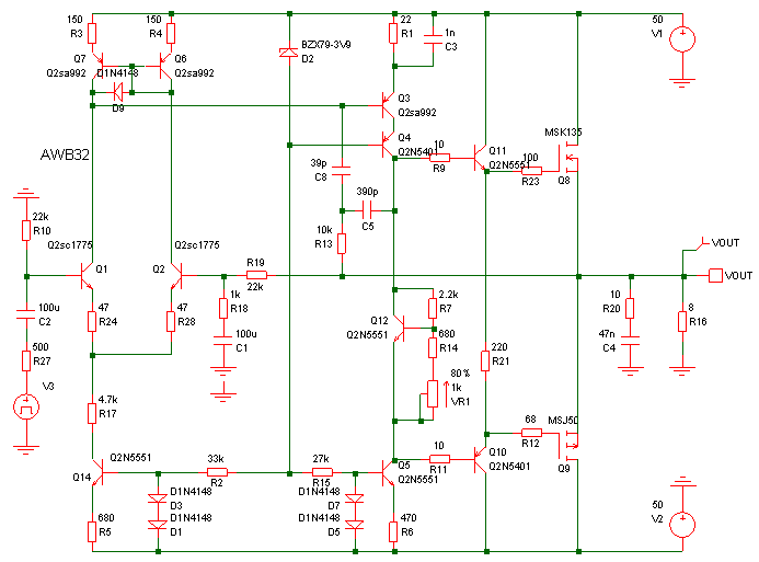

I may do some more work to see what the open-loop phase/gain looks like.
The two shunt compensation RC networks impedances are too low to ensure
adequate gain/phase response so stability is almost entirely on the
shoulder of the lead compensation cap.
Also , a single pair of outputs devices is quite short given
the high PS voltage , two pairs would be mandatory.
Not sure that this design was well thought in these respects despite
its designer s recognized authority in audio....

Given the results EB got I would not really monkey about much, expect possibly degenerating the current mirror and VAS a bit...

The two shunt compensation RC networks impedances are too low to ensure adequate gain/phase response so stability is almost entirely on the shoulder of the lead compensation cap.
Possibly not, check where the poles and zero's fall.
Also , a single pair of outputs devices is quite short given the high PS voltage , two pairs would be mandatory.
As it is an existing, physical amplifier this may less than feasible. Hence I recommended instead using the double-die TO-3 Parts from Exicon etc., which does mostly the same, but without having to change the existing mechanics.
Not sure that this design was well thought in these respects despite its designer s recognized authority in audio....

1) Double Die output devices (by far) at double the Iq.
2) Mosfet or high GM J-Fet with lowish capacitance for VAS Transistor (see Nelson Pass's Threshold FET series - 3N172 was used)
3) J-Fet followers before the input differential bases or J-Fet IPS (2SK246 or similar low Gm/C devices would do well) ibid..

Thanks Jan, not I did not know of that distro. That was going to be my research this weekend. I saw about 50 listed on the Berkeley page. Saves me some time. I never knew everything that has come out of UCB besides student rights until I visited earlier this year. Now it seems every other science article I read has some link to UCB or LBL.
D4 and D6 are there to allow quicker recovery if the transistors are saturated? So that is why one might want faster lower C diodes? Only matters if over-driven, right?
Still totally lost on the zero portion of R12/C5.
Or how C6 is calculated. I came up with 72K but that is a total guess that it is the 220p and 10K of R5.
[snip] D4 and D6 are there to allow quicker recovery if the transistors are saturated? So that is why one might want faster lower C diodes? Only matters if over-driven, right?
D4 and D6 prevent the saturation of Q7. The drive to Q6 is limited by the clamp on the current mirror output, as Thorsten noted, so it doesn't saturate either.
The distortion associated with the capacitance change with voltage on D6 is mighty small when considered as being in parallel with C3, so although low capacitance is generally good, I wouldn't worry about it at this point. One small caveat is that the specified 1N4148 is seeing some fairly high reverse voltage at very high levels, and the rating is 100V, but I've rarely seen any with quite that breakdown. Being gold-doped for speed iirc (and they are plenty fast for this application), the leakage current is not super-low, but again compared to 3mA it's not that much, especially at reasonable temperatures. There are some higher-voltage lower-leakage parts around, some old Fairchild parts (Fsomething-333?) but I'm not sure which are preferred and still in production.

It is inherent to the shunt compensation on VAS collector.
Increasing the CCS current is limited as this will increase
dramaticaly the thermal dissipation of both the CCS and the common
base transistor of the cascode wich are low PWR trannies.
As already said stability is ensured by the output LR network.
Without the lead compensation cap the amp oscillate even
without capacitive load.

If I take this correctly, I would be better off with something like 100p and 73K for C3/ R11 so I am not dumping a couple miliamps down R11 and I have enough current to actually charge and discharge C3?

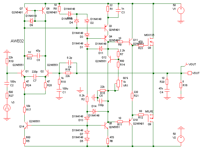

As for the amp , the sims i made so far just convinced me that a simpler
compensation and schematic would have yielded better results with
a better balance between stability and distorsion.

On his later designs, he eliminated R11 completely.
The input LP depends entirely on P201, 660K to as little as 20K . I used this as an"integrated" amp and replaced P201 with an Alps pot, a couple sets of inputs etc. I now understand two reasons to put in a nice buffer in between. For my learning experience, we can assume a low Z input.
On the multiple outputs, it would not be difficult to drill the heat sink to use two outputs. Some rethink of the board design could help the lengths of the leads if switching to TO-3P type packages. I would have bought them this time except they did not have the in-die zieners. D10-13 are a long way away. I hate taking current through the mounting hardware on TO-3 packages. Learned that back in failure analysis. I'll leave that until I have more than a bit more experience. Baby steps.

Your version is easier for me to get my head around, that's for sure. As yo have done this sim, I will try to copy that to learn the tool and the main reason, to learn how these puppies work. As I have mentioned, reading textbooks is a great step one. Nothing beats being able to ask a question. I really appreciate your efforts and the patience of the many on this forum.

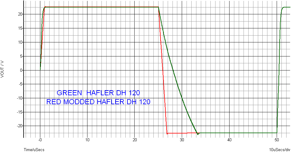

What would the sim say if you slowed down the outputs and changed R18 (23 on the mod) to 680 and R21 (R12 on themod) to 470? I am switching to the Exicon EC-10N16, P16 pair. They have half the gate cap. from the Hitachi. So the above gives about 1M for f3. Would I not risk some output stability with the 100 & 68? I am going to fly the gate resistors right off the socket.
150 on the CM emitters. OK, I was guessing 100. Actually, I happen to have some. How about a .1u across Q8?, or Q12 in the mod.
THose 2SC1775's sure do have a LOT more gain.
I gather the output network is a "typical" ?
You have moved the compensation to the output of the first and second stages into the feedback loop. No more big DC load on the VAS Do I look at them, C8/R13 and C5/R13 as if they were separate?
