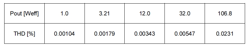

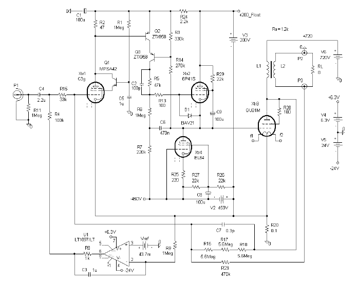

We may easily agree on engineering issue. But, can you post a link on a SE tube power amplifier that would not behave the same way? Lamm is SE, I believe that push-pull with tubes might be better engineered.
Frank Blöhbaum's designs in Linear Audio are tube based, SE and very high performance. If you know what you're doing, you can make great products in any technology.
Jan
Peaks compressed in 128kbps sample.
