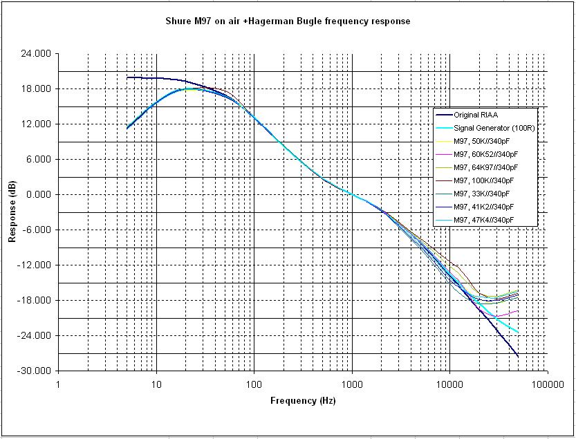

Or one may have a mismatch between the cartridge and phono stage. For example, if an Ortofon LM series cartidge has say half the capacitance it should have, 200 instead of 400 pF, this will cause a hump, a rise of 3-4 dB in the 10-20 kHz range, which will accentuate noise and may subjectively sound a little shrill.

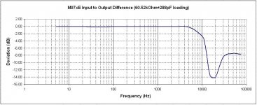

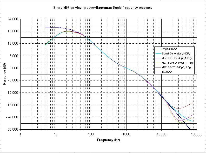

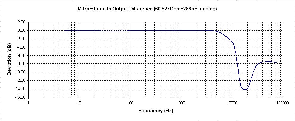

When I was working on Shure M97 (1.55kOhm, 700mH ) I found that capacitive loading was affecting the frequency response but only above ~15kHz. Resistive loading was effective from 1kHz .
Test set-up: Signal generator (100 Ohm, 4.9mVrms out) in series with M97, feeding a Hagerman Bugle 1 RIAA preamplifier.
Notice the damping of the response above~15kHz when cartridge tip is on the vinyl groove (compared to the on air case) and also the change of this damping with tracking weight.
:)It is to be expected that frequencies where MM cartridge loading optimization show up, are a function of the resonance frequency of the particular cartridge.

Very possible George, I mentioned the 10-20 kHz range more as a precaution, I have no idea how other cartridges might react.
