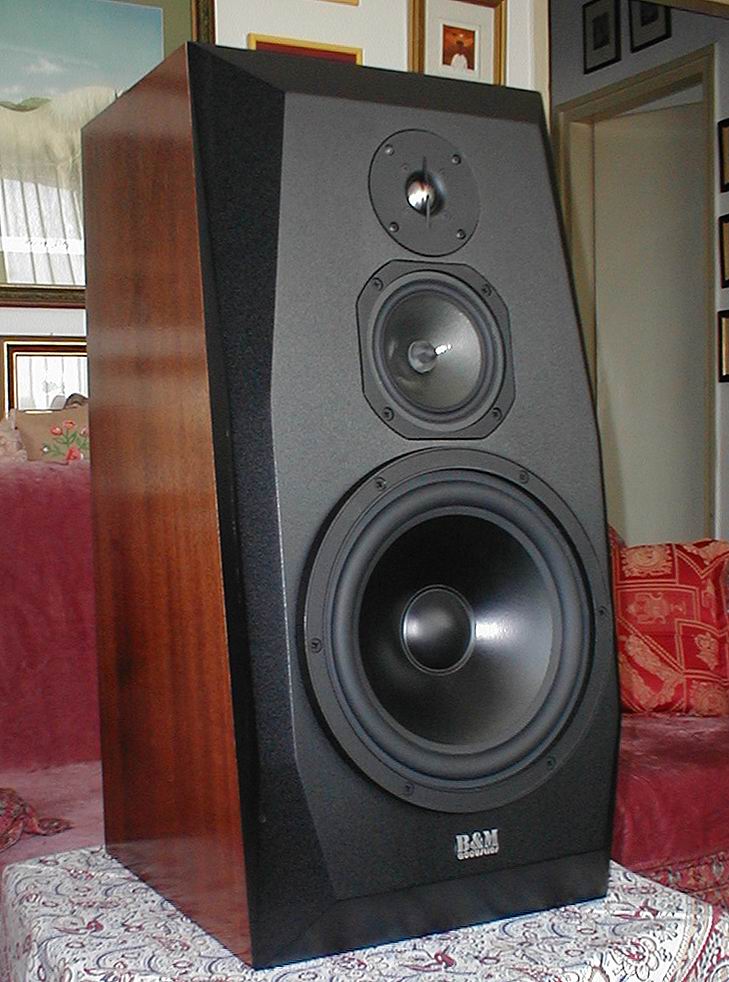

I believe in it so much that I spent literally months with a friend developing my own current speakers to the point where they would do 40-18,000 Hz +/- 1,5 dB at 102 dB SPL at 1 m. That is the limit of very good professional tape machines at 0 dB VU. If I use industry standards of +/-3 dB, the response would be 36-22,000 Hz.
Then we used up another few months ironing out the crossover network. All told, it took us just under a year to get it just right, although I must add we didn't decidate entire workk days to it, after all, we had to earn our normal income.
The end result is a speaker which, given a good amp, will disappear, meaning you are not hearing the sound from a box with 3 drivers, the sound is there in the air, outside the boxes. How good depends on what's producing it.
It is, of course, not perfect, but it comes damn close for me. For the money and in view of what it needs (that I know of), it's fantastic. To get that sort of sound from a shop, I would need speakers costing five figures, be it $ or €. And my bottom line was €1,200 in 2002, although this is really a false figure, as it doesn't include the real world cost of our research and work. But that was its official sale price.

Kastor, I did it for myself, for my own use, and because the man who did much of the development is a good friend of mine. He was the co-owner of a speaker manufacturing company, not I, I never regarded it as a business proposition and never expected to make any money from it. I stuck firmly to what my own company did, nothing else, which are power line filters and headphone amps/preamps (if only two inputs was enough).
The other guy is the kind of friend I'd walk on fire for. I also helped him out in video editing, he is an avid scuba diver who has won the Grand Prix for amateur underwatr photography three time in the row. You see what I'm getting at: we were even then past the give-take relationship, we were and still are firends for keeps. That kind of relationship is very rare, I have just one more man I'm that tight with. Like brothers, you might say.
And that speaker took off, too. Exports started, he had people actually driving down from Belgium to take their speakers. Unfortunately, his business partner had a near fatal motorcycle accident, which left him completely paralyzed except for his little finger on his left hand. Things went south from there, and the company was soon dissolved. That's why I cannot put a link to it.
All I can do is show you its portrait.
