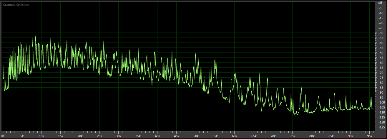

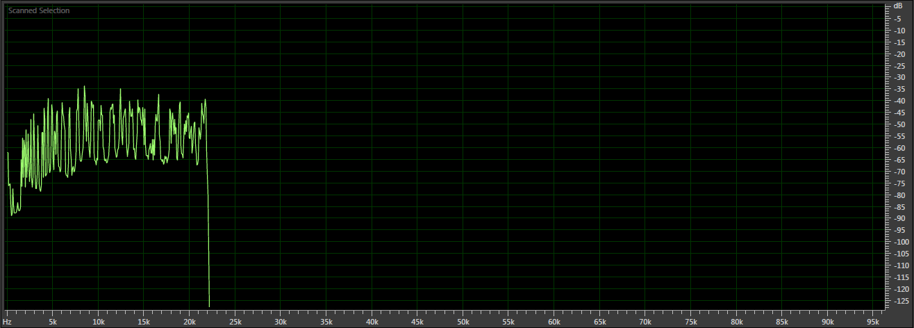

Regarding test sensitivity, that can be handled in different ways, depending on what the question to be answered is.
I'm working with a fe friends on a test to establish the audible difference (or not) between 'CD bandwidth' (20kHz) and 'SACD bandwidth' (up to 50kHz).
We have prepared musical instrument recording fragments that contain energy up to 40-50kHz, as well as a version where everything above 20kHz is deleted.
We will assemble a large group (30+) and present them with musical fragment pairs and ask if they are different or the same. All double blind of course.
Question is, how do we establish a baseline? Cut the bandwidth progressively until the difference becomes clear to everyone?
