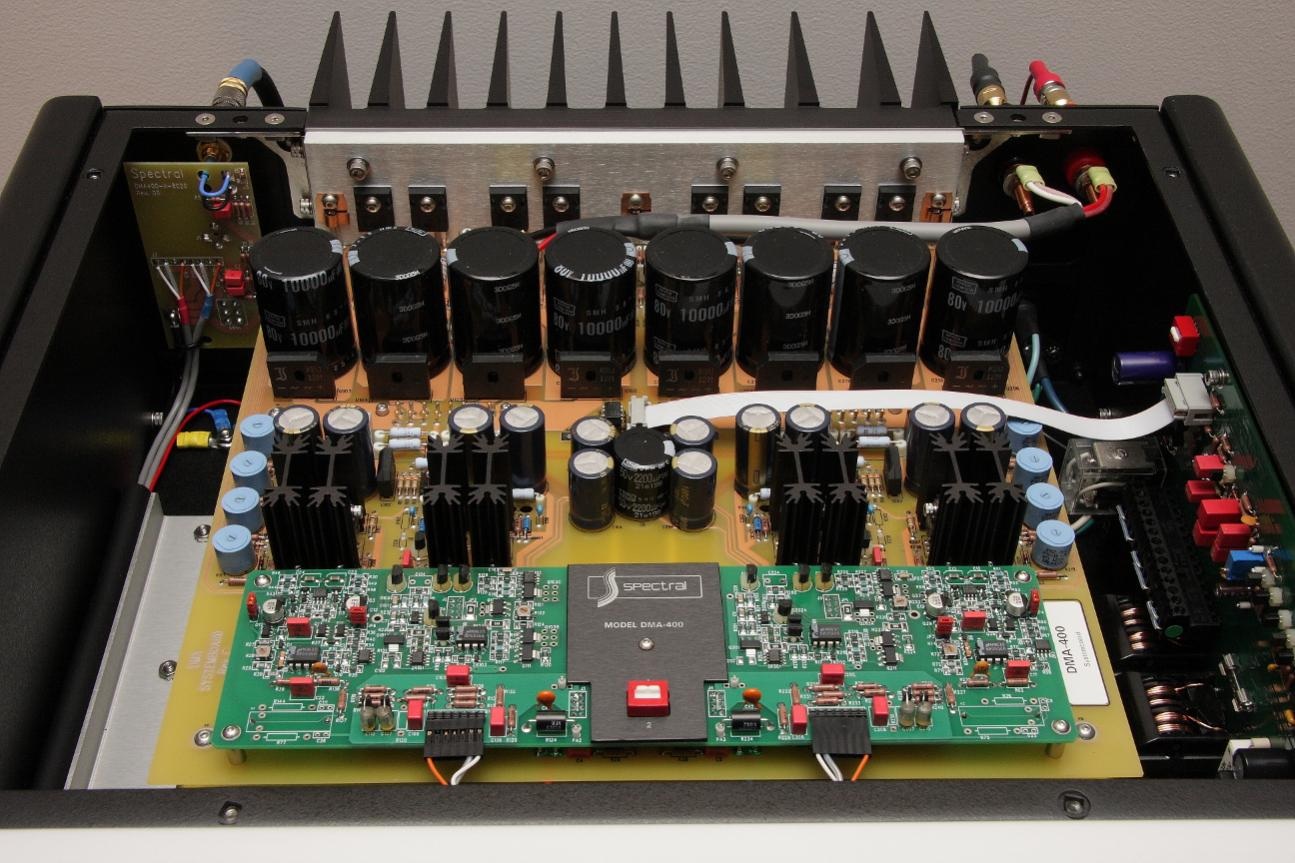

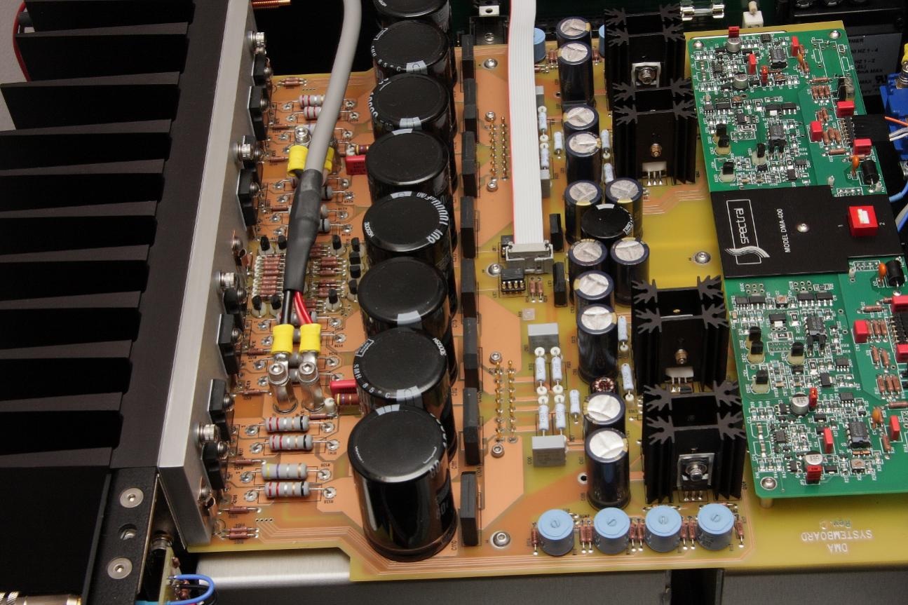

Power numbers are vastly over rated vs stability and guts, what gives an amplifier life ? The BAT VK500 was (250w/8ohm) as dead as nails @ 4 ohms or on ML/ESL's (embarrassingly bettered by an adcom on these) vs Levinson 27 or Krell ksa-80 , yet both had less than half the 8 ohm power and yes Nige it was bettered somewhat by the Sunfire amp.
Spectral has a lot of life too and very meager (comparatively) in the output stage and SOA , yet music .. :confused:
NP over builds and i have never had one issue , nada, no failures on any Threshold or his PASS stuff, that's over 25 yrs. Spectral focus is wide bandwidth , the others to some extent , but with brute force PSU, is there a magic formula..?
I can only suggest what works after trying most of the farm, even if only doing 25w/8R..
Spectral .....
