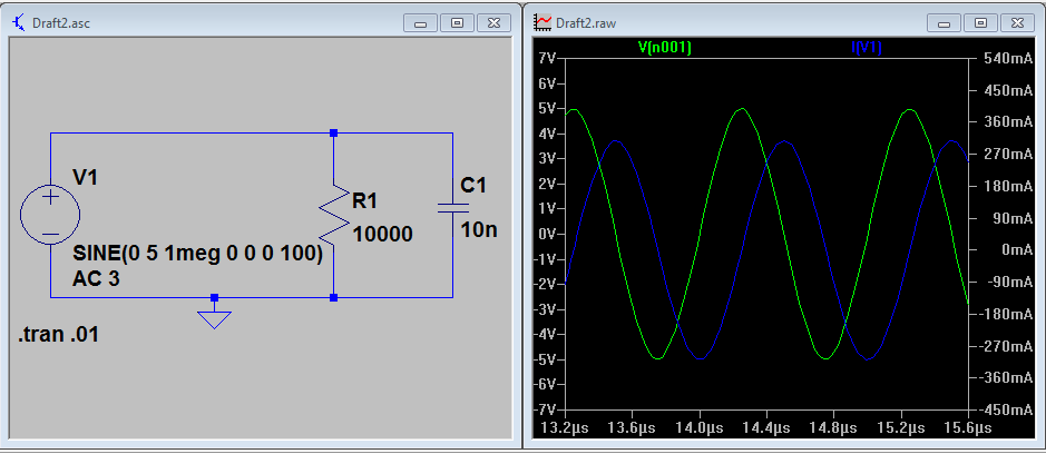

DVV:
Your input follower is single ended, fine for a low cap load like this. Make the R in the source of the lower FET adjustable as an offset trim. Driving a pot you will need to get the offset down or you will get a number of issues (pops, breathing noises, contact degradation etc.).
12 dB of feedback may be a bad place. The anti-feedback crowd has measurements of distortion multiplication in that range. As I remember the problem is worst in the 10-20 dB range and goes away at higher feedback levels. I'm sure someone here can point you at the sources for this.
My concern around Darlington connections is getting both transistors switching on and off quickly. In this case its not such a big issue with a small but capacitive load. However the original circuit with no follower can't have crossover distortion (at least from the usual causes).
Below is a quick simulation of what is required to drive an IHF load (10K in parallel with 10 nF) for a preamp at 3V 1 MHz. Its pretty extreme but does highlight the issues. The peak current, 300 mA happens at the zero crossing so its maximum stress on the device. Its also where getting those minority carriers in and out is hardest.

As DVV points out a big power supply and lots of transistors won't necessarily mean lots of drive. I would look at the voltage and current waveforms into a speaker at worst case before making any decisions about what is needed. The example above transformed for a speaker near a driver/crossover resonance could be really difficult to drive as it is all reactive. Reactive loads are where the transistors can't respond nicely. The VAS is near zero, a low current point and the load needs max current so the base drive goes to max and the VAS is not there. Even with a Darlington the issue exists. It suggests overbuilding at places that are not obvious.

Points taken, Demian, as I said, I literally slapped that together within an hour, not mcu thought invested. But of course, this is not to say there won't be. I am intrigued now.
On the graph, I note you used a 10V peak to peak signal. Is that much really necessary, or was that just for example's sake?
As for the point of your graph, now you see why I used Motorola's MJE 15030/15031 (140V, 8 A, 50W, Ft > 60 MHz) for my headphone amp/preamp, while the BD 139/140 were used as drivers.
On the crossover problem - I used a bias of 85 mA in those amps, which effectively made the whole range of voltages required for most cans a strictly pure class A affair. BUT, that also forced me to use an unusually large heat sink for such a device, and it wasn't amiss, trust me, no mere "if you've got it, flaunt it" affair.
On the global NFB. I had the same problem then as well. In general, my experience seems to suggest that having too little global NFB is not the best of solutions, and thus far, it SEEMS to me one should go for the 20-26 dB range as a very probable optimum (assuming other criteria are also met).
Thank you, Demian. I'll play with it a bit more coherently tomorrow, just to see how I fare, and get back on it.
