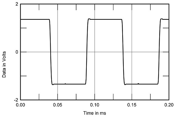

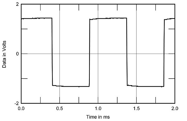

Square?? third order in the 10khz rise and not flattop at 1khz
I don't understand the rise/fall curvature on hte 10khz signal and the |100mV| or so voltage rise on the 1khz signal, there is also an overshoot leading edgeI suspect they have the usual creative definition of "zero" feedback. A couple of obvious thought questions. What bi-polar output stage at any bias level has a ppm level open-loop transfer function? How do you make an arrangement of bi-polar devices have a usable well defined temperature stable gain with NO feedback (which includes degeneration)?
Ok my guess is it is a feed forward amplifier with some sort of quasi-dc stabilization;

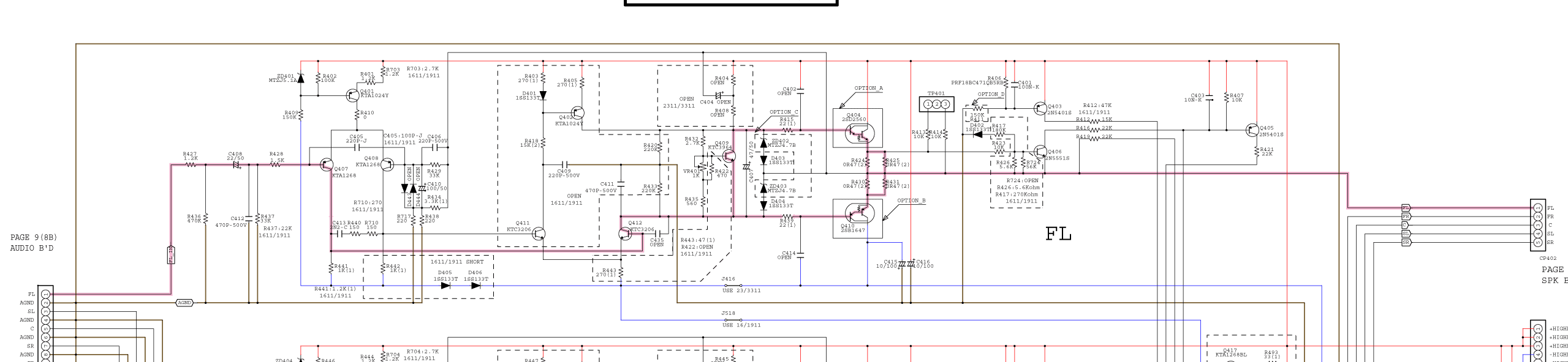

There seems very little uncommon about this amplifier, except, both gain stages have resistive loading which limits the open loop gain quite significantly over unloaded conditions. Sadly it does not really help linearity, as degeneration may have been a better choice.
Interestingly this is the one common feature with the Rotel Amplifiers tvrgeeks wife tolerates...
Ciao T
Here is the Denon amp schema. It's large for detail so you may have to scroll around.
Ciao T
