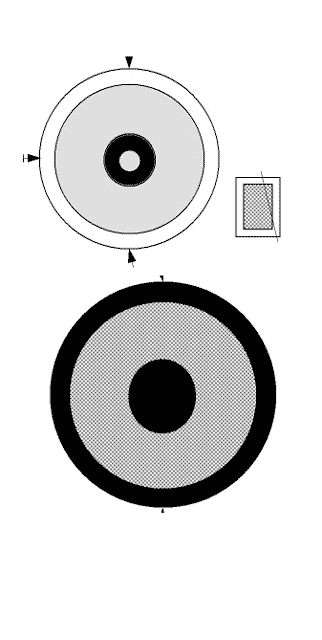

Below is my take on the baffle. Not based on scientific calculations, I'm afraid, just on experience. That's how I'd do it, anyway. You'll want to add shallow wings on the sides. Asymmetric if possible.

I think I have come up with a cheap solution to baffle resonance . The only problem is a simple support to magnet clamp . The seal is anything you like . If the drive unit is proud of the baffle even an existing baffle can be used . I hope this obeys Newton's cradle principles whilst offering genuine and cheap advantages . I guess in 1930 already done ?

Thanks for baffle idea . Wings are also feet which is good .

This would kill two birds with one stone . It makes bracing it easier and offers front support . If an attractive hoop was made the diffraction should be minimal . The next step is to make it more practical . The advantage I see is if two supports they could be adjustable . For initial tests even cardboard will be giving an idea for the baffle . A front support also if you like . The bolts could have wood dampers around them ( or whatever ) . Concrete slab from the builders merchant . Slate when perfected perhaps ?

The top of the "support", previously labelled "bracket", wasn't a good idea in the first place, and is superfluous now. If the cantilever "support" should be stiff, triangulate to the bottom, as Frank suggested. Attaching speakers front and back to the same support is problematic, too, unless the aim is to stress the basket.
