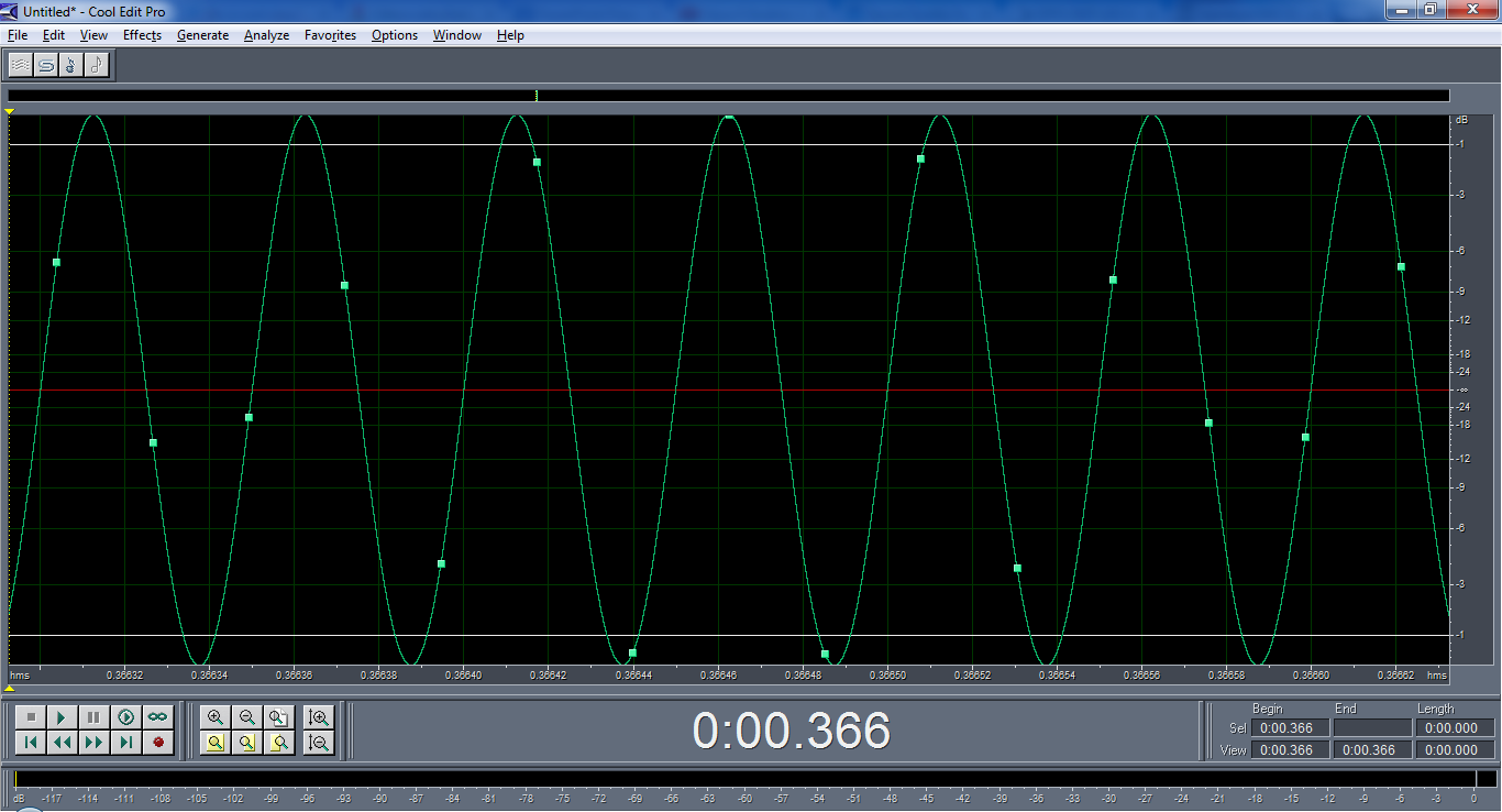

first. you said it yourself that slew-rate is not necessary because it exists in music. how come you also used the slew-rate (more below) of the signal present at the input as an argument for the fact that CD is wrong?
second. can you explain the "44.1 / 2" thing? a perfect (in the mathematical sense) step requires infinite bandwidth. that waveform looks like an amp with ringing because of the Gibbs phenomenon. had you seen no Gibbs, it would be really weird and definitely abnormal. a square wave can't look like a square wave (given you zoom in enough) if you band-limit it. you see that ringing because a perfect step would need infinite bandwidth. and because (as far as current science goes) human hearing does not require infinite bandwidth and RedBok is based on that.
third. with CD you can have slew rates exceeding what is naively suggested by the inter-sample delay. actually, ~3 times larger with RedBook. incredible as it may seem, with properly implemented digital you can actually have all the slew rate that a perfect (again, in the mathematical sense) full scale 20kHz sine needs. it all depends on the implementation. maybe you don't believe me, I'm attaching a screen shot of a generated 20kHz wave in CoolEdit. look at the green squares: those are the sample values. nowhere near sine, innit? in fact it's "oh my, what is that rubbish!". then look at the continuous line. I'll be... a sine! how do you explain that? sinc interpolation, that's what you're looking at.
now... if you tell me that there are psychoacoustic reasons why a LPF @20k is not enough, you do have a case. if you tell me that the reconstruction filters are not always perfect, you do have a case. if you tell me that dither can be a bad thing if done uwisely, you do have a case. but that's totally different from your arguments above.
it's incredible the amount of times we can go round and round and round in circles with this.
of course, all the above is accepting that we don't move within the paradigm of "I still believe it", because, if that's so, we could as well just close the whole forum.
