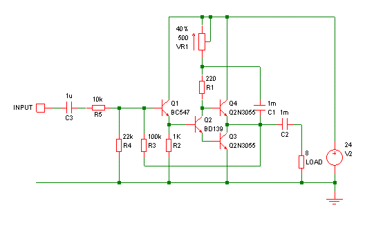

The point is we lost a lot over the years . Bootstrapping almost abandoned . Here is a conventional feedback amplifier . Except it is far from conventional . The transformer I find has undreamt of performance . The idea of using the transformer as if it was a gain stage is very clever . The output stage as in bootstrapping provides the power to drive the circuit . The big downfall of this circuit is the availability of the output devices I beleive . I have some very disgusting fet's and a mains transformer . See how far I get .

I said something previously that was not uniquely true . I said the Pass amplifier used the output stage to supply current for the feedback loop . Well that is always true . This time I feel the significance was rammed home to me .
Here is a design at the point when it worked . A voltage doubler PSU was added later to get better output ( driver ) . It was disliked and used at below rail voltage as a clean supply ( rail - 2 V ) . Note how ridiculously small the bootstrap is ( 2 u 2 ) . The point is , it was enough . 10 uF was then used as a small increase in distortion could be see at 1 kHz ( not below or above ) . The point is the loop gain of the amp was enough up to 1 kHz . None of what you see was for other than for me to read , it's just my notes . It is a mixture of designs I like , Hitachi , Leak ,JLH . The output into 3 R was great ( goes into AB ) . The output capacitor ( 4 x 1000 uF non polar ) was so as to be certain it was OK for DC offset , I never had a problem . The MOSFET's were marginally inferior to a complimentary feedback pair . The difference was by deduction cured . The 50 kHz graph was the design goal . All graphs were identical down to far below one watt . Note the biasing of capacitors . < 400 mV would be ideal . The transformer in the Pass design usefully avoids that . I had no J Fet to try .
Note there is no significant distrotion of any kind . OPA 604 with complimentary feedback pairs was marginally inferior in measurements and sound . What I suspect is buffering an op amp is not 100 % what one would hope for . It was close run . One criticism , 0.7 A is above the optimum for this FET ( 0.1 A ) . It is OK . An A/AB bias resistor ( < 470 R ) would have been interesting for listening tests . I suspect AB would be more punchy ?

I think I said before , the capacitor is simply so as not to loose the experiment during tests . Interestingly the least obvious sound impediment was the output capacitor . I couldn't measure any real distortion from it . Most of my listening was done without it . If you look it is a non polar cap . If wanting a cap I would have used the old style PSU .
The amp started as a speculation about repairing a stack of Leak Germanium amps . I decided to build something new so as to know as much as I could . The FET's almost mimic the Germanium's in many ways apart from speed . If I remember correctly the Leak Stereo 20 was TO3's on a bracket . So just a simple rewire and resistor bias ( get rid of Darlington half ) .
I learned a lot from this .
1 / I don't like single VAS for it's lack of symmetry . No amount of current fed into the VAS cures it . 10 kHz is OK . Maybe this is why we see the need for ridiculous slewing rates ? A one legged cyclist always has difficulty .
2 / Single input stage is not obviously more stable ( folk law ) , those of the past that were had high capacitance transistors . If a BD139 is substituted then perhaps no VAS cap needed ( it worked with considerably more distortion above 10 kHz ) .
3 / Playing with the VAS emitter resistor can reduce distortion !!! My best guess is the impedance matching to the input is better . If so it will show up as IM distortion . A high gain transistor was not the complete cure ( about trans-conductance ) . 16 R seems a good choice here . This is not simple local feedback as many think . It is usually a trans-impedance stage ( I in V out ) . If you every have tried to use a pre amp with a high output impedance you will know it is not the best idea you ever had . Especially if it almost matches the next stage ( higher can work ) . So why do people assume it is OK here ? I know the arguments and have to agree that many amps designed this way are fine . I just suspect what I have done here is worth a thought . Note 0R was the design goal . 47 R was to hand . It was the first time the 50 kHz distortion was better than perfect ( < 0.1 % ) .
4/ If class AB is mostly A then the application of feedback is easier . This amp will pump current as it then in class AB when loud . 8 mA will drive at least 3 sets of outputs on real music .
5 / I like long tail pair input as it makes life easy . Apart from that a single looks better . Such distortion as it as is harmless enough and invisible in this test .
6 / A complimentary feedback pair input for the very pedantic would be the optimum input . Very low distortion and noise . Slightly better stability . As I like double VAS I think LTP is a no brainer .
