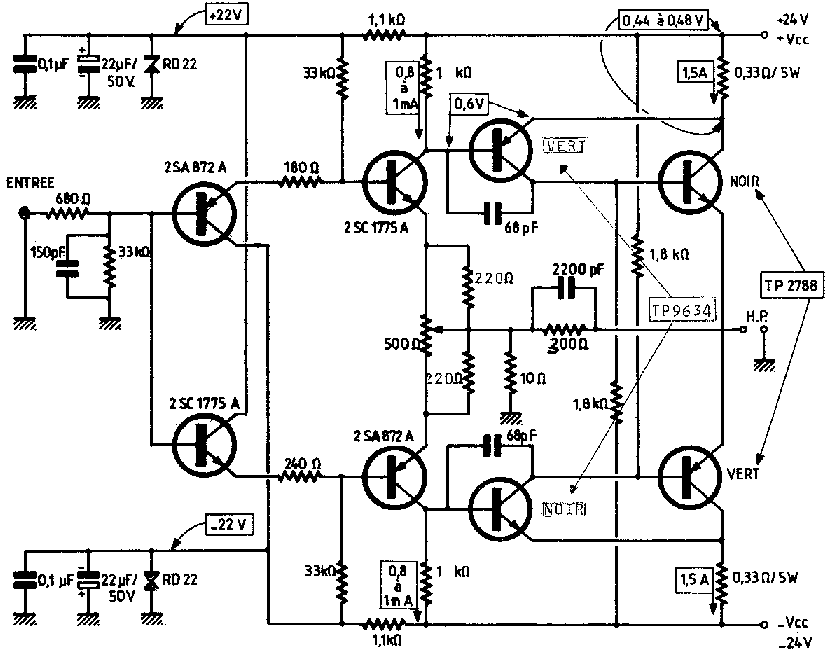

I'm not sure whether our American friends had an opportunity to see Hiraga's legendary little amp. Just in case I'm right, the schematic is attached. Note the simplicity and right down to business approach. I have heard tens and tens of version of it, and most sound from very good, to outstanding, low power notwithstading. King of the road is a guy who ran his from two 22,000 uF caps - per channel. :D
Wonder what the d.c. offset was? Rarely are PNP and NPN matched well enough, even when alleged to be complementary pairs, to have that current-mode input stage have low offset voltage.
