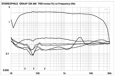

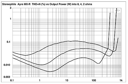

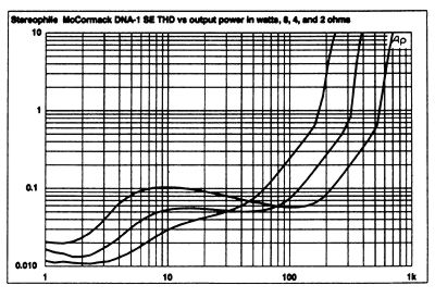

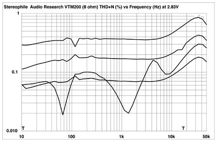

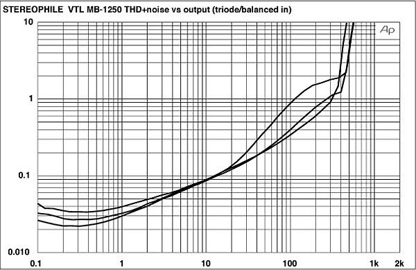

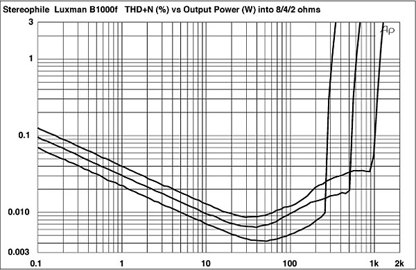

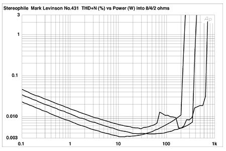

Courtesy of STphile , a few contenders ....
The Goldmund is so surprising as it is a very simple circuit ( an assumption as I may not know this specific circuit ) . I know those curves from others which are generically similar ( even the HH 1200 ) . Even people who work in PA wouldn't think of HH as anything special . I wonder with better speakers if it would shine ? I have never measured one so can only say is starts with what should get it there as a circuit

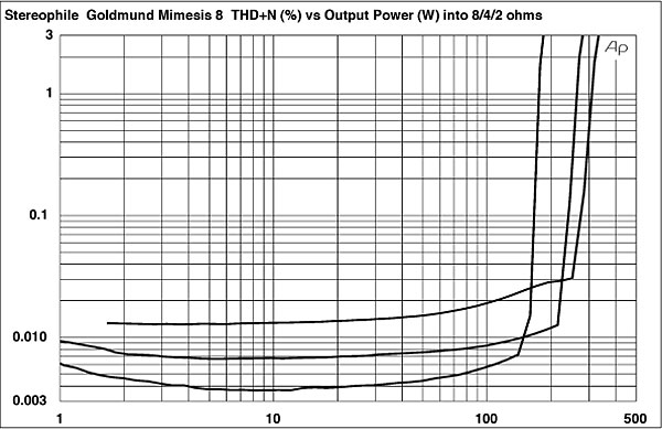

I can provide, too much to list for all of them , pick an eg from the list ....I like the Goldmund .
Not enough to judge. But some aspects, yes. Gooldmud and VTL both can be better than the rest pf amps. But can be worse. An amp with 140 dB open loop gain at 10 Hz can demonstrate nice THD/Power curves, but sound dirty.

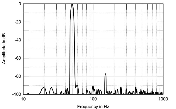

Fig.1 Goldmund Mimesis 8, spectrum of 50Hz sinewave, DC–1kHz, at 72W into 4 ohms.

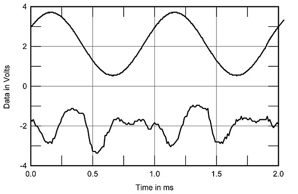

Fig.2 Goldmund Mimesis 8, 1kHz waveform at 100W into 8 ohms (top); distortion and noise waveform with fundamental notched out (bottom, not to scale), 0.007%.

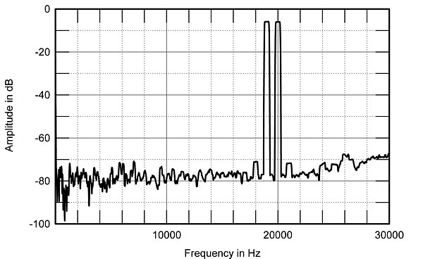

Fig.3 Goldmund Mimesis 8, HF intermodulation spectrum, DC–22kHz, 19+20kHz at 20V p–p into 4 ohms (linear frequency scale).
Fig.4 Goldmund Mimesis 8, distortion vs output power into (from bottom to top at 10W): 8 ohms, 4 ohms, and 2 ohms.
AX tech editor
Joined 2002
Relax I'm going to get you all the data you could ever use ... :)
Goldmund ...
That fig 3 is misleading as the difference freq falls exactly on the Y-axis line and cannot be seen clearly. It LOOKS like -45dB but that's just eyeballing it.
