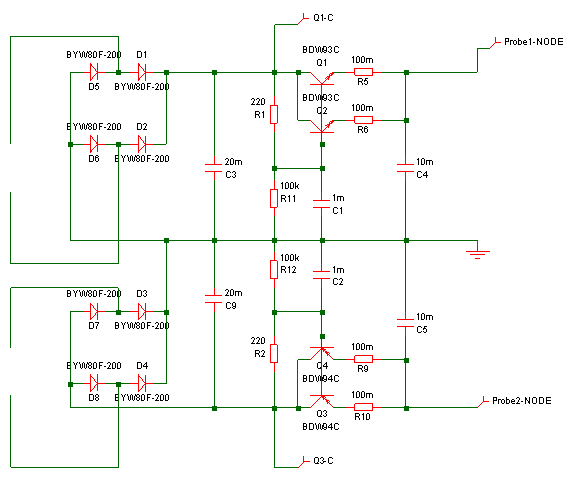

Examples ... Schematics ..?

A "capacitance multiplier" is simple enough that it's faster to describe than to draw the circuit. Uses an NPN for the positive rail and a complementary circuit with PNP for negative. Collector goes to the + of the main capacitor reservoir, emitter to the + power rail of the amplifier, and the rail current flows through this transistor. Put a resistive divider between the main capacitor's + and ground, with the junction going to the base. Resistors should be scaled for (supposing a 50V rail) setting the base at 48V, and low enough resistance to supply enough base current to insure the transistor's current gain (or lack thereof) doesn't drop the voltage at full volume. The capacitance multiplication comes from connecting a capacitor between the base and ground. The capacitance will effectively be multiplied by the beta of the transistor.Examples ... Schematics ..?
The bottom resistor of the divider might go better to the emitter rather than ground, and of course be a proportionately lower value. (thus R1 would be between collector and base, and R2 between base and emitter rather than between base and ground).
Basically, in a few short words, it's an emitter follower with the input (base) AC-coupled to ground.
The post from Benb explain it well , i will just add that a darlington
is to be used.

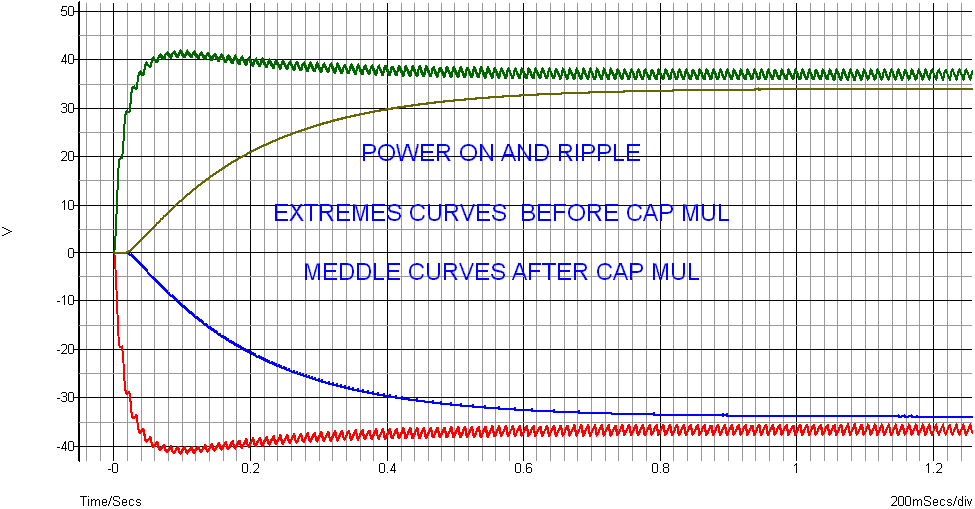

One of the advantage is inherent soft start....

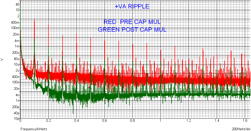

Here an exemple i simulated , with voltage unfiltered at the extremes
of the graph and the filtered voltages , of lower value of course , slightly
above/below .
The current is about 7 to 8A , we can clearly see the difference
in ripple level , as showed by a fourier analysis.
