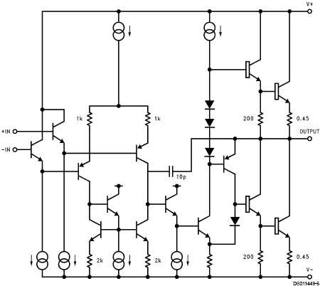

The Schematic I have shows them also in the linestage...

I had an amp like that (Audio Innovation Alto), except it had already expired. I ended up putting a "gainclone" inside, with caerfully chosen passive parts (Elna Silmic PSU Cap's, Allen Bradly Carbon Comp resistors and an Alps Blue Pot). It does quite well...
The only things I can see to recommend the topology of the Gainclone chip (which is really a generic Self blameless - see attached) is that thermal sensing of the output junctions is almost instant (much better than the "thermaltrack" transistors for example), that all BJT Bases are buffered by followers and that the output stage forms part of the miller loop and is fitted with high value emitter resistors, which means the handover between the halves will be better managed, IF the biasing is right, which is assured by chip design.
Otherwise there is really not much unusual there. I can also see easily why this chip reacts so strongly to power supply design (hint - it's the miller compensation loop), my one is CRC filtered, but well designed regulated PSU's do better...

Much thanks on specifics of the Rotel topology. The 5532 is the phono stage, so it's not involved at all.

I have this Aimor integrated that sounds like ****, so it would be real low risk to play with it. No schematic of course. I don't know if they painted over part numbers like some do, so drawing it out may not be too hard. Done worse. Good solid chassis, transformer and heat sinks, so that is most of the cost to do a DIY.

The 33K is there so the global feedback does not "open up" when the fuse blows. 33K seems excessive, a 1K value should be better, but let's not blow that fuse in the first place, shall we?
The schematic I have lacks these, but it has a 120 ohm resistor (mislabeled 120K) to the headphone sockets. I guess proofing service manual schematics was no Rotel's strong suit in these days.

Fishy schematic.
Not really.
It has a few things I had not seen. The fuse on the output is bypassed with a 33K resistor. I guess that is for safety, but have never seen it before. Global feedback is from post fuse through 43K.
Here is the odd part, I wonder if put in the drawing just to mess someone up. A 2.2K resistor in series with the output. Then followed by a .22 and the Zobel. I''ll have to pull it apart tosee what is really there.
