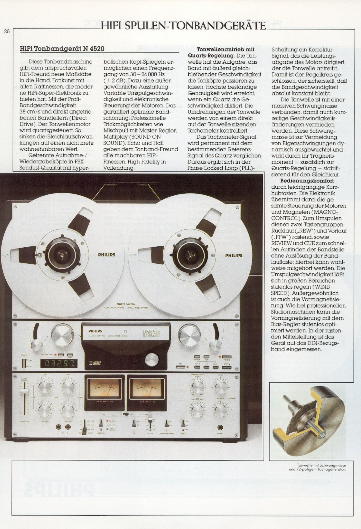

On 1st generation tapes:
I agree completely with John. In my time, I was almost shocked at what my home tape dec picked up, via its own mics in my room of a friend playing classical guitar. And at 7.5 ips. Agfa tape.
Playback produced a complete "being there" experience.
Some years later, in 1980, I repeated the experience, but this time on a better tape deck, a Philips N4520, capable of running at 15 ips, with NAB or IEC eq. Tape Maxell UD-XL II, properly biased, deck heads properly adjusted to reference tape and demagnetized.
That was even more stunning. The friend for whom I made those recordings went on to become one of the greatest local rock stars ever. We sat together in High School, graduating in 1971.
