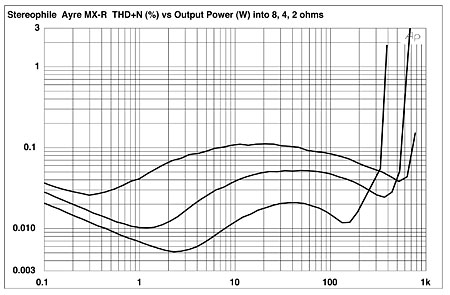

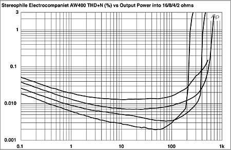

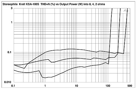

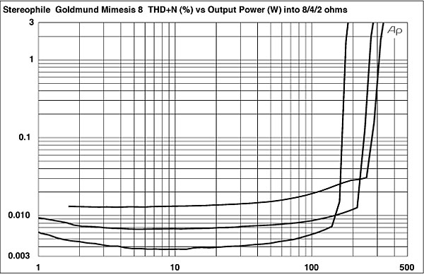

Whats the difference's here in relation to micro-watt distortion and that all important first watt ..... ?

Well a bit on topic is how to measure amplifier distortion below the noise floor. Although you can try and average out the noise, you might loose something. (I don't want to get into sampling theory and finite limits so a bit of simplification).
A better technique is to use two identical amplifiers and measure their outputs and then do a cross correlation. Now you can do lots of averages this way and get to what is actually the distortion or other artifacts common to the design and reduce the noise errors.
But then I am giving away secrets on another project!
