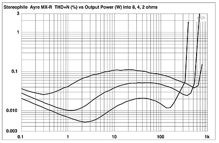

Was there ever a Cordell designed Amplifier made available to the public .......? The Ayre product ( as others ) has the same issue that we were discussing earlier, about high distortion in the mili-watt area, distortion starts high and then decreases before increasing again ...
EDIT: This is not to say it is a bad product, just a pointer to what was being discussed previously ..

I doubt that the distortion increases at low levels, as that is the Class A region, and the laws of engineering show that the distortion decreases with decreasing level in a Class A region of an amp. What you see is measurement noise residual.
Yes, we had originally thought such and there was a discussion on this earlier John and it was shown that the distortion on a lot of amps in the mill-watt area was very high, even full class-a amplfiers.
I will try and link this ...!!!
As to the graph posted on the Ayre, Distortion starts out higher then lower before rising again, are you saying below one Watt, what is being measured is Measurement noise residual ..?
This is that all important 1st watt ...

Although if an amplifier has a stable and smooth set of nonlinearities in the vicinity of zero signal, the net distortion should fall off predictably with decreasing level, it's not inconceivable that the concatenation of stages of some sort might have an overall signature, a curve-of-growth, that actually produces net distortion that is non-monotonic with level.
Also, another gotcha is to suppose that the measurement equipment itself has no problems at lower levels. If you've ever tried to make a really good true-rms converter, or even just a good low-level rectifier, you quickly come to appreciate the difficulties.
If given an amplifier with a claimed rise in low-level distortion, independent of the residual noise, it might be a good idea to use the traditional analyzers in conjunction with a careful nulling approach, and see if the results are in agreement.
It is impossible for a class A region to increase distortion at low levels.
To reassure yourself, look at the Ayre graph more carefully
It is SCALED to be read out in Watts. The voltage sensitivity therefore changes as to the rated load resistance. Note the noise increase with the scale magnification increases. In fact it should be approx. 3 dB per measurement, because it takes less volts out (and therefore in as well) to achieve 0.1W out, for example, with a lower resistance load.
Exactly. Thanks for saving me typing. :D
